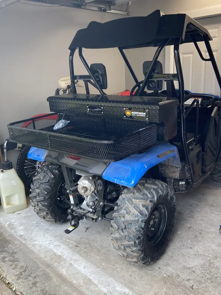

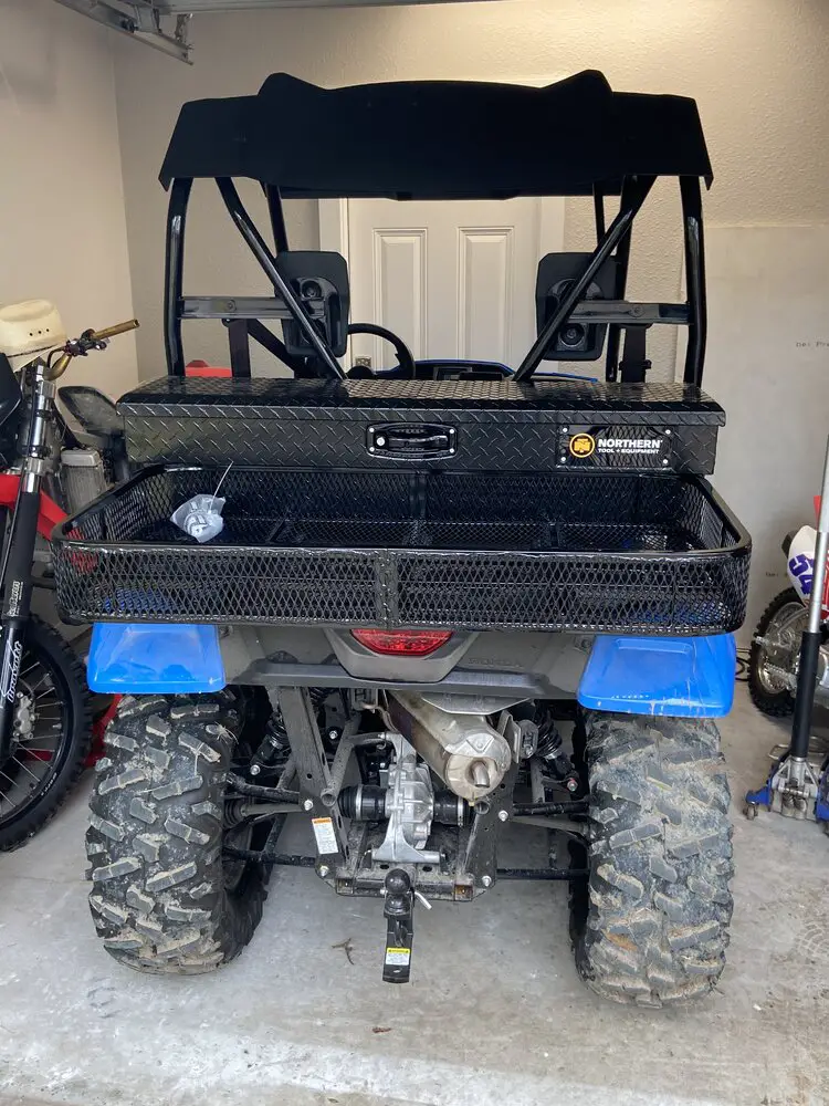

Looks great. How did you mount your box? Just looked and j hooks didn’t come with my northern box.
I purchased some ubolts for 1”pipe. Used two on each outside pipe.

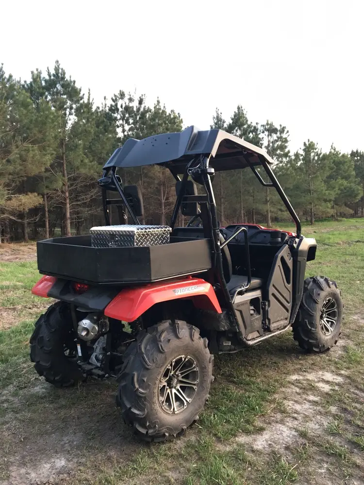

Just got the one I built, mounted today. Started (like many) with a Delta pickup side box and went from there. I used 1x2 aluminum channel scrap I had and 10ga aluminum sheet to complete the box. 1/4 and 3/16" pop riveted together. Ubolted it onto the rack. I plan on truck bed liner on the inside at a later date.

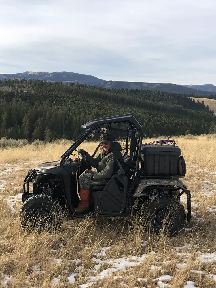

Homade box setup. Room for gun scabbard in front and in back of box. Box keeps things dry. Put little rack on top of box. Also have added large mudflaps to hang from rear bumper. Mud flaps keep down most of tire mud splatter.
Pioneer 500 3 2020 Honda Hunt2
