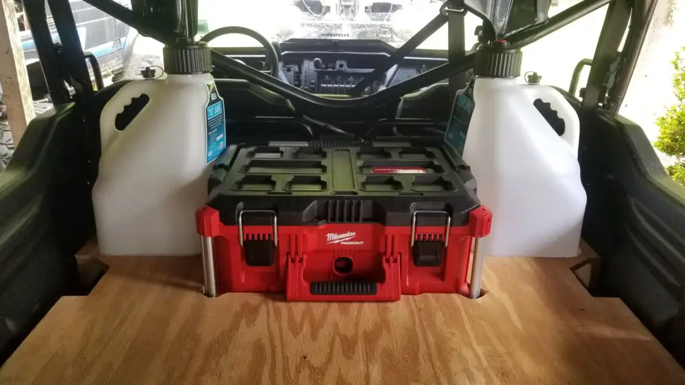

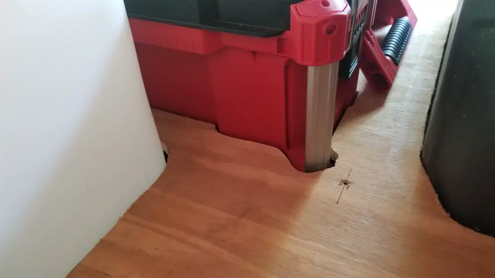

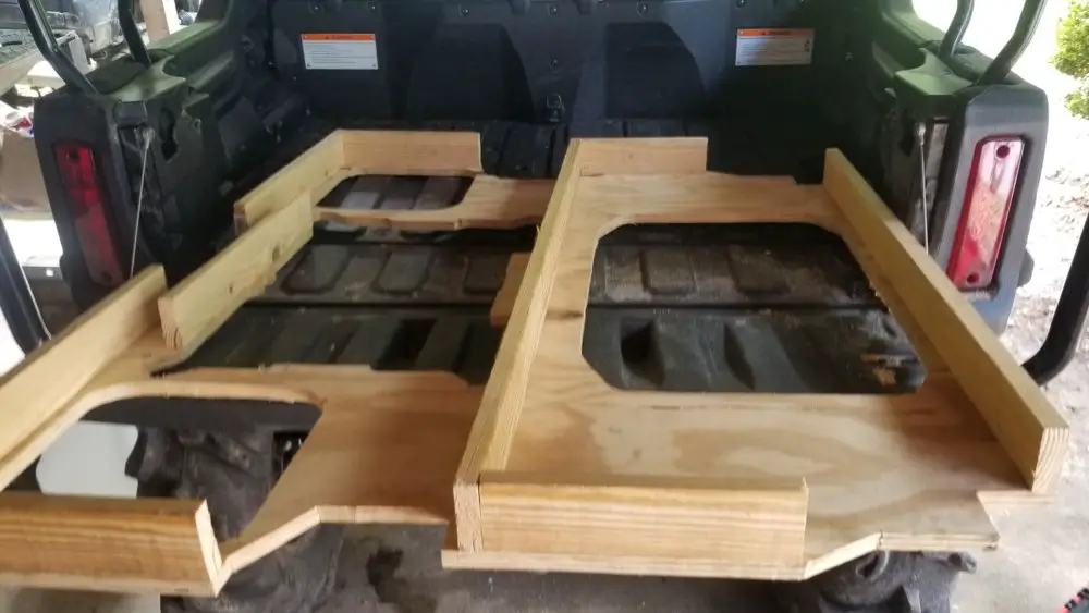

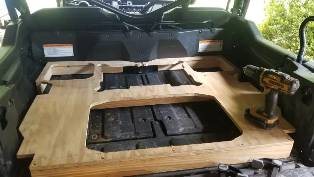

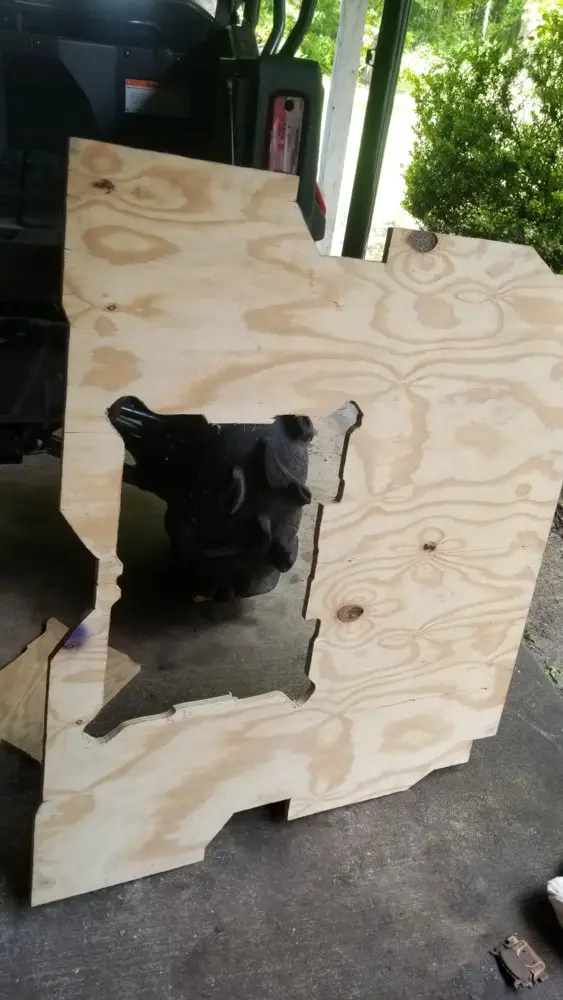

Ok folks, I got a little more done on the bed organizer. Placed everything just right and traced around everything, jigsawed the holes out and gave it a little light frame work underneath. Everything sinks down in like 3.5" deep. I just have to paint it and install the little eyelets to the sides of the boxes and stuff to strap, bungee, or use turnbuckles to keep everything in. Heres some pics. Mr. Wiggy the Wonder Piggy was no help at all. I'll update again later.

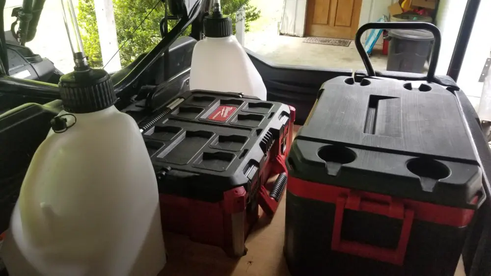

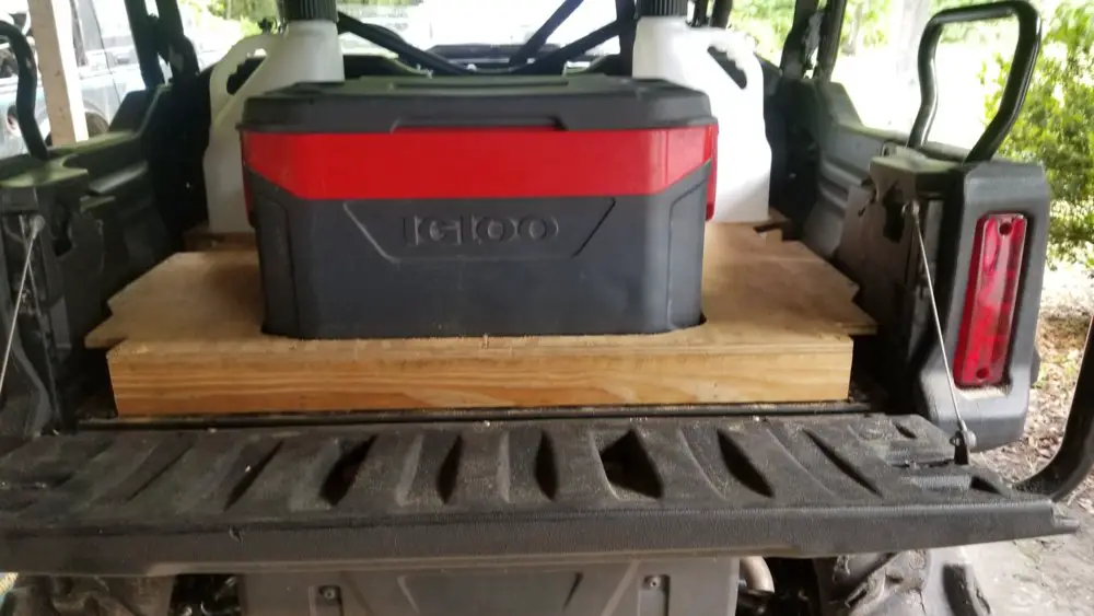

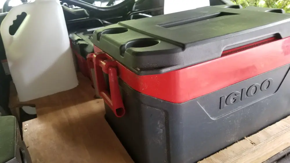

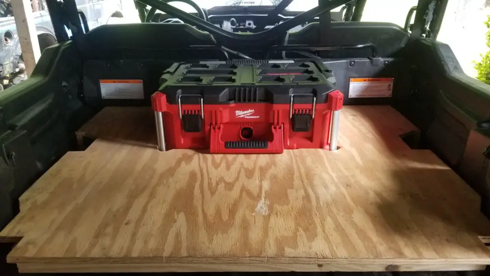

Ok latest update on Project: Ramen Noodles. I got the bed organizer done. All of my tools and stuff is packed for the trail. Got a 6 gallon can for water, and a 6 gallon can for gas. Im gonna fill each one about half way to save on weight. I think Im also gonna run a vent line out of the little breather hole on the gas can and run the vent line down the roll cage tubing to underneath the sxs where it can breath a little air to keep the can from swelling from gas fumes. Or maybe run it up high, who knows. You can see how I got some el'cheapo ratchet straps to hold the organizer down inside the bed, and also holding the cans down. I have another el'cheapo strap to run across the top of the Milwaukee pack out box from left to right and it will hook to eyelets on either side of the box. The cooler is held in by little baby turnbuckles. Ok, her sxs is done and ready for Takeover. I look forward to having a few frosty adult beverages with yall! :)
