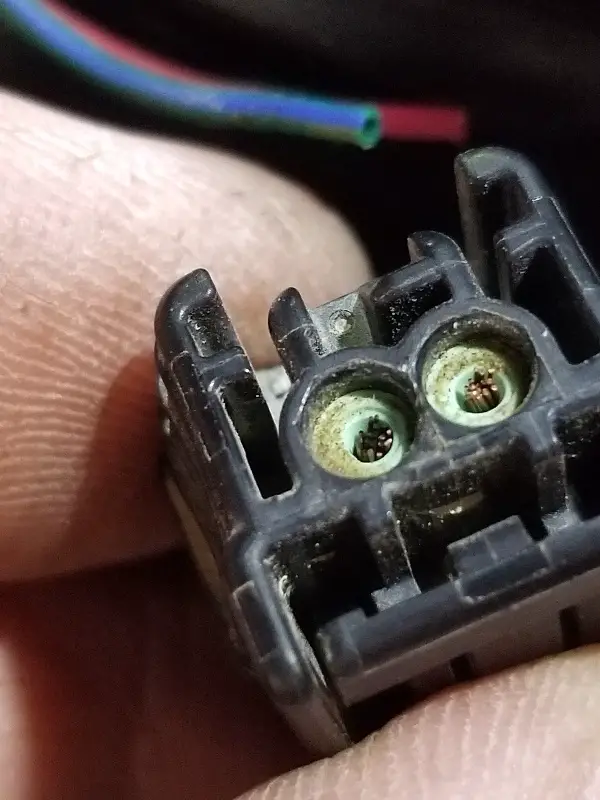

Had to come home yesterday. The Pioneer started shutting off. Would crank right back up. Noticed on the road ride back to the truck, it did not feel like it was running right.
Got to check the ground and the injector harness...
Reactions: TripleB
Superthrill
Oct 4, 2018
667
1,557
North Carolina
20200514 193309
Pulled the pins out, soldered wire back in, reninstalled pins. Added the liquid tape for some added vibration protection.
Just got to reassemble everything and ready to go!
