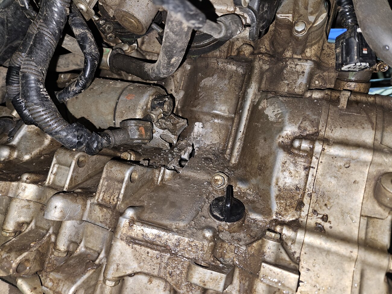

Well the way it broke away the starter mount and i don't have all the pieces, i reckon im probably down to simply shelling out the 1800 for new crank case.
H
HondaTech
Ok, whats the updated cases?? Well,see the pictures to know what i meant, when the rod came out the side it blew off some of the starter "bracket".

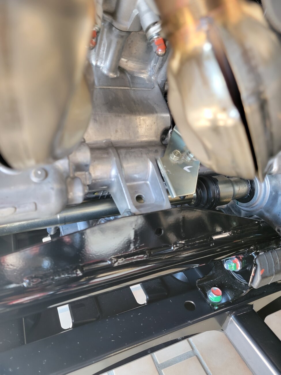

They added material to the engine case around the motor mounts due to cracking. They also added longer bolts with spacers on one side for some reason.
You can get the newer cases and not do the spacers, but id probably do both.
Here's the difference between the cases, thr top one is the updated version.
Here's the difference between the cases, thr top one is the updated version. View attachment 386588perfectView attachment 386589

I bought it sight unseen on an online auction as a repo unit with "Right rear damage", turns out they threw a couple handfuls of gravel over the hole in the crankcase, so that a fellow couldn't see the REAL damage
The seller hid the engine damage. I can see why it was a repo Talon. Parts and labor may cost $10,000. The seller should refund at least half of the payment.

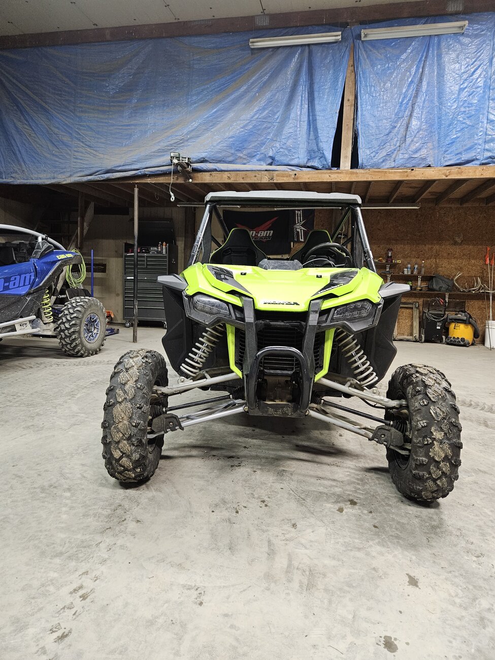

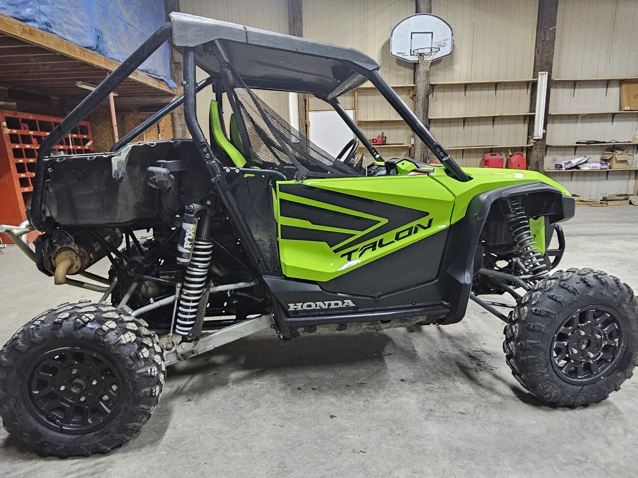

Well guys, pardon the ignorance for buying such a project but I bought it sight unseen on an online auction as a repo unit with "Right rear damage", turns out they threw a couple handfuls of gravel over the hole in the crankcase, so that a fellow couldn't see the REAL damage, so long story short, its going to need to be rebuilt. I've never done any in-depth engine work (put lower gearing in my YXZ and some things like that but never engine work) but with a little common sense, and some oversight by my uncle @GPR1500SC we can get this ready to play. Although probably not in time for takeover! So this definitely will be an interesting project for me, probably plenty interesting... 😬
View attachment 386529 View attachment 386530 View attachment 386532
You might be money and time ahead by just buying a full crate engine from Honda. Now that they have 3yrs worth sitting in shipping containers and no chassis to put them in should be easy to get ahold of.
