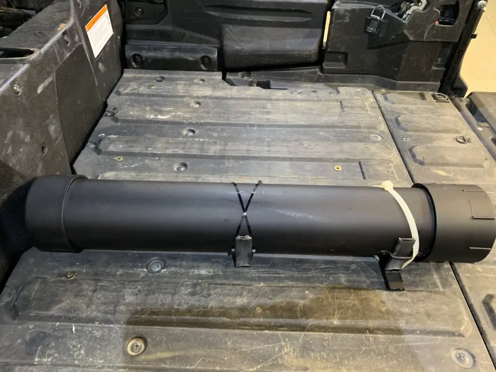

Added a way to carry a spare axle and keep
It from bouncing around in the bed getting covered in mud and dirt. It’s 2 bolts into factory locations and zip ties. It will fit with my Ridgid boxes mounted.
Hold a front axle perfectly, 4” cap, 24” precut section of 4” pipe, and a cleanout on the other end. Bent a couple of pieces of flatbar and used a strap loop to keep it from moving forward and back. The axle JUST fits inside so it won’t shift either and I wrapped the axle boots on paper towels, to keep them from rubbing.
Nice - what PVC did you use? Had used sch 40 but would like to do something lighter. Also pool noodles work good to protect the spines Extra axle storage options
I need to build a couple more
I missed that great minds think alike.
The precut pieces in HomeDepot not pressure rated.

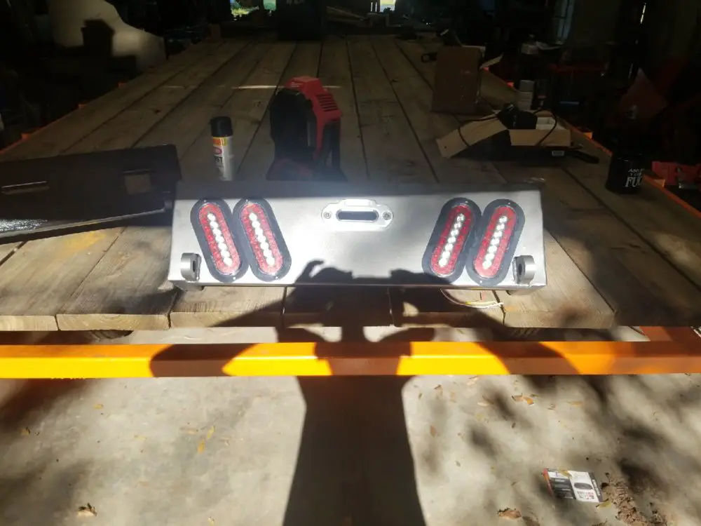

Where can I find more pics or info on the rear winch mount bumper? Does he have any pics or info on buying them?
is a steel built bumper that can hold up to a 5k winch on a 5 seater it bolts behind the rear cage tubes and and has 2 arms that go to the sides of the frame rails you would have to drill 2 holes in your frame it comes with 2 3/4 in clevis mounts and 2 5 in flush mount pod lights pm me for pricing you can text me with any questions also 321-231-2662
That would be schedule 40 cellular or foam core drain pipe. Used for drain applications only. They should also have standard pressure rated PVC pipe as well.
It said but I painted over it and don’t remember.
Whole thing was about $25 between fittings and pipe.
