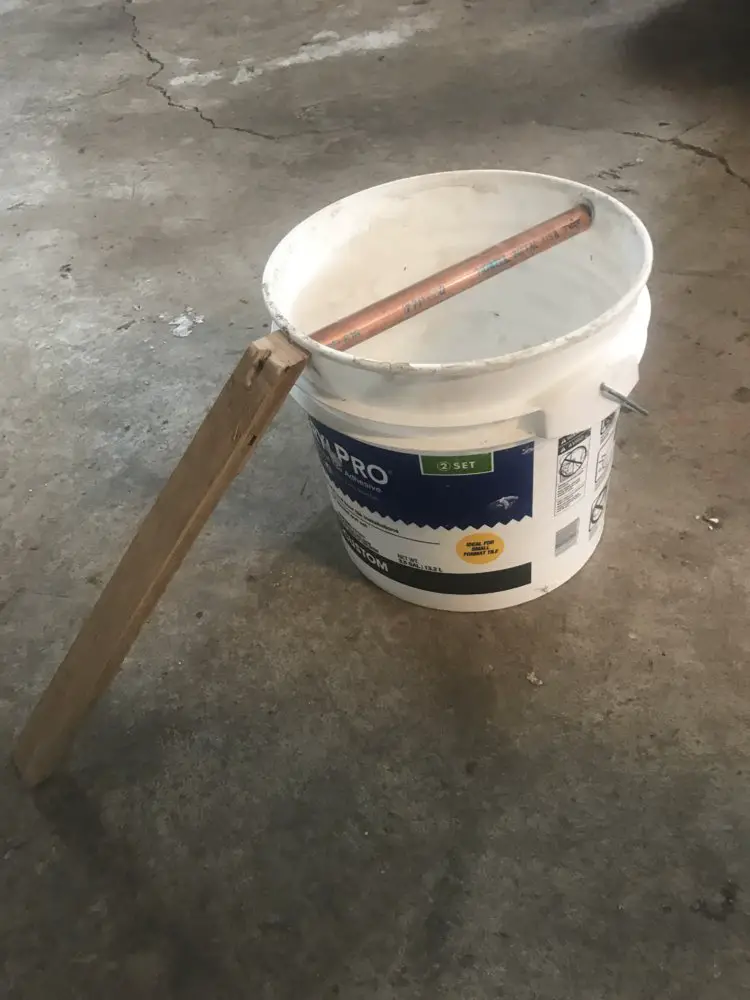

I just made this using 3/8” all thread, nuts, washers, 1/2” copper tube inside of 3/4” copper tube and wood for the ramp. I don’t have mice eating my wires, but they do occasionally get into my house. I set traps normally, tonight I’m trying this.

Looks good!
How easy does the tube roll?
For it to work it needs to roll very very easily.

I put the 1/2”inside the 3/4” and then the all thread. Reamed the ends and put washers on the end. It rolls very easy. I drilled the ramp so it sits on the end of the all thread tight. I’m gonna set it up tonight, I’ll let you know the results.

I'm impressed, type L copper! HA!

Throw some anti-freeze in the bucket and a drop of soap to keep them from smelling.

What solution would you use? All propylene glycol with a few tablespoons of dish soap?
Water is usually fine, but these temps...... Might not drown them!
Just use a couple inches of antifreeze. Even RV stuff that is $3 a gallon will be fine. The soap just helps the surface tension and makes it slippery.
