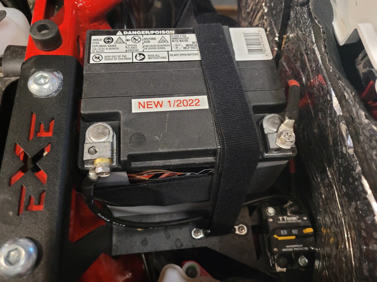

I went with a DAKA ETX30A Fits nicely on the EXE battery tray I have. Battery cables can be on top or on the side of the battery which helped out.
Thats a nice set up. I think that tray is the same size as mine i believe?
do u know that Batt Dimensions off hand?

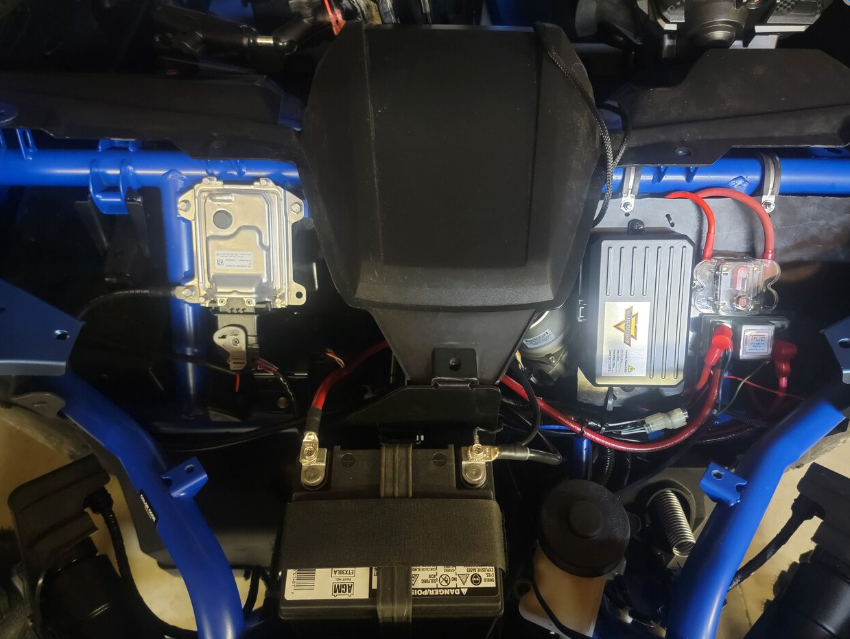

I made my battery tray myself, it's very similar to the AJK one but wider. I bought two of these batteries off Amazon and have one in the P1KD and in the Talon. I love them so far, especially in the Pioneer (I wish that would have been the first upgrade I did when I bought, hindsight eh?)

My aux battery solution -

Not a bad Idea. Thanks Scoopy
It is connected to the NOCO charger solution idea I stole from you ... 😄
That thicker Velcro cinch strap I have on there came in a 4 pack. I can bring one for you @ TO if you want (and if I can remember).
