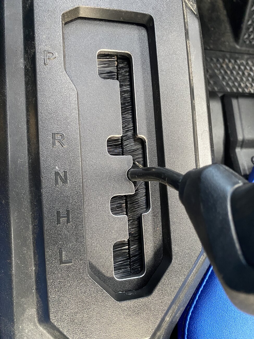

Chiming in here only because I do make a different shifter plate for the Talon, in several OEM colors.
Specs can be found here:
Back in '21 this was the first product I ever designed from scratch. I liked having the notches but the OEM shifter plate was complete garbage, requiring you to look at what you were doing. I've been running this on my '19 since then. In July I bought a '23 X4 and drove it about 2 days with the OEM shifter plate and that was miserable. I had to put my shifter plate in there.
Cable adjustment is key to these transmissions shifter well no matter what shifter plate you go with. Both of my Talons were out of spec from the factory!
IMG 3088
I've also been working on this brush seal design for months! I finally have a design that works well and am currently test running these on 3 Talons. The brushes do an EXCELLENT job of stopping air passage even at road speed. Right now this only works with my shifter plate. A version for the OEM shifter plate is in the works.
IMG 3148
Reactions: trigger and JayPo
Thanks for the info highpocket74.
Your handle is all over this forum and that's a good thing. Have to admire the entrepreneur mindset you possess.
I also like the concept of your revamped shift gate in that it still takes advantage of the port side spring load on the shifter. Add the walrus whiskers and you've just removed the need to apply the CJ transfer case boot HACK - smart.
