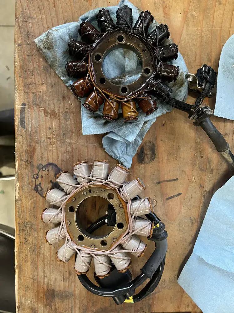

starting is yet inconsistent, so I bought another 700 to use while I straighten this one out. It’s a year newer and almost identical. Some interesting things. I believe I was getting fuel, so I starting messing with electrical. The spark pattern is still wacky — hit and miss. For comparison, I pulled the plugs on the new one and placed them on the block. Very quick at first, then settled into a stable rhythm. The other older Sxs does not do the same. I swapped Ignition coils and the old coil worked in the new bike but the new coil did not get the old bike started. Swapped the main electrical unit under the seats. same result. not sure what else to do so I pulled the cover off the back of the motor to get to the stator coil. Oil came out when i removed the cover — I didn’t expect this. The ones I’ve done in the past were dry — though I’ve only ever seen 2 others - Suzuki and a Yamaha. Anyone in the know have a comment on this? I do see that the area is open to the crank case so I guess perhaps that’s ok. I attached a link to a video I took of it. The stator looks room, almost half burned up. Anyone know if this looks normal or not. Hate to invest in a coil if I don’t have to. Any way to bench test these?

That stator looks cooked to me. Yamaha recalled the WR250 because of stators cooking themselves, mine only had a few thousand miles on it and the mechanic said it was visually cooked, much yours I'd imagine (never saw mine). My single cylinder motorcycle has 3 leads the same color coming out of the stator and two others for the pulse coil. Those 3 leads should ohm the same resistance.
I really think your stator is fried but I don't know that for a fact. Try the ohms thing, if they're reading wildly different, you've found your problem.

And...replaced the stator, she starts and runs like a top!!!! Because my brother jumped in to pull it apart and throw in the new part with me, I did not record the event with pics. If it hasnt already been posted, I’d be happy to walk anyone through the details. It truly is a bolt-on process. The only annoying part was carefully scraping off the old gasket with a razor blade. I typically use only Honda branded everything, but I’ll admit I did use the Permatex gasket maker (black-made to be in contact with oil), instead of the TB1215 described in the book. Torqued all per spec. My only disappointment was the lack of a spec for the bolts on the alternator (stator) cover. Including a pic of both stators.

I think you're the 2nd person who had wires starting issues from a burned stator. The crank position sensor is built into it, as you probably know. Glad you got it!
