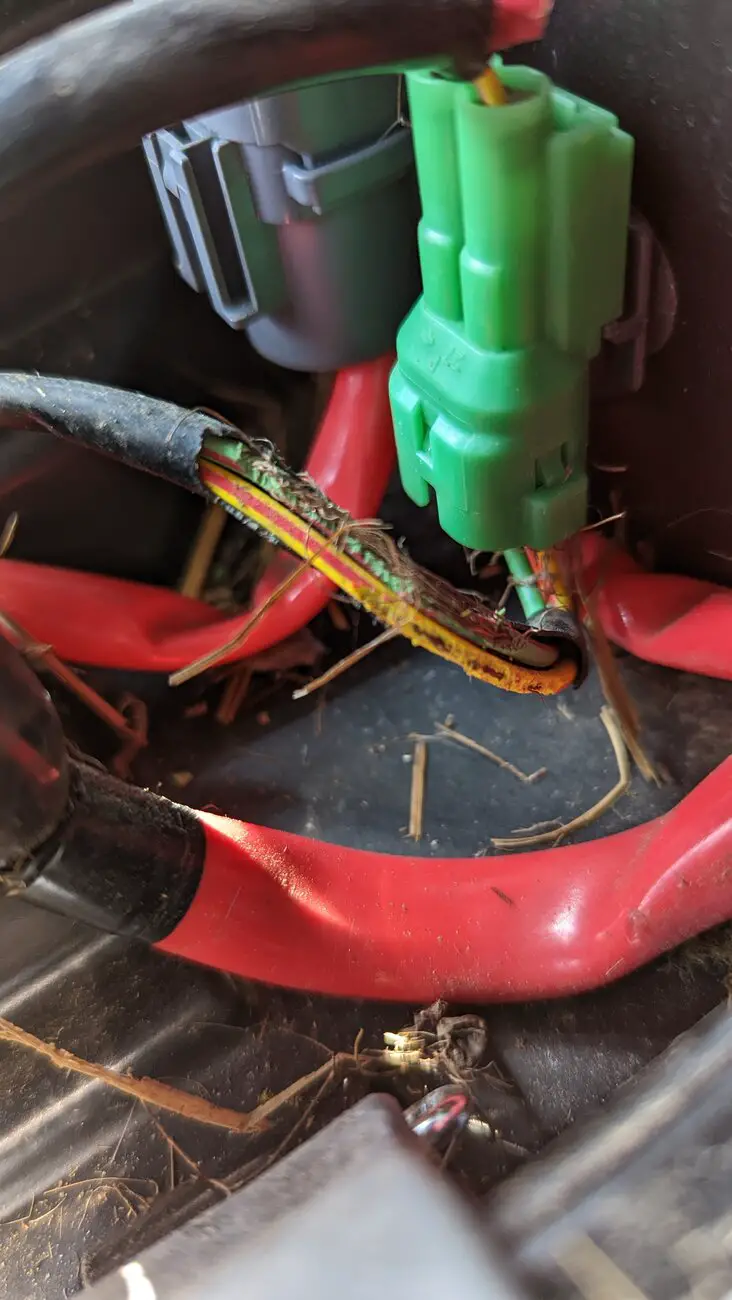

Well, I think I found the culprit — I opened up the battery compartment to give it a test for charge (Even though it's only 10-12 months old) and noticed a frayed wire. God damn, mice!
This is to the starter solenoid it looks like, so I suppose I just need to buy a new one and might as well upgrade the battery at the same time...any recommendations?

Looks like the work of mice. Seen bite marks like that on plug wires on a car in my garage.

The battery and solenoid are fine.
You found, and fixed the problem.
