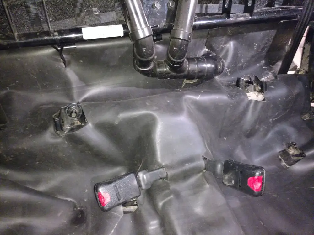

View attachment 49463 I can attest that rubber works better for noise and heat than the foiled carpet mat. This is EPDM rubber roofing material. Thin and conforms easier.

Yes and I like it better than the carpet mat I had in there. First time I power washed it I noticed that I had a couple of little puddles under the seats, where the rubber drooped down. I cut a couple of small holes so they would drain out and it hasn't been a problem since. I never have to take it out other than for maintenance or mods.

That's it. I build commercial buildings and got it from my roofer. Lays pretty flat, easily cleaned and durable as hell. Here it is installed.
