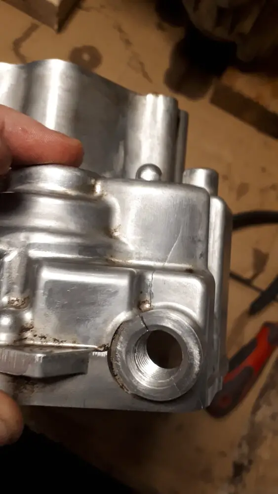

P1000 Sub Transmission Oil Plug Cracked Casing

New bearings can’t be that expensive, I’d put in new bearings and get that case fixed for a spare.

I will certainly look around! Here is an image of the broken case for any curious minds...

Moral of the Story! Don't use a torque wrench when installing a Steel ,Titanium or other foreign bolt, screw , plug into a aluminum drain hole! Just get it wrist tight and a little bump on the wrench to finish, check for leak after getting hot
Agreed!
Back in 2007 I bought the brand new 420 rancher. First oil change looked at torque spec Honda gave and raised my eyebrows. No way I was going that tight.
The problem is mother Honda gives a torque spec for this bolt that some believe to be way too tight including me.
