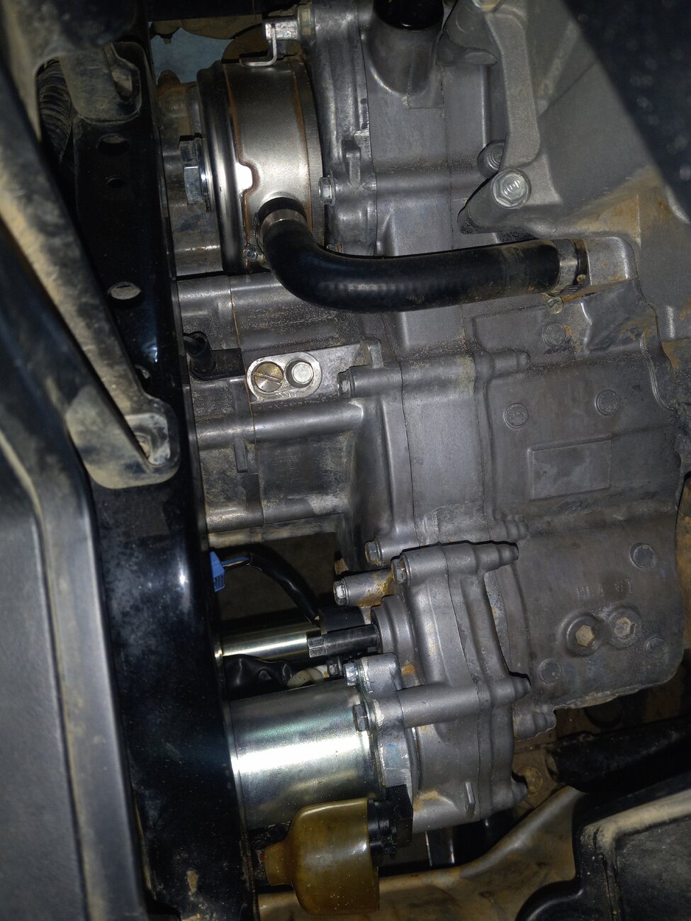

O ok right on, I gotta figure out if this machine had that update hopefully tommrow after work, between work an kids football practice freaking busy
It is a quick visual inspection. Post #9 in this thread shows what you are looking for.

If it goes into 1st gear and no movement - the one item is the clutches need to be checked
hi - so if you manually shift it into second- you can drive it down the road and all is good?
if you are in 1st or 3rd - does it just rev up?
or if you manually shift it and lift it up - the wheels turn very slowly - in what gear?
as posted above - there are 2 clutch packs in the beast - generally 1/3/5/R goes first if it is the clutch pack
I cant keep up and am very binary, its either yes or no - lol
I did not, had a busy evening after work, What exactly is the issue with the "clutch cover"?
the updated clutch cover put more cooled oil into the clutch area to cool it down to Prevent overheating and smoking the clutch packs
If wheels are turning , sub transmission is probably all right - just a clutch pack is bad - probably need to go inside to inspect

So there is no bump saying it has the updated clutch cover
Your best option is to then buy the updated cover and both clutch packs, the new cover provides much more oil to keep the clutches from overheating. It can be tricky on reassembly on ensuring no O rings get pinched or out of place, this comes from multiple people who have experienced that having issues after reassembly.
