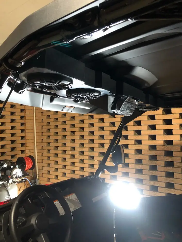

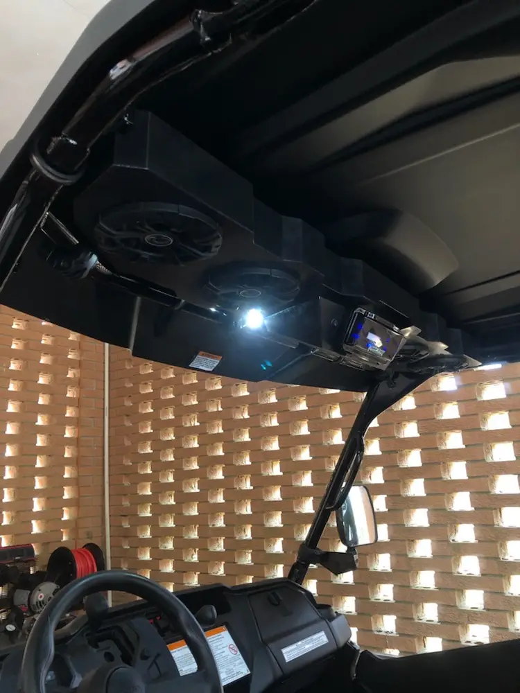

Here's a few pics of my install from last week. Sorry, not the best view of the mounting brackets but I had these pics handy. I don't have my glass windshield installed yet but it all ended up fitting pretty good with the hard top. Mine came with 4 spacers for the brackets. I used 3 of them. I did have to lift up the top to install & it was a little tricky getting the clamps back on after the stereo was installed. This is my 2nd 1000 & 2nd Swamp Donkey install. I remember using all 4 brackets on the ends of the stereo on the first one. Worked fine. Hope this helps.

Thanks for the pics and info. Yes mine came with the same clamps and spacers. The only issue is with the Honda glass windshield if you want to be able to use the flip clamps the unit needs to be back about 2 inches from the front tube to allow the flip clamps enough space. The roof clamps are fine. I think i am going to have to use a piece of angle and mount thru the roof. Looking good and I did test the unit and sounds great to me.
