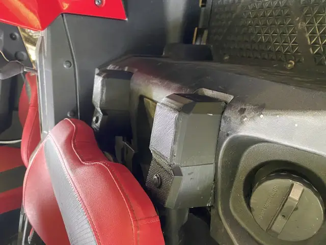

First round of replacement plastic covers for passenger seat.
020C7499 9F8D 4353 B043 79349933E5B7
Low quality print to speed up the process. We have a few dimensional tweaks to make along with a filament material change. Probably one more round of low quality for fit test and once that’s good we’ll work out the print quality. All things take FOREVER to print but injection molded pieces are NOT in the budget! These will work just fine.

Test fit went 50% correct. The plastic rivet holes line up better. Each person may have to adjust seat positions since the seat mounting holes are larger than the bolts.
The front of the new plastic cover is a shade narrower than the OEM one and I broke 2 last night testing the fit. Once I figured out the problem, I reported them to my buddy that's making these. He will make the corrections, test another one and once verified we should be good to go. Each cover takes 10.5 hours to print!!! We are using ASA filament for these since it's more UV resistant. It actually has many benefits over PLA or ABS that make it a better material for this application.

We got the plastic cover nailed down! Fit is perfect! Seemingly minuscule tweaks make the biggest differences. Getting the fit perfect is what I’m into.
Printing will resume at full tilt. That’s 1-2 per day!!😬
