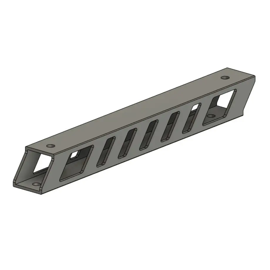

By popular request I have received from customers, I'm working on a 4 seat specific set of driver seat riser rails.
Talon X4 driver seat riser rails metric v22
The 4 seat Talon has limitations behind the front seats with frame members so the 2 seat rails will not work without modifications. I've successfully modified a few of the X2 rails from customer input to fit the X4. This cad model view shows the new X4 version with specifications of:
  • Raises the seat 40mm (1.5")
  • Moves the seat back 23mm, the max allowable
  • Will be boxed aluminum construction like X2 rails
My local sheet metal shop is making a steel set to test fit. Once verified, I'll role out some aluminum pieces.

I’m curious to the modifications. On the ones I just installed on my x4 i simply cut a steeper angle on the rear section with my sawzall.
I incorporated shortening the rails as you did into the X4 version. Since the X4 can't be moved 40mm back, I relocated the holes at 23mm, 3mm further back than the front holes on the X2 version, which should be the max that the seat can moved back, based on feedback and pictures from customers. I'll post some comparison model shots. Minor changes for a custom fit. I'd rather have parts that fit each machine perfectly than a universal fit that is not perfect on either machine.
I’ll take some photos of what I did when I get home. I used the 40mm holes no problem. The latch is tight and the seat back is firmly back on the tube but I don’t care.
