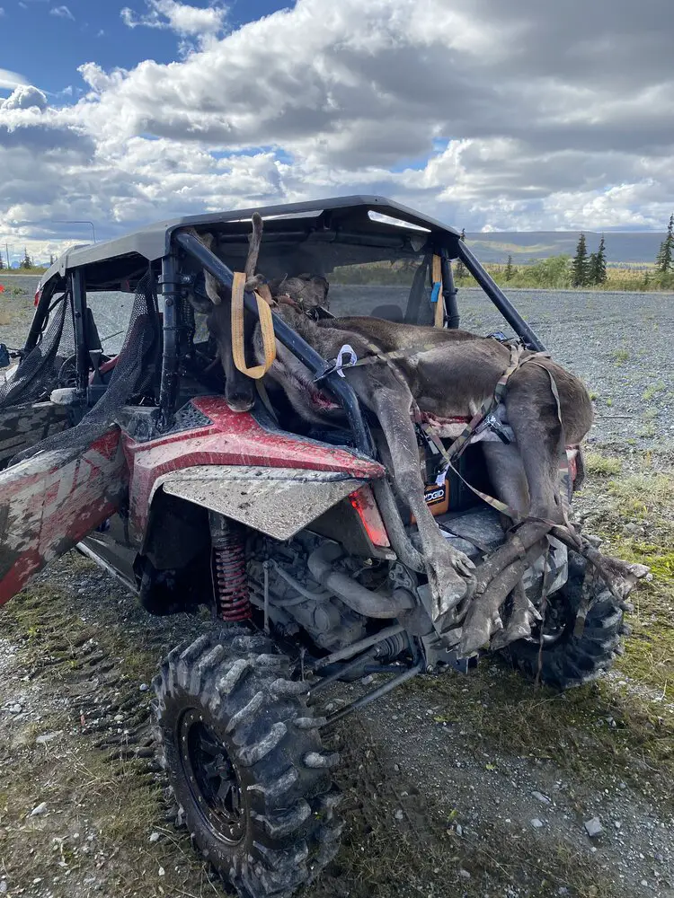

Definitely a great upgrade.
I put 40 miles on Friday and another 30 today.
Fast Rough rocky trail and bumpy tundra.
One handed driving no problem.
Hauled out 2 caribou also.

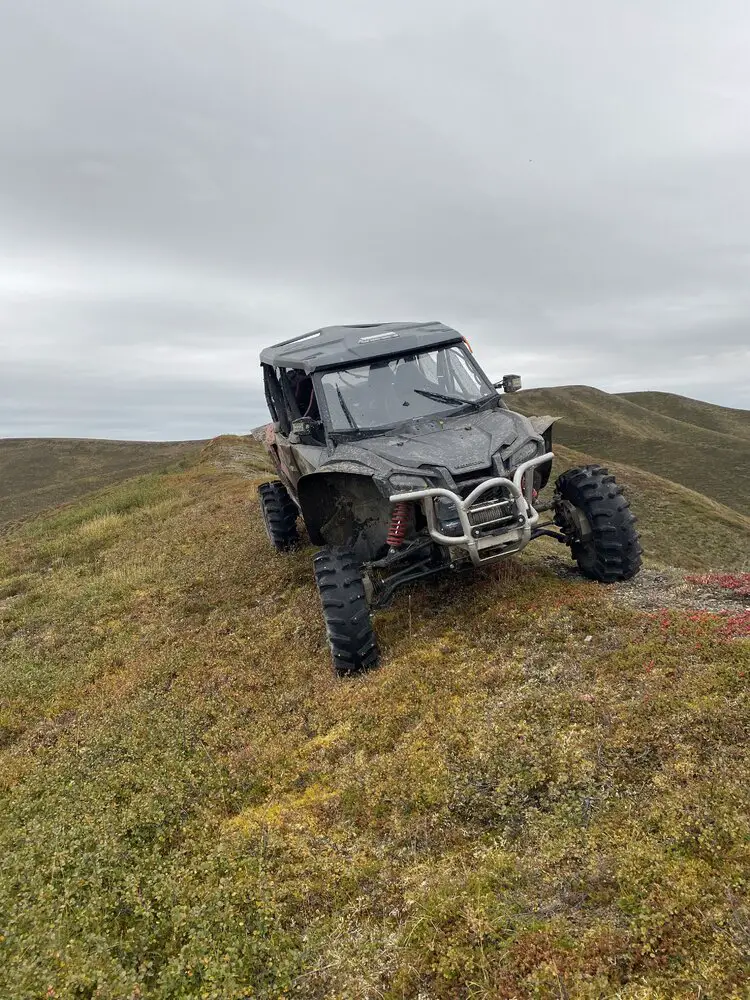

An update after removing the 1” spacers and going to 1/8” washers on each wheel stud.
Huge improvement in handling.
I can run the whoops on the rev limiter again!
57 mph on gps with the raised rev limiter tune.
Much happier with the portals overall now.
I think it would be fine with the stock power steering motor now.
Put 55 miles on last night running it hard and didn’t get any steering hit surprises.
