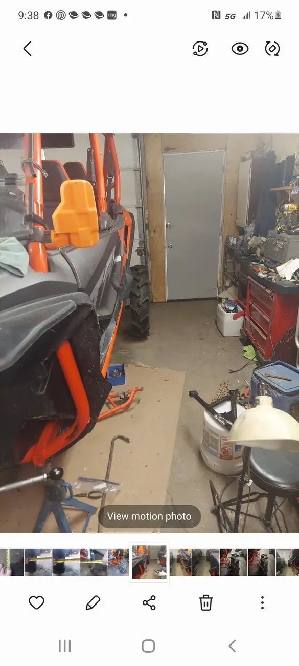

Did anyone ask him if both rear wheels were toed out or just the drivers side? I couldn't get his pictures to load.

I have a 2020 talon1000x4 and recently noticed that the back wheels were kicked out in the front. Have heard it is possibly a blown shock. Anyone have this issue
Can you post a picture of the passenger side rear wheel, is it towed out as well?

He never said and no one asked. His single picture only shows the RR tire.
It is slightly
I believe it is but not as much as rr.

I have not. Just have the back ones on. Working on the front ones this week. View attachment 311817
Although I don't believe it has anything to do with the Portals as it was toed before I even started installing portals. When I was installing them I had a hard time getting the radius arms to line back up to reinstall. The left side radius arms went right on, no problem

Not sure why the photo isn't showing up. O attached it to the reply
Me either, so tell me the right & left side look the same or is it just the left side.
