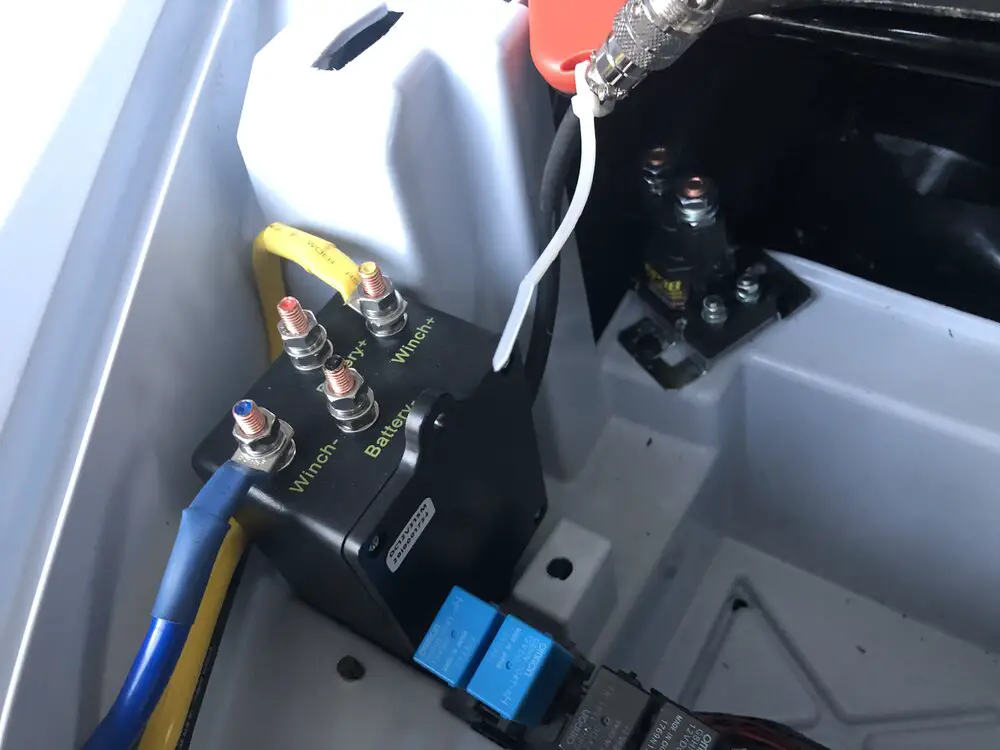

Installed the winch and only ran the blue and yellow wires, will wait to wire it all up once my battery shows up. Also removed the hondasxs front light bar from the stock bumper, just to remount it on the LE front bumper. Also took the time to adjust the rear diff, it was slightly out of adjustment.
Not sure on the placement of the winch solenoid but it fits super tight in the spot it’s in and doesn’t interfere with the hood. Also not sure about the light bar placement but I don’t want to put it below the top bar and didnt really like it above it but might remount it and see what I think.

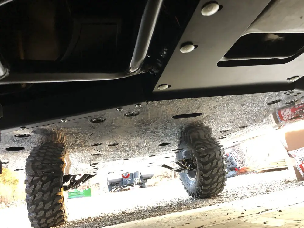

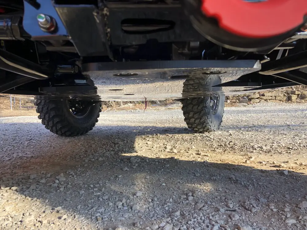

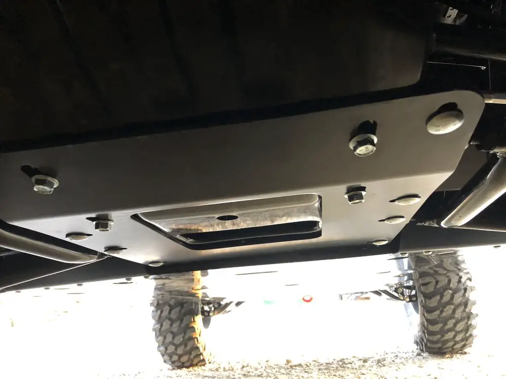

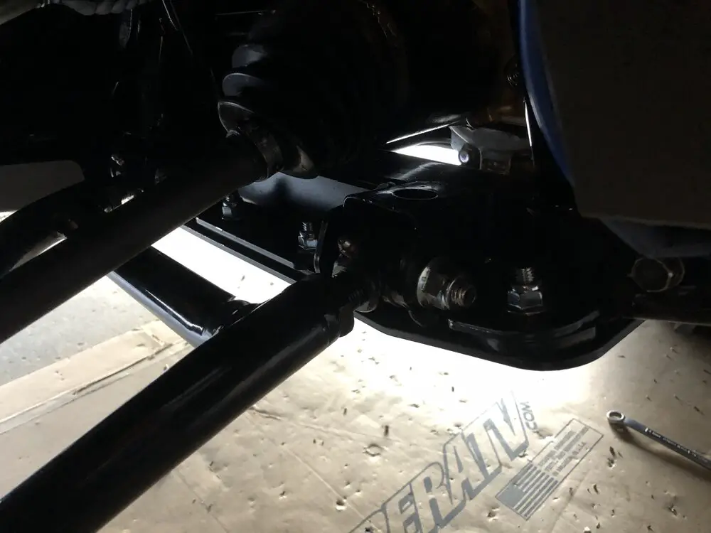

Skipped fooseball and instead went to installing the SATV skid plate and frame stiffener. I was wondering if the skid plate would be a pia if I didn’t put my utv on its side, naw it’s not bad at all to crawl under and just hold up as you go. Might help that the SATV skid plate comes in 4 pieces.

Does the skid completely cover the frame stiffener?
It would, you have to cut that part off if using the frame stiffener. I had asked them before hand and that was what they said to do, now I think if you really wanted it you could mount it without removing but really I saw no need with the stiffener on, it is very stout and protective.

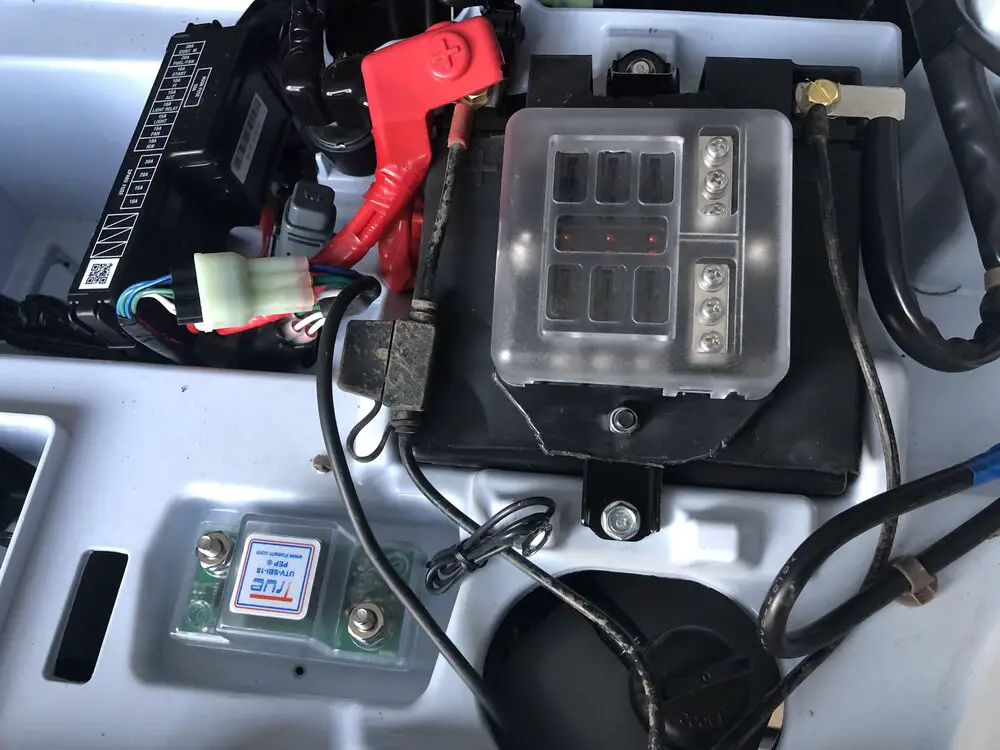

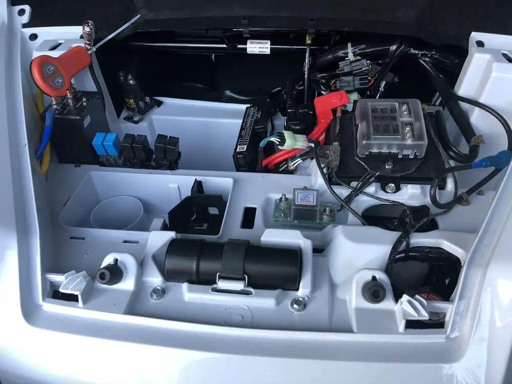

Started on the second battery and placing everything. I think these spots will allow for a clean look and are the common areas most mount them, stole @Russ989 idea on the fuse box mounting area, used the plastic I cut out of the rear door for storage for it.
View attachment 243690View attachment 243691View attachment 243692
That's where I mounted the fuse panel, I was a little concerned about battery replacement, I routed the wires where I had some slack and secured with zip ties, when I replaced the battery, cut a couple zip ties and flopped it outta the way. Looks good!
Reactions: EMAW and tdhanses
That’s exactly what I was thinking I would do.

Was able to get a little more wiring done today, true isolator is working perfect, stays lit blue for maybe a min max then you can hear it click off. I did a test fit of the air box, it still fits without issue.
Winch and Fuse box are wired off the stinger, this ok? I also wired the factory winch ground to a common bussbar. I’m going to prewire the battery tonight so it’s easy to just connect it once I’m ready. Think I’ll do the switch plate next and need to wire in the fan override plus waiting for the backup light override.
Let me know if you guys see any issues with it so far.
