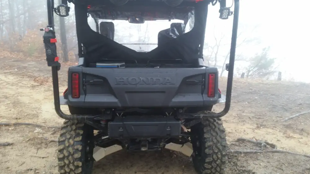

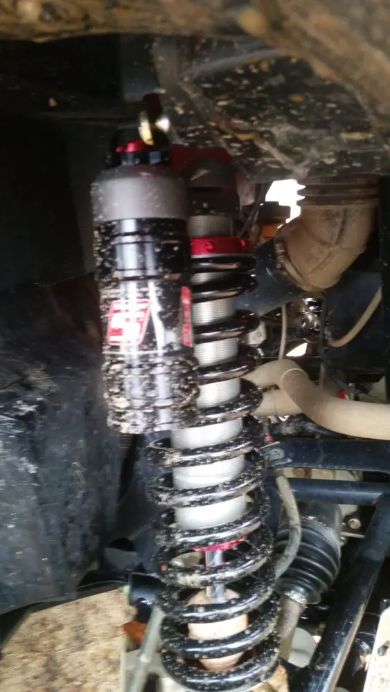

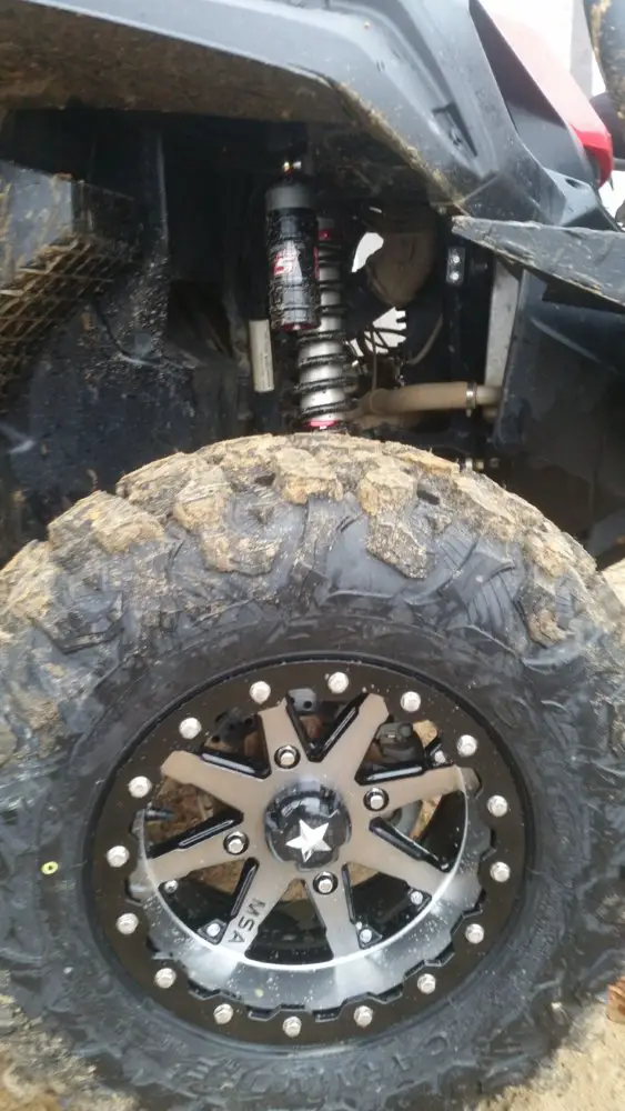

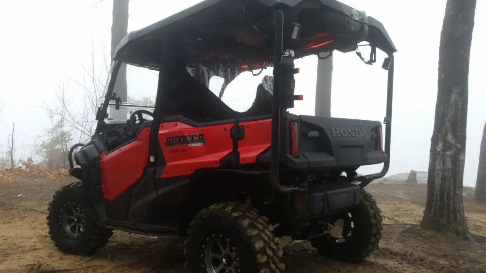

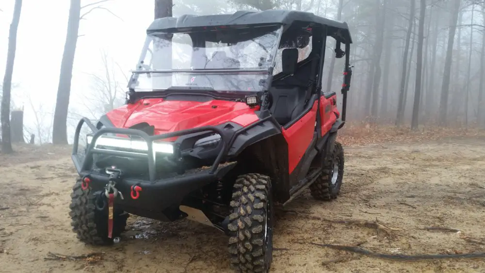

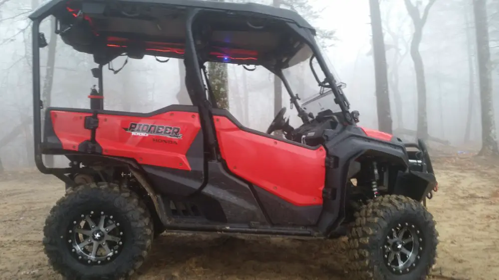

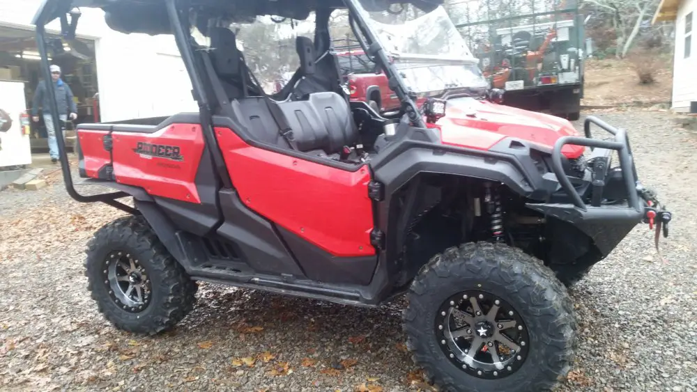

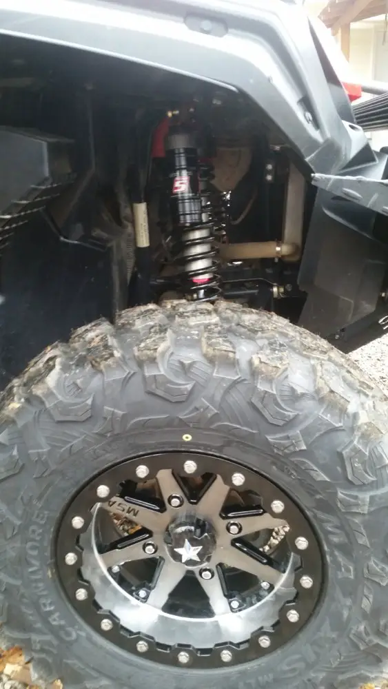

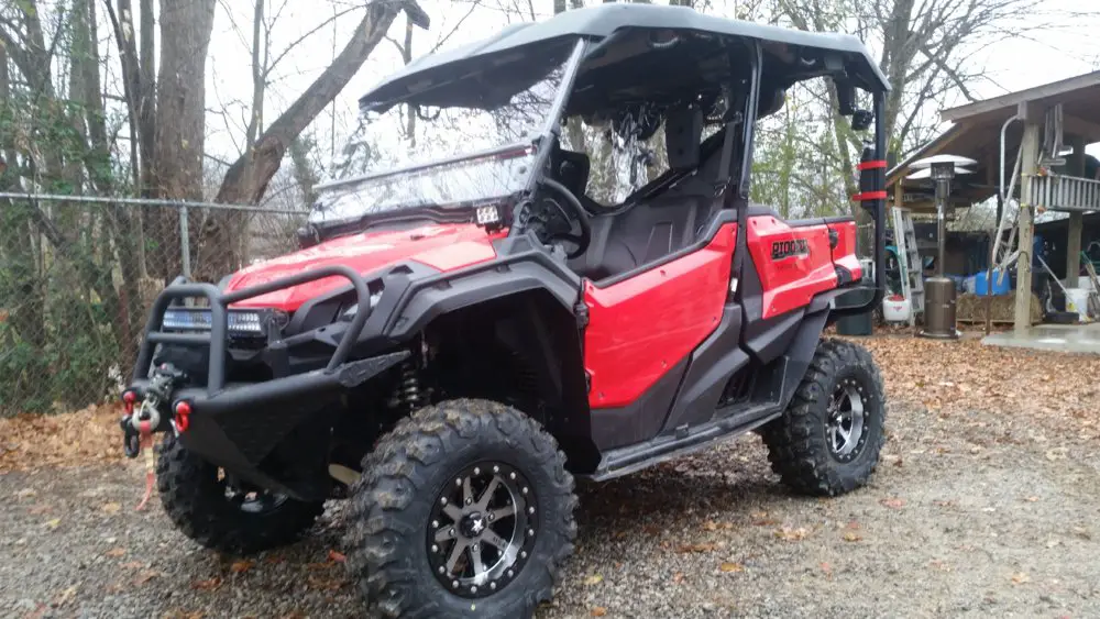

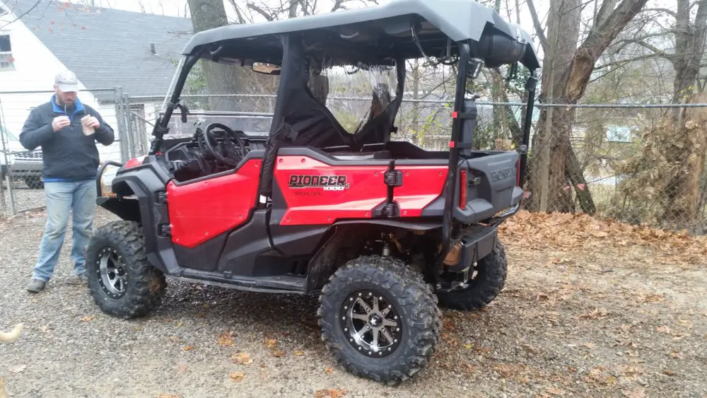

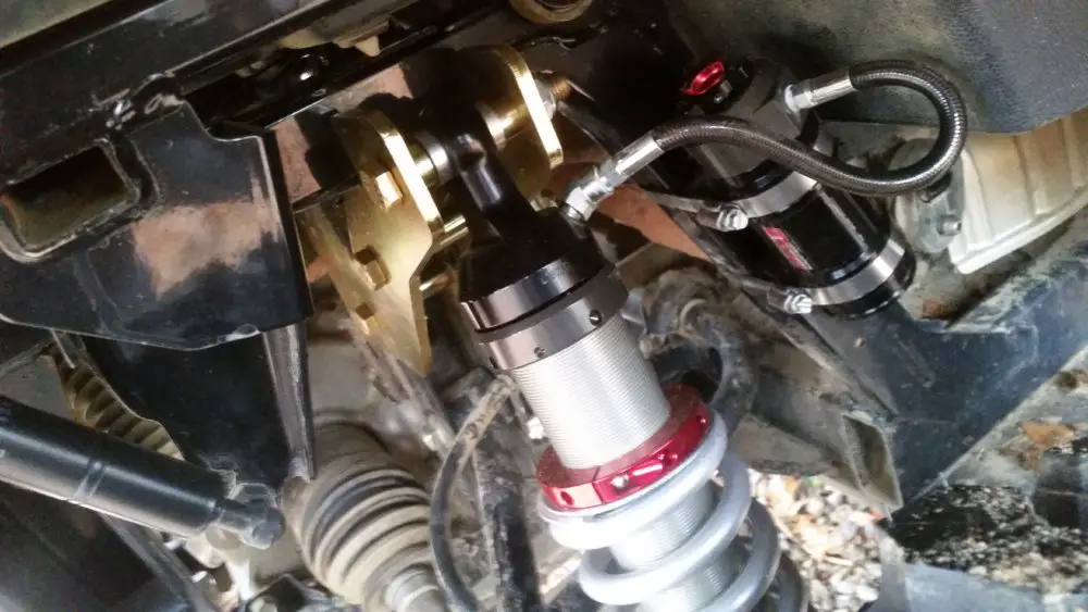

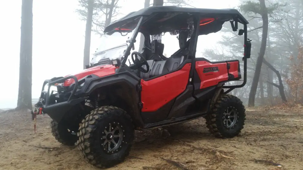

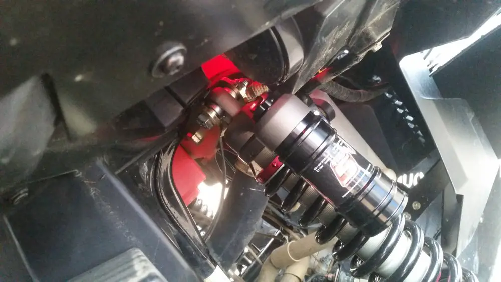

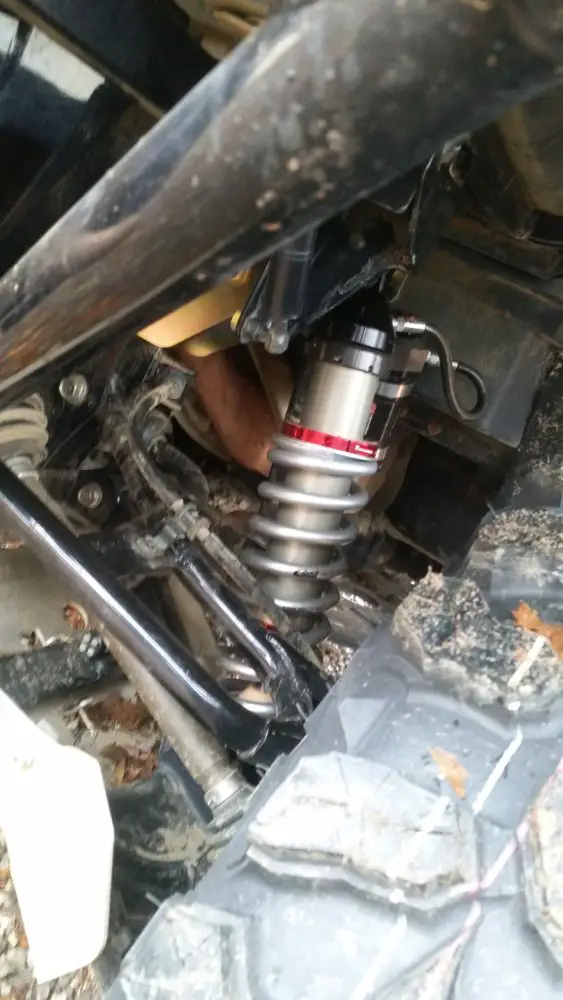

ok, @Delton @JTW @ghost @Windrock1000 ... I don't know where to begin... I added the Highlifter lift kit, Elka stage 5 shocks, MSA 3.5" offset wheels, and 28x10x14 maxxis carnivores... boys, I think old Pete is dialed in! I took a buddy up on Aetna today. he has been up there several times with me, and we were both left speechless today! this set up feels custom suited for the p1k! I won't get on here and gush, but GOT.DAM! we rode for about 2 hours just feeling things out, and it was like butter. stuff that used to slow me down, we just floated right through it today. I eventually started trying intentionally to find the bottom of the Elka shocks and I only managed to bottom out twice, on purpose, on some knarly s*** bc I just kept the hammer down. it is really unbelievable. it wasn't cheap, but I am one happy camper with this set up!

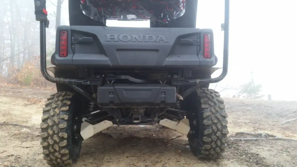

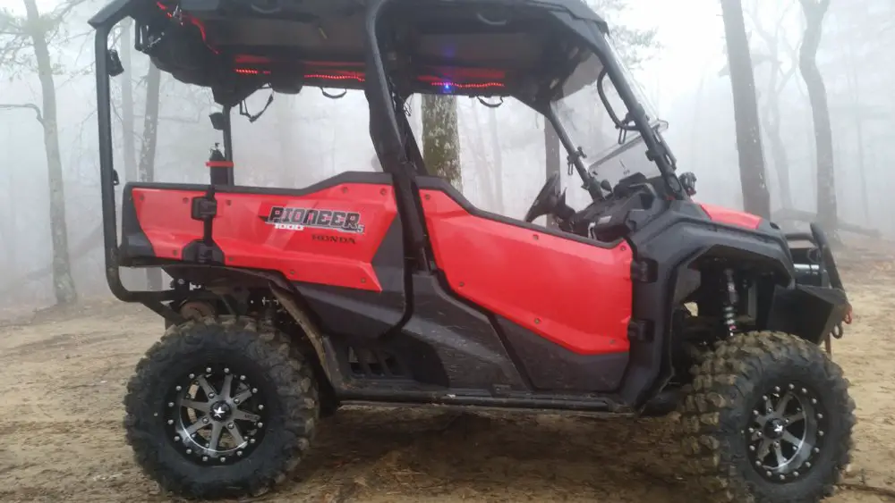

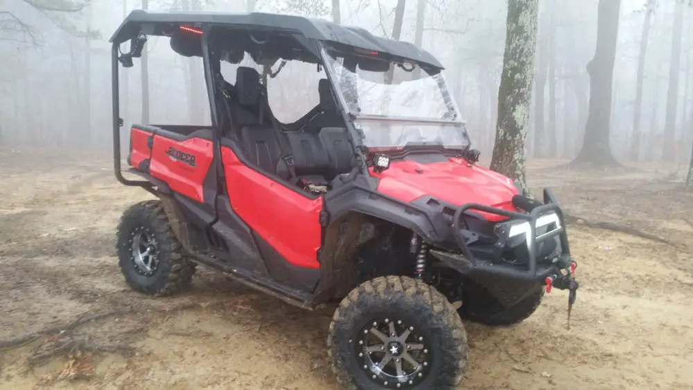

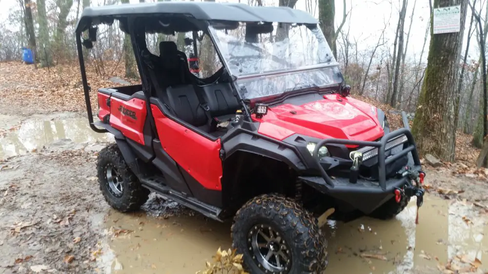

A few pictures from today's Aetna Mountain Adventure... I really can't believe how smooth the p1k can actually be... having the Elkas is like cheating. sorry boys, I'll try to wait up for you!
View attachment 28708 View attachment 28709 View attachment 28710 View attachment 28711 View attachment 28712 View attachment 28713 View attachment 28714 View attachment 28715 View attachment 28716 View attachment 28717
Awesome!! I'm going to try the lift and Fox shocks keeping the stock wheels and tires

Did you do rear shocks too?
yes, all the way around... I can't say enough about the Elkas... I'm sorry I ever doubted them... those boys dialed me up perfectly. I didn't have to make any adjustments and don't plan on touching any of the dials. they sent me a form that tells how many turns each setting was tuned from the factory, so I can always go back to those settings if it ever gets messed up.
