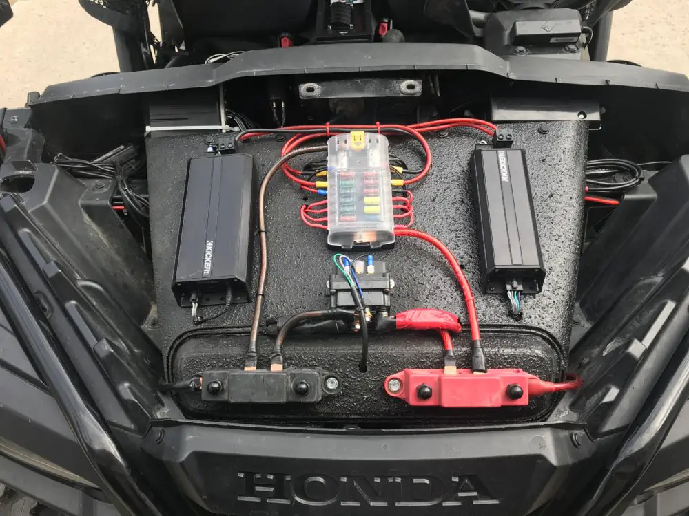

Wanted to test the impact of zero gauge wiring in comparison to the 4 gauge prior to installing the cap and wanted to protect it against the elements by waterproofing it a bit...
A69FF249 C14A 46C5 B9D5 C1F47E3AD225 267C0ABA 20C4 4E11 BE21 0177DE4117B7
Removed the end caps on both side and applied silicon to them along with end cap screws and other entry points which may allow water to enter and cause problems!
Completed testing today and the wiring difference alone is noticeable! Couldn’t get the amp to kick out like it was before but want to play around with it a bit more before the cap so that I can determine its impact on the system!

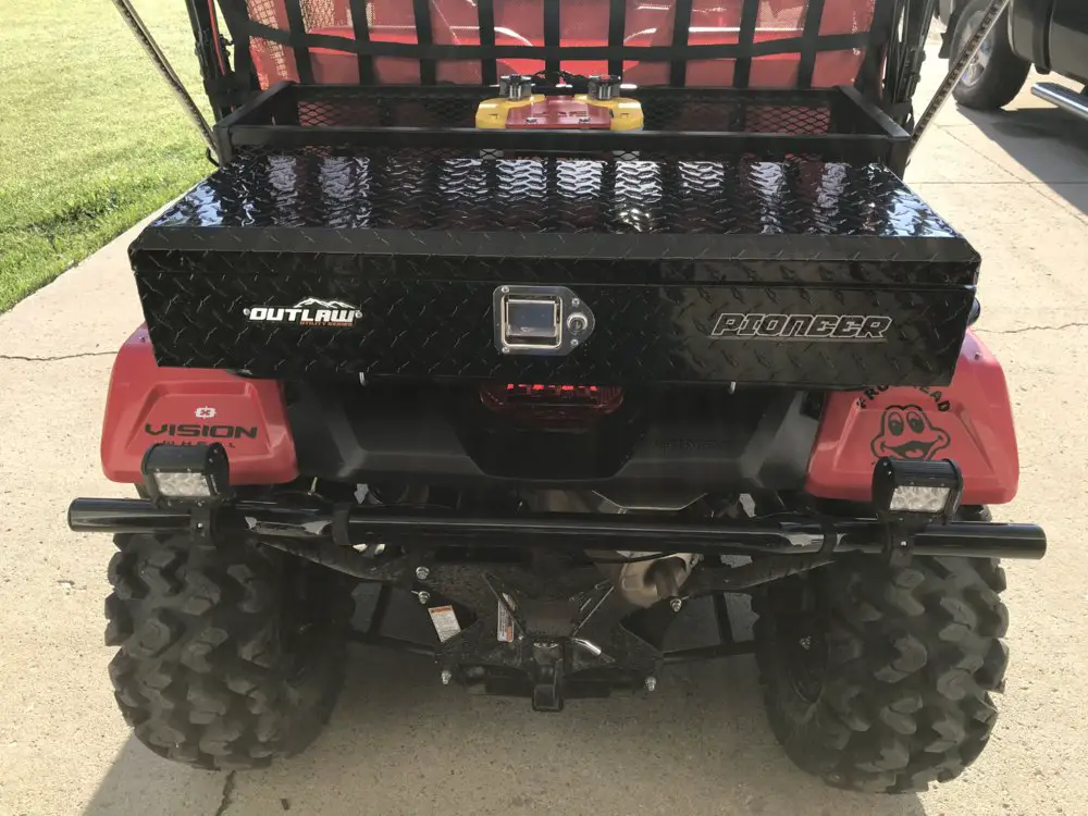

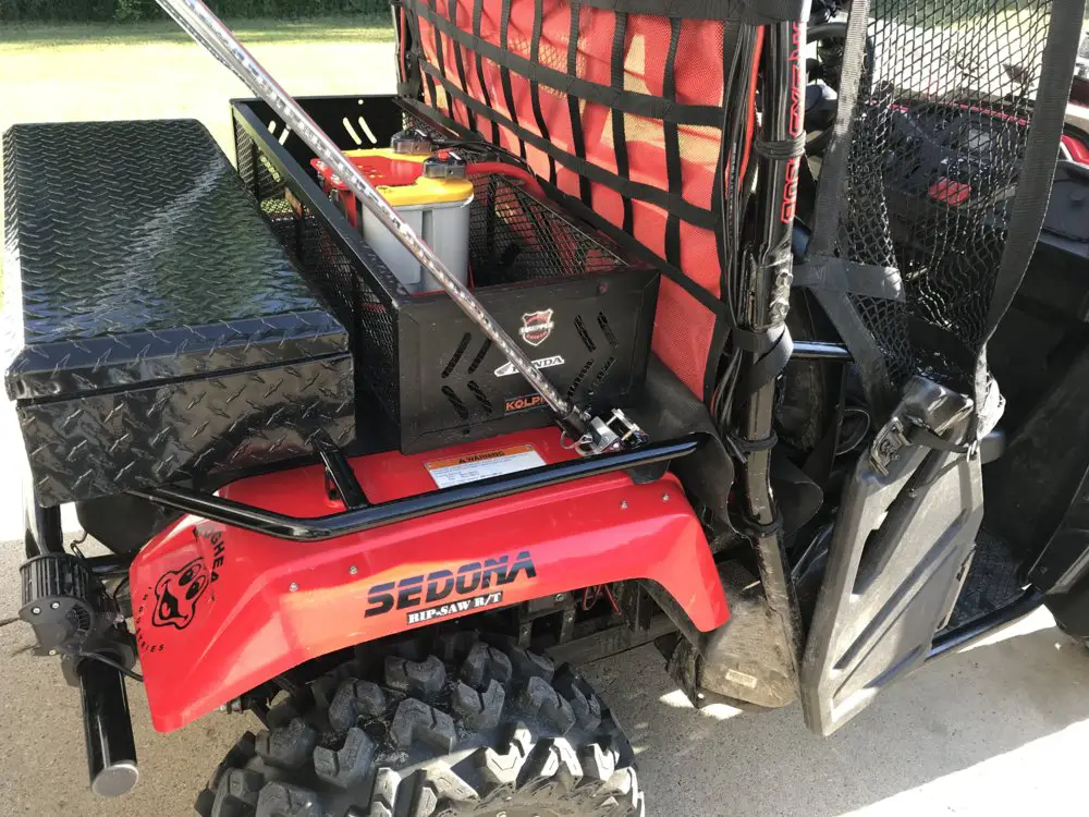

Eltobgi, is that a front/rear mount winch set up? If so, id appreciate any details you can share, love to do the same thing!
Yes it is! Simply ran two sets of leads. One to the front and one to the back...
40696E23 5958 4578 8F4C 182F83BEA1E8
Notice in the pic here two leads off the solenoid.
With this set up you use only one winch. Move it to the location that’s needed;)
