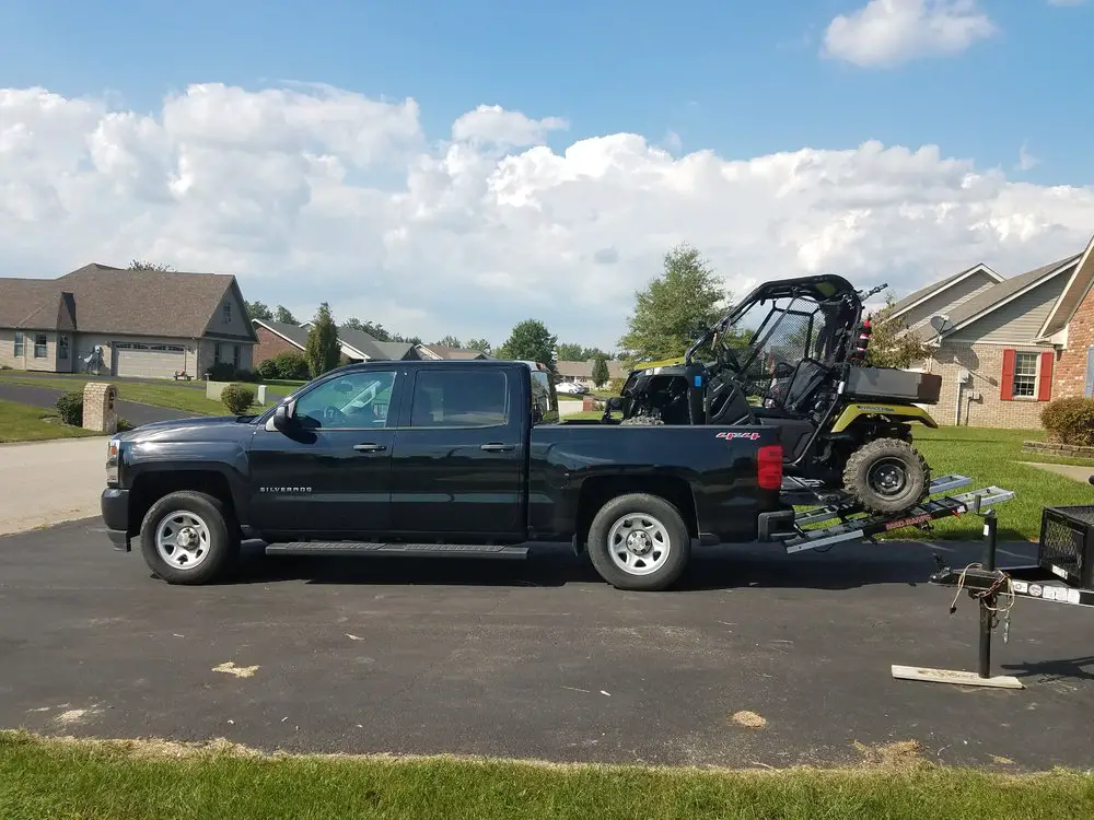

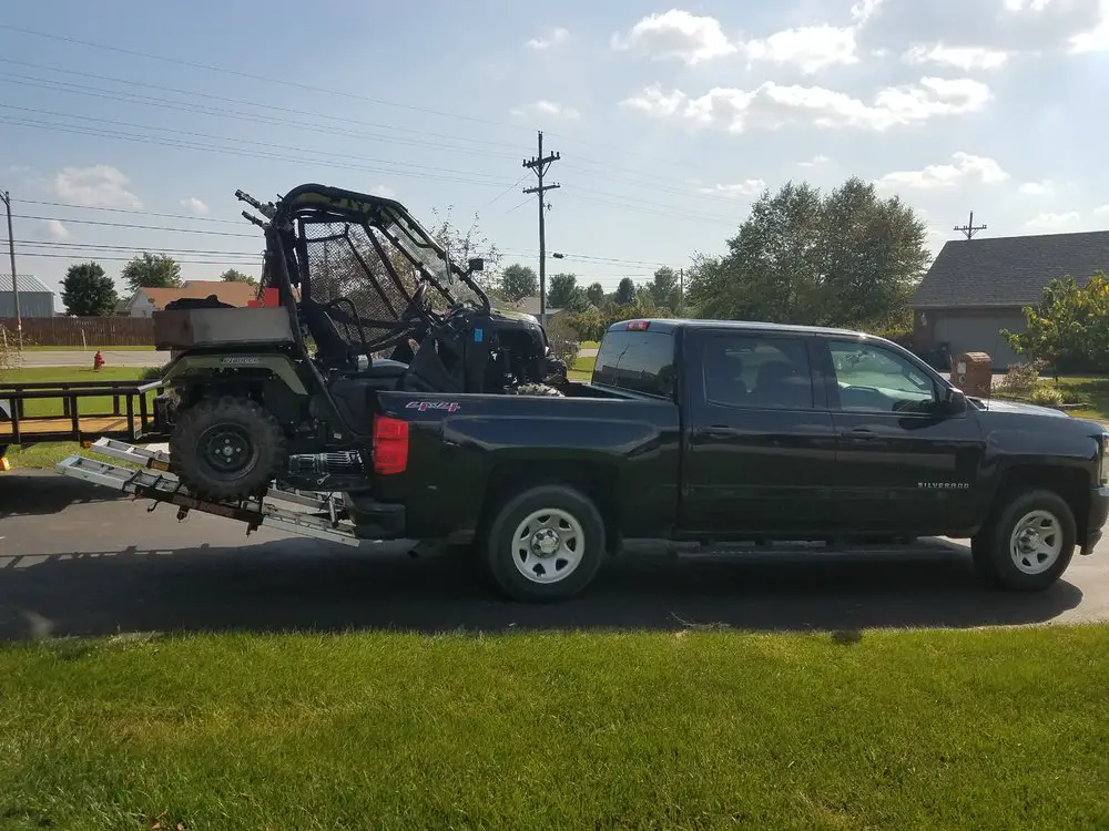

Sunk the money on mad ramps. Works like stated. Love it. Short bed.....best thing if you don't weld or fabricate. Have trailer but like this for spots with little to no turn around

5.5. Mad ramps use the trailer hitch
Right my bad 5.5 , never owned one or had use for one. Not giving u chit...that hitch thing is made for that? If so? Neat!

Can the hitch take all that weight.?
Yep. ClassIV hitch and good condition. Would not on class III. Tongue weight on toy hauler is 475lbs. Been pulling it thousands of miles. See the photo of atc toy hauler.
I checked truck squat and it is the same as the trailer. Handling in corners with pioneer 500 in bed is definitely not the same though.

I looked on the Mad Ramps website and using their formula, you definately need a class 4 receiver. Most pickups, unless you have a HD towing pkg , will have a class 3 receiver limiting you to 500lbs of tongue weight.

That looks scary. I wouldn’t want to be driving in a snowstorm with that. Good luck. And good luck hunting. This guy is still around this year. Only like four snow storms last year. Enjoy.

Agree. Handling is much different than towing it on utility trailer. But it's better than than the over the bed decks. Still use my trailers when needed ...camping or when hualing hunting gear or food plot equipment.

Is that a Silverado 1500? Do you feel stable driving that setup on the freeway? Does it feel as stable or as easy as hauling the p500 with a trailer? I want to get this setup with some sumo springs. Would appreciate your input?
