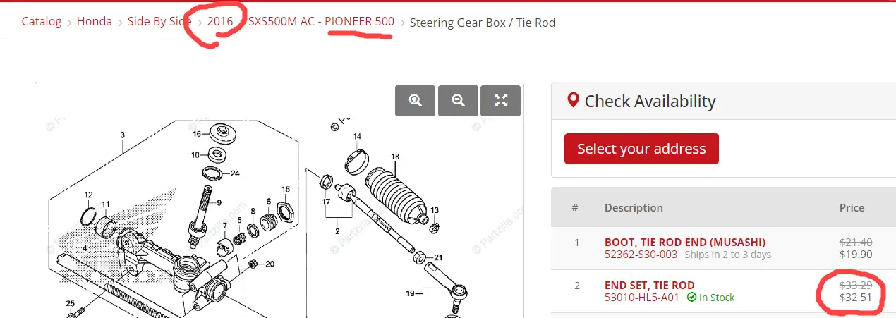

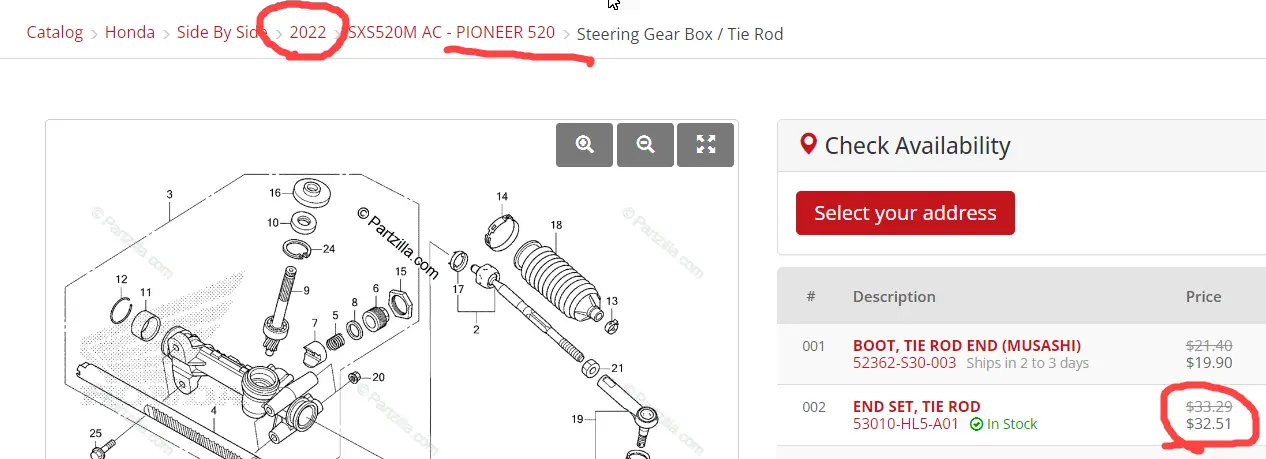

I'm not sure where you are getting your price from.
I had assumed the tie rods are exactly the same from the first P500 to a P520 made yesterday.
Looking at Partszilla they give the same part number and the same cost (sorry only 2 data points).
P500:
1677774848414
P520:
1677774899979
Same part number and same cost.
So, it should make no difference, get the lowest cost one.
