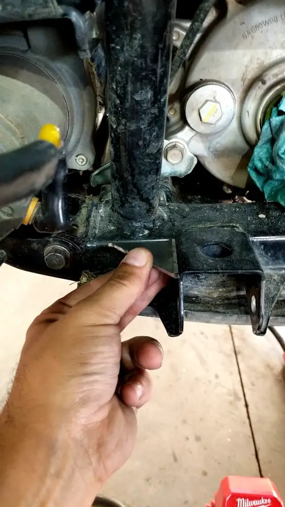

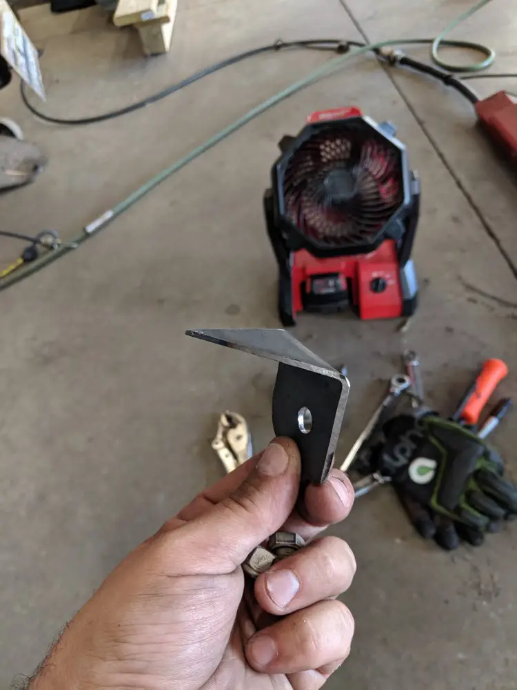

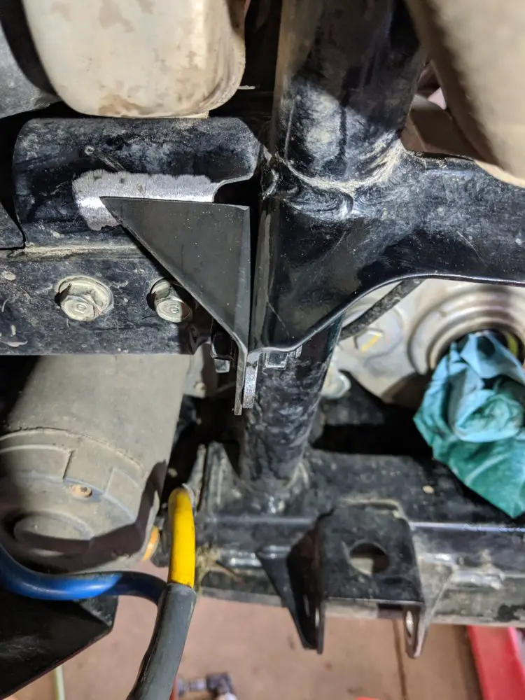

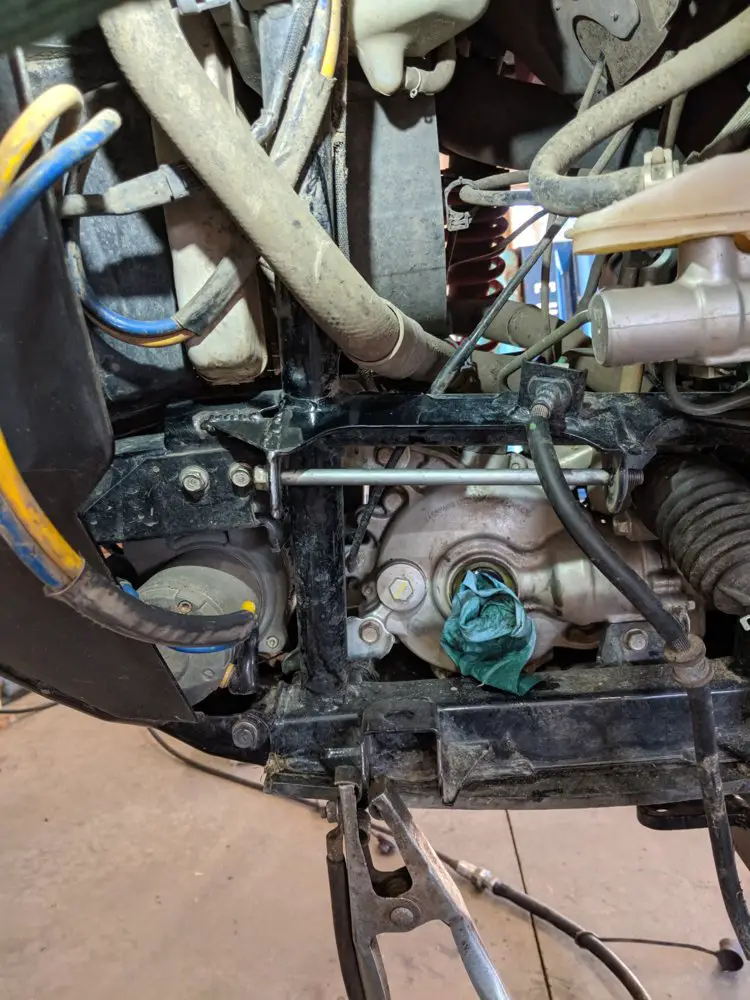

Back to work on this thing. A-arm mounts gusseted and SuperATV arms going on. Fixed a ripped inner front CV boot too. I'll swap to stainless brake lines before it comes off the lift too.
Upper tab
IMG 20190819 173529
IMG 20190819 175728
IMG 20190819 181447

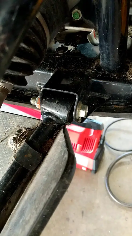

Lower tab
58872
58873
58895
Why'd I do the lower front??? Well this looks kinda bad. My assumption is the compliance of the Honda a-arm bushing saved me a but more damage here. With the SuperATV arms and bushings I might not be so lucky.
Upper tab
View attachment 148748 View attachment 148749 View attachment 148750
Lower tab

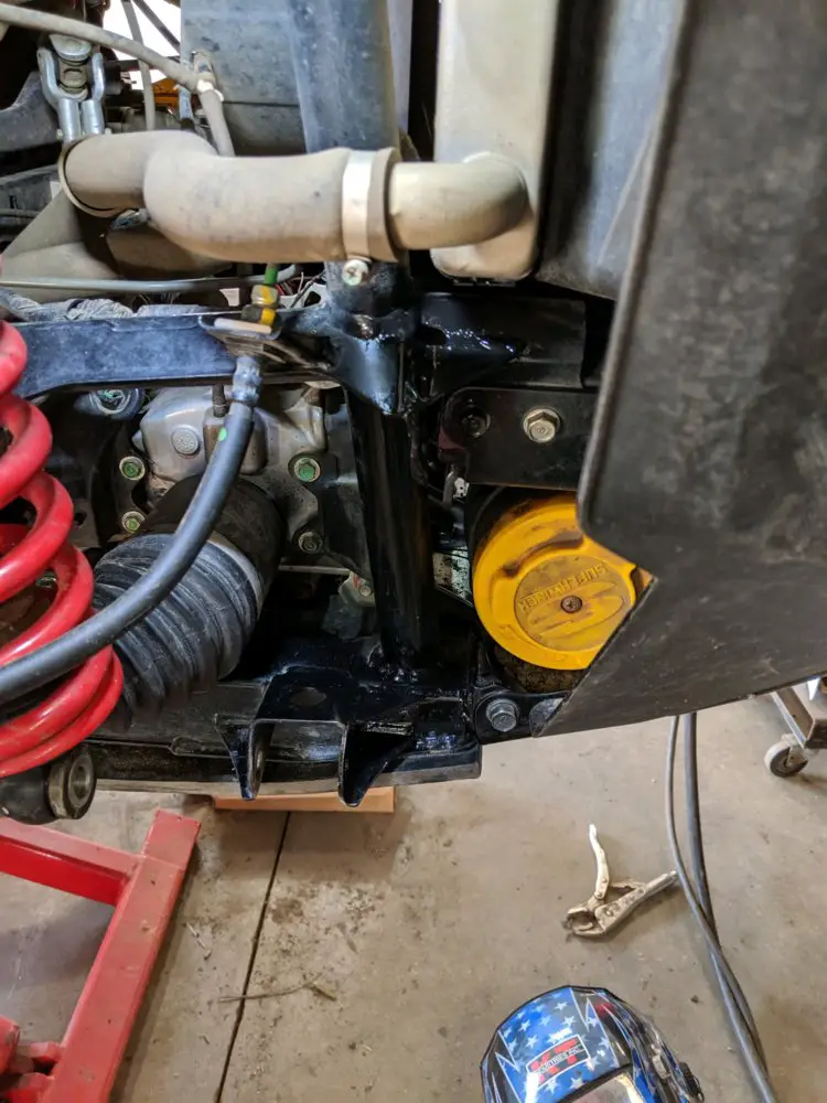

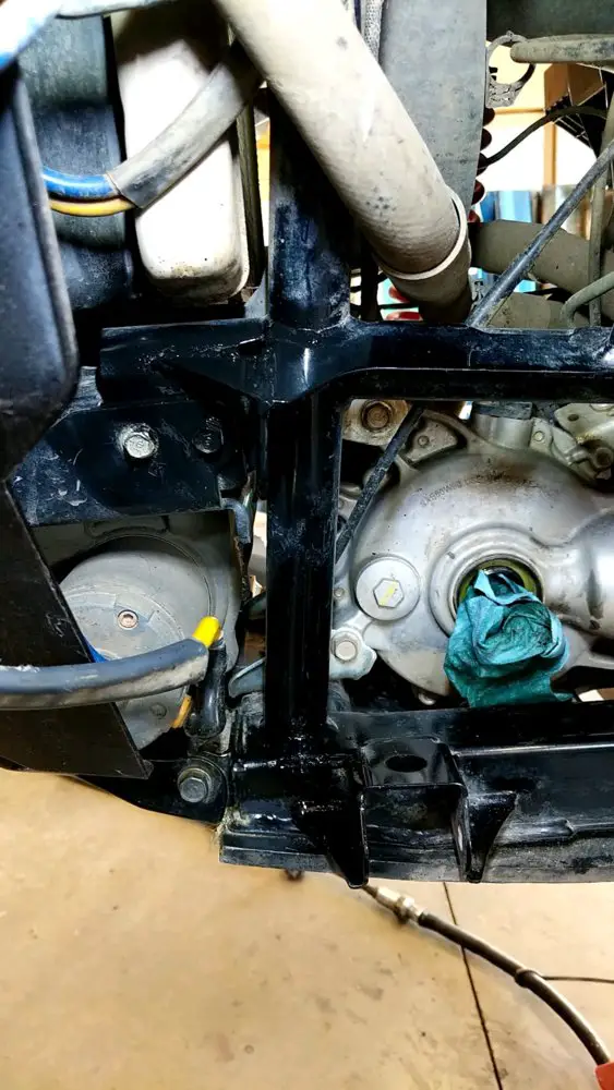

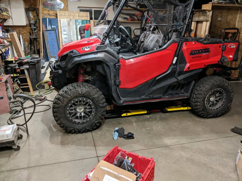

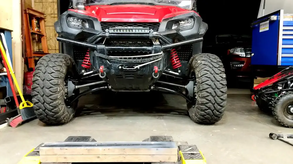

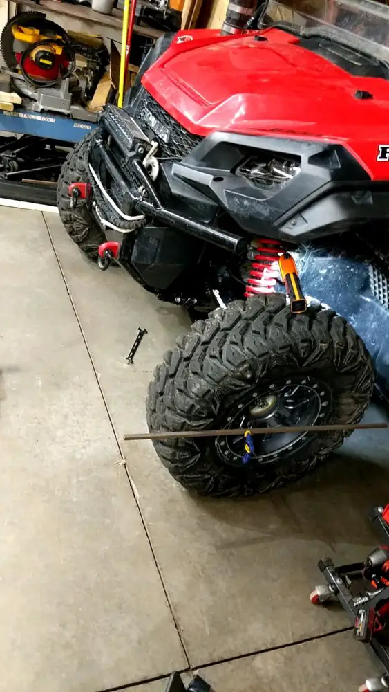

I welded up the right side today. Overall really happy with the fit of the mount gussets and SuperATV arms. The camber was perfect out of the box and the alignment was pretty easy.
Right side welded up and painted with Rust-Oleum 2x paint/primer in gloss black
59165
Back on the ground
59194
59203
Hill Billy alignment, 1/8" toe in and a straight wheel sounds good to me.
Back on the ground
Next up:
300lb springs for the rear fox shocks
Left rear outer CV boot.
Grease rear wheel bearings.
The new machine has 455 miles of fun on it.
Hey that HillBilly alignment is the best out there. Looking good man! Nice job
