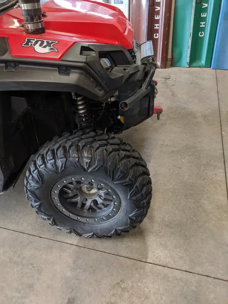

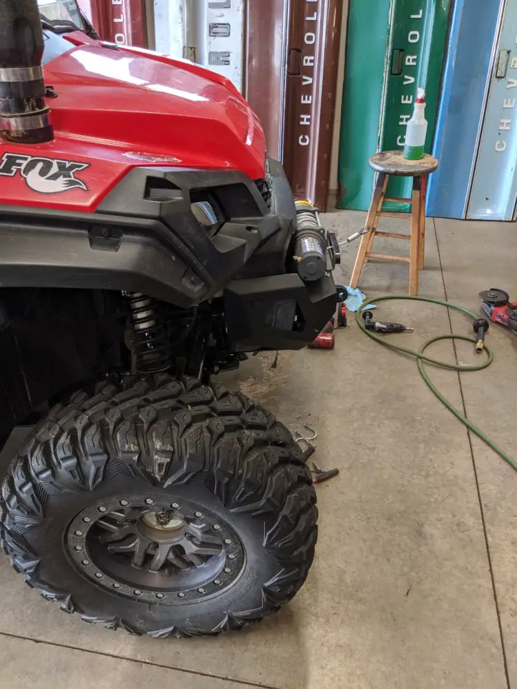

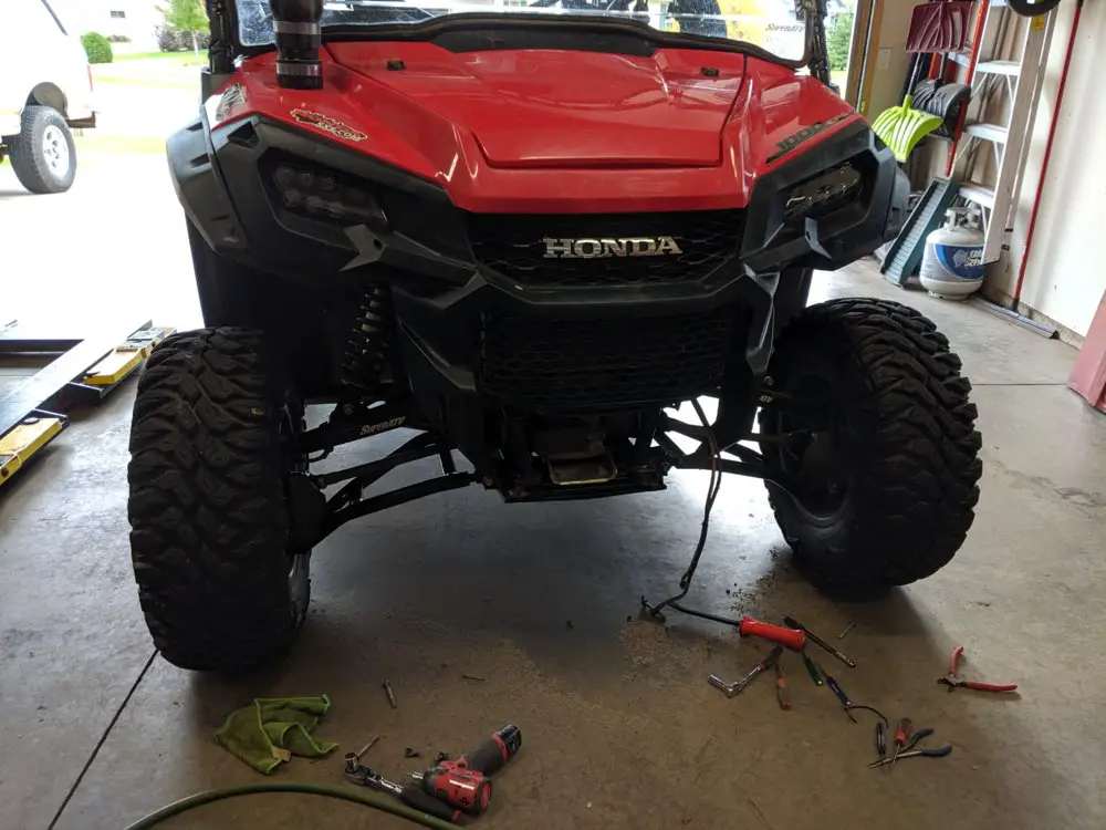

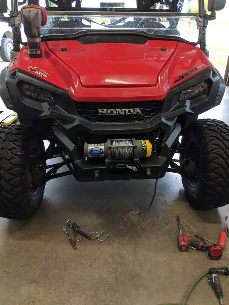

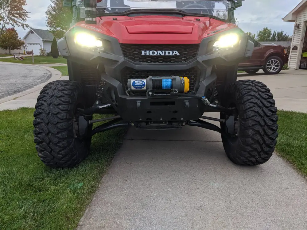

My Superwinch Terra 45 has been finicky lately about freespool and my expectation is that it's full of mud. I also came across a deal on a Warn winch bumper and a like new Terra 45. Todays project was pulling off the old bumper and swapping on the new bumper and winch. I'll tear down the old winch another day.
My setup to date has been the Terra45, stock bumper with bolt on tie downs and a Warn winch mount. The warn mount is a huge improvement in my opinion over my previous KFI mount but the access to the winch is still poor and seeing the cable is impossible.
IMG 20191019 143817
IMG 20191019 143842
Tear down
IMG 20191019 150222
Test fit, some grinding required to clear my upper a-arm gussets
IMG 20191019 153452
IMG 20191019 153452
IMG 20191019 153551
Pull test to stretch the new rope
IMG 20191019 171117
IMG 20191019 171613
IMG 20191019 171623
IMG 20191019 171628
Overall, I really like it.
Tear down
View attachment 162017 View attachment 162018
I really like that! I've got the factory bumper with KFI mount and Terra 4500. Your new setup is worlds better, I hate the way mine is currently. Aggravating as hell to get to the free spool!

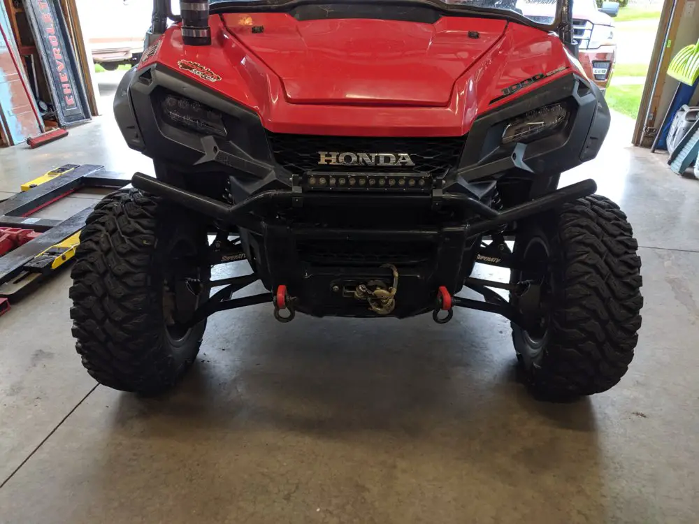

I added a few new parts today. 6" Rough Country light bar was first. I added it in the opening of my Warn front bumper. It was a perfect fit for the cut out.
IMG 20191102 192158
Next upgrade was to fix the gap under my Warn bumper. I remembered that I had tucked away a Warn plow mount in the basement. Turns out it's a pretty good fit for the gap.
Mount
IMG 20191102 194724
Gap
IMG 20191102 194727
Mount installed
IMG 20191102 204217
The plow mount is really beefy and the leading edge is all 1/4" steel. I think it'll make a nice frame protector and it fits well with my skid plate
IMG 20191102 204210
With the plow bracket installed, this really snowballed. I've been storing a 72" plow Warn plow for 2 years and today I had to check it out. It looks awesome. I have no need for this but it was a good deal at the time and someday I hope to have a driveway that needs it.
