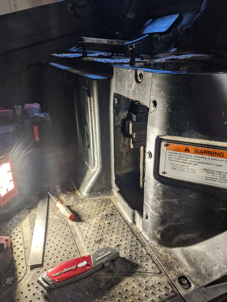

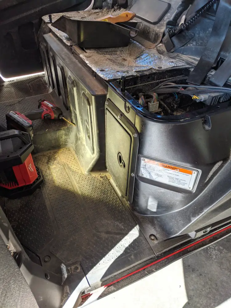

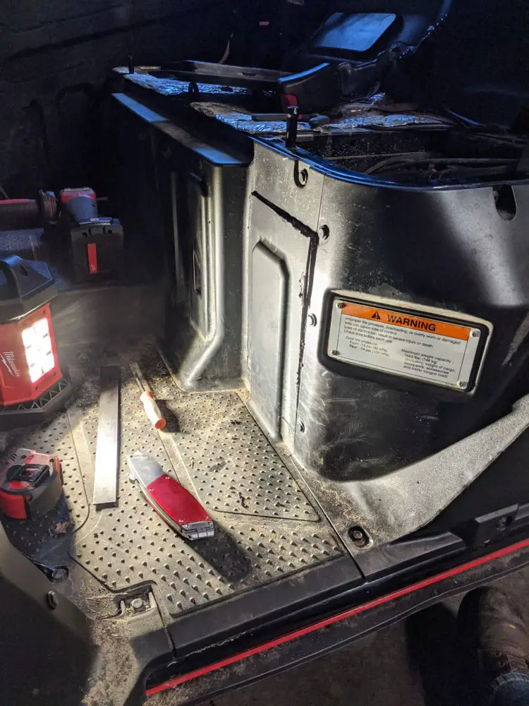

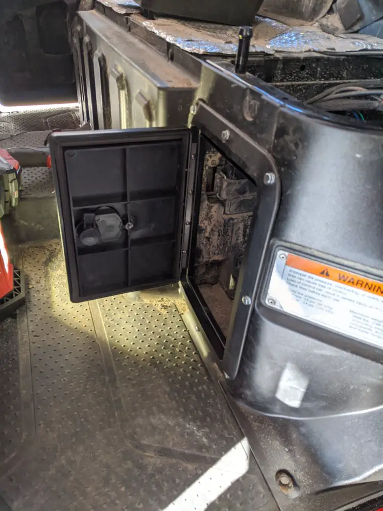

Not new news around here but I added my under seat storage box today. Great mod. I cut the door for a better fit and it was perfect.
IMG 20200202 101216
Hole cut
IMG 20200202 103143
Cut out removed
IMG 20200202 103447
Door in place
IMG 20200202 124332
Door installed
IMG 20200202 124332
Door open
IMG 20200202 124342

Dadgum, my door looks exactly like that but apparently is not the same size. I made the cutout on the interior side slap up against the raised portion of panel and cut the exterior side past where the joints overlapped, cutting into the plastic rivets ...... and it still is not wide enough. Were there 2 difference sizes of doors on Amazon?
8,326
63,026
Which one did you buy? I'm sure there are a few different size ones, but the link floating around here has only been for this one as far as I know:
1581024328656
8,326
63,026
That is the same one. Not sure how yall made the cutout without going past the rivets?
I had to cut just into the edge of the holes for my rivets. Looks like @ToddACimer may have put his a hair closer to the inside edge since he was able to keep the holes intact.
