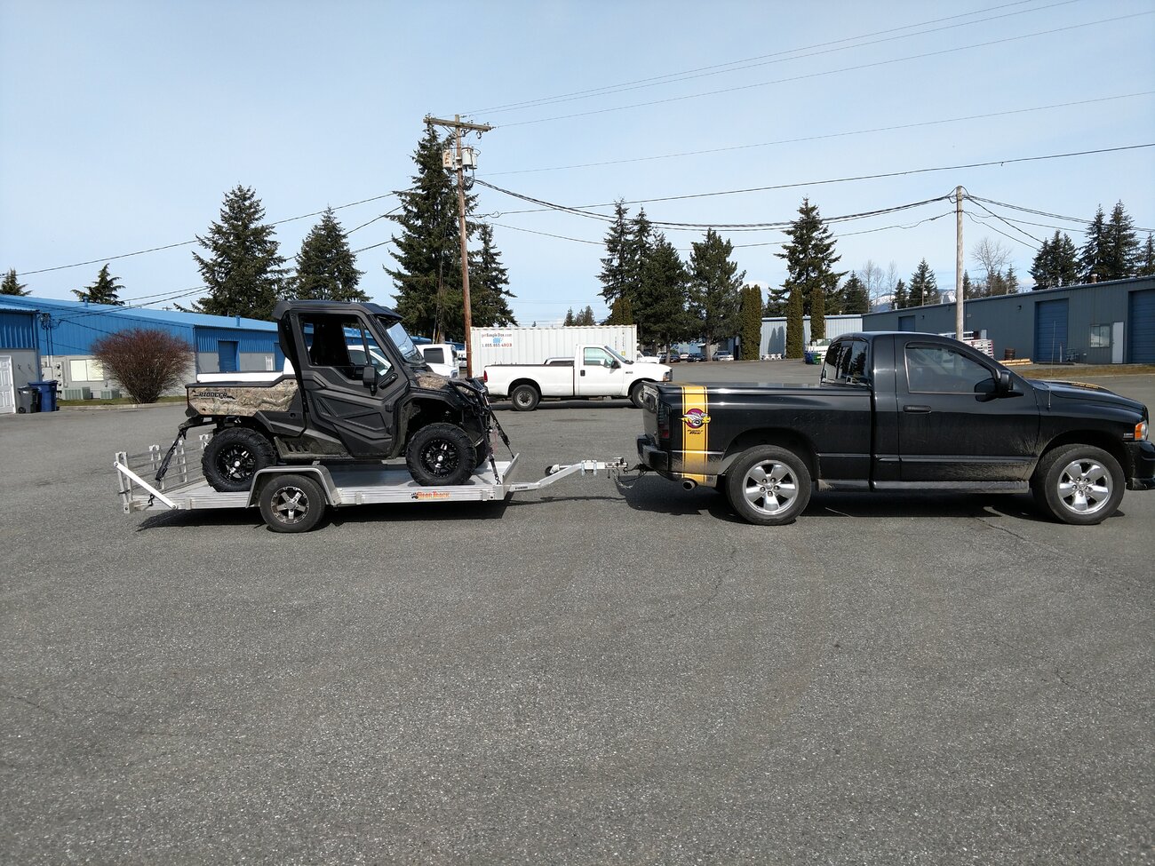

This is my Talon on a 14' trailer (7" longer than a P1K). Since it was my first SxS, I had no idea where I was headed with the hobby so I went a little longer than minimum (if you have the room to store it, you won't be sorry).
Loaded for travel. I get by with a single axle but I'm right up against the 3500 lb. axle rating when fully loaded.

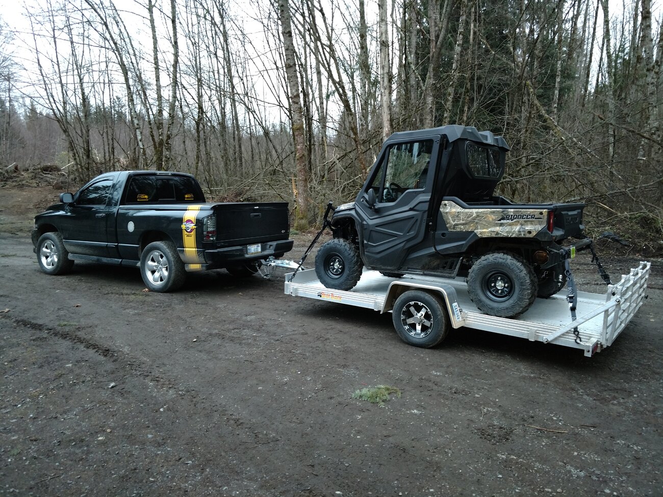

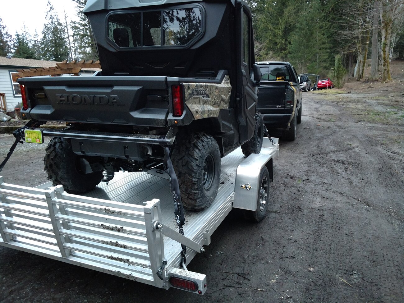

I had to add holes to the ramp holding straps to move it back far enough to reduce my tongue weight with a full load of fuel. Since I didn't know what I needed, I added 4 holes but cut 2 off later, one at a time. As the Prez said above, controlling tongue weight might be a problem with a shorter trailer. I also didn't know that I'd be adding a bed extender/spare carrier.

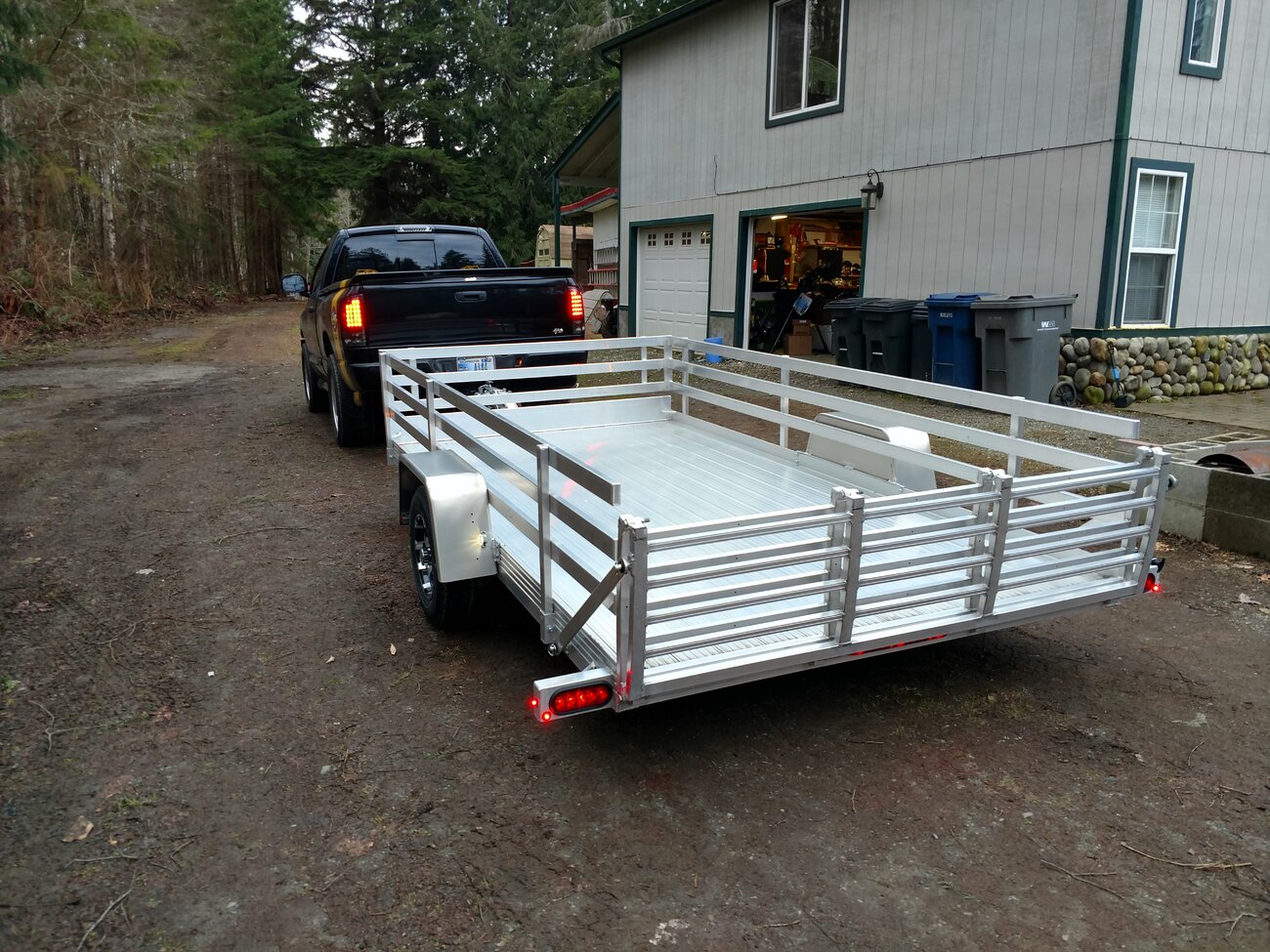

I just went thru this for my Honda 700, and settled on a Karavan 6.8 x 13 trailer. I love the drop sides, and at 80" it's wide enough I can walk around it while loaded. Might be a little tighter width wise with the 1000 but your tires won't hit the rails.
It's a single axle with about 2300 lbs of payload available, which should be enough for the 1000 and some gear.
Happy with the extra couple feet at either end. Given a choice I'd rather have the 16' dual axle, but I know this can go behind a fifth wheel when we get around to upgrading the RV in a year or so.
