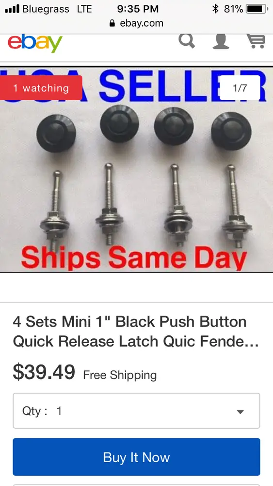

Here’s another possible option.. I’m going to order some to try on mine..
Very cool! It would be nice if they offered those in 6 mm thread so I could use the factory installed nuts. Maybe they do, I’ll check. I could always make my own 6mm bolts with ball end if they didn’t have them.
Then the “knob” is flush mount so I would need to cut a large hole.
Still very cool, thanks

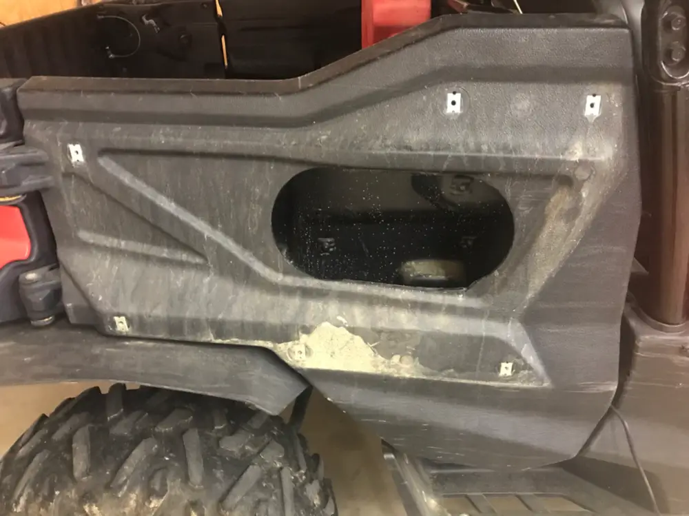

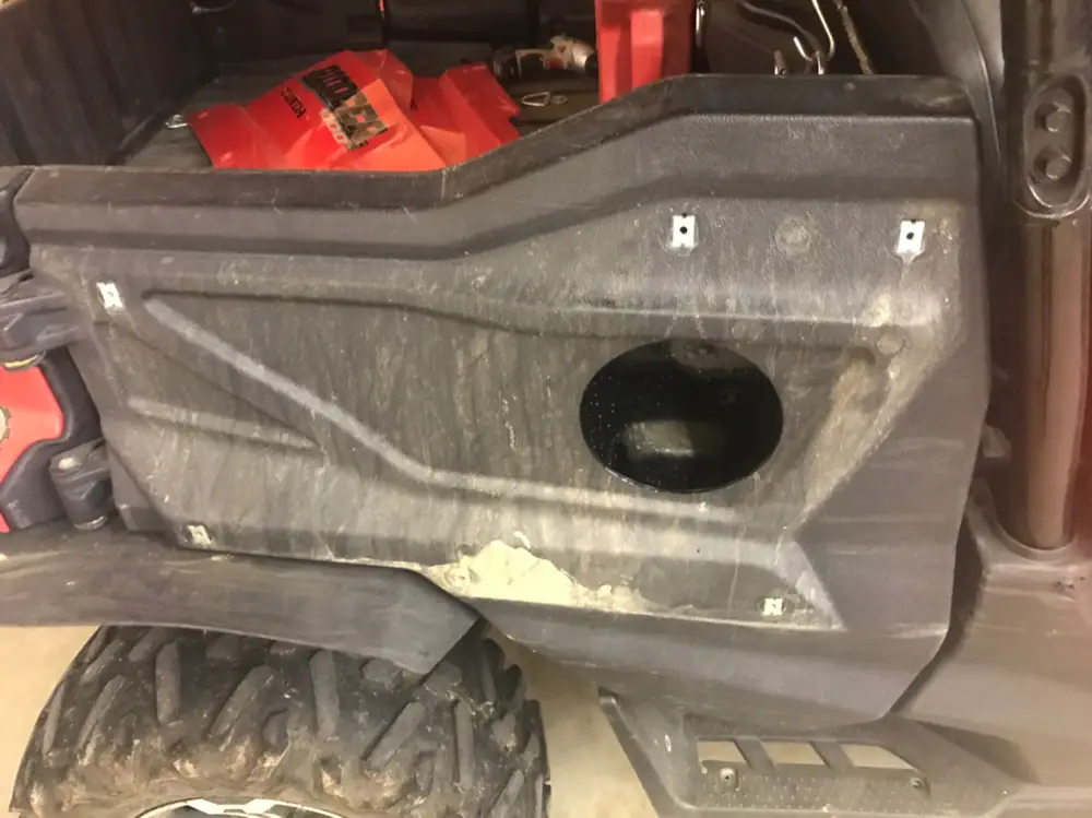

I had to go back to work so that slow the progress down. But I did get a couple more things done.

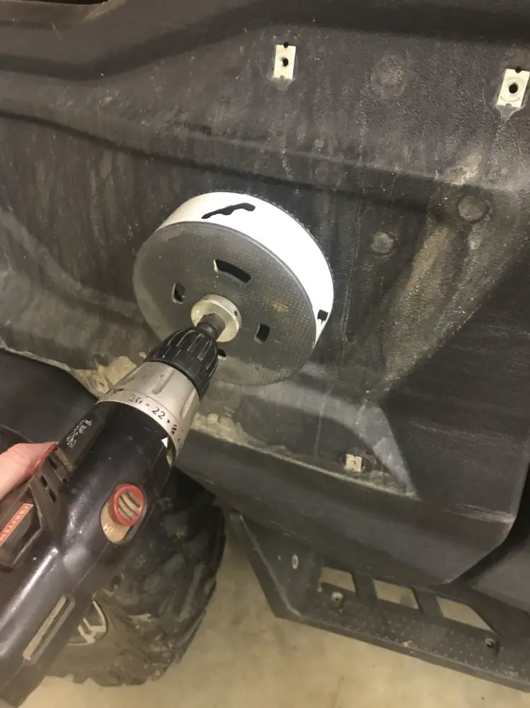

I had this 6” hole saw from building some Cornhole boards. So why not use it?
B1aa088ec178424fbde1255a5e63cc01
2ed84c8122e76a2d49c7751184a5c312
Two cuts seems like it will allow for larger objects.

32,051

Hole looks good.. did you decide what fastners to use?
For now I’m going to put two or three 5 mm hex wrenches in the glove box and just put the screws back in the red panels.
I’ve had several thoughts. I might get some 6 mm stainless studs and make my own thumb screws to install.
Another thought is to put studs in the door with holes in the ends of them. And put some kind of small bungee between the screws to hold the door panel in place. Something similar to para cord for lashing items on canoes or kayaks.
But for now I will use stock hardware and carry extra tools in case I drop one and lose it. Sometime soon one of you guys gonna come up with a better idea that won’t cost a fortune.
