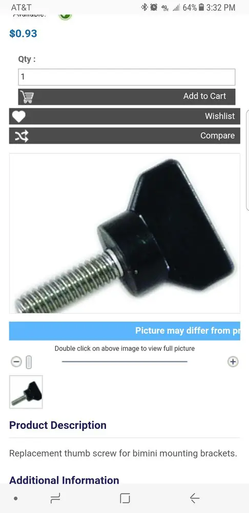

Honestly, either the velcro or @snuffnwhisky suggestion to tig a wingnut will be the cheapest easiest solution.
39,129
I’ll try the Velcro and use two thumb screws per panel for just incase.
Now how do I make the hook and loop and stick to the plastic reliably thru winter and summer? Use adhesion promoter? Of coarse it needs to be scuffed.
