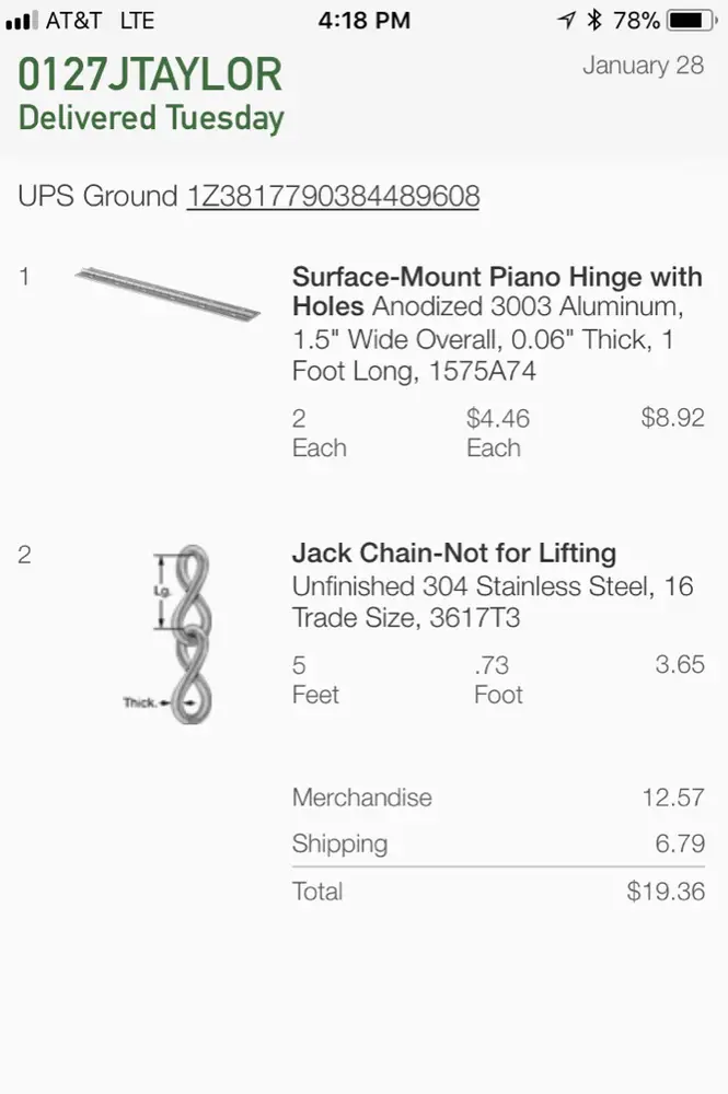

Finally got some time home and finished this project. Well, almost finished. Still waiting on the thumb screws. I’ll do 2-3 per door and that should be enough.

Thoughts:
It’s easy to get to. In the past I was required to remove ratchet straps or bungees that held the boxes down in the bed. Now it’s just a couple thumb screws and dig for it.
The hinge needs washers for backing inside the door.
The hinge needs spacers between the colored panel and the hinge. I used some small #10 nuts.
I bought 10 thumb screws. I’ll keep extra in the glove box. Extra could be used for trailering.

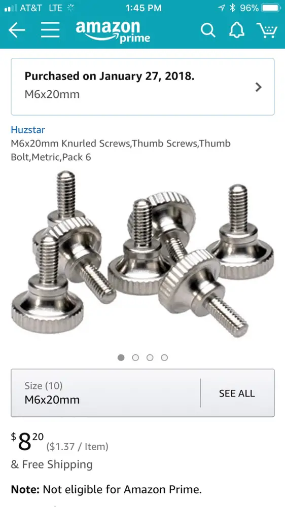

The thumb screws arrived. I think it will work good. I bought six, two for each door and two spare in the glove box.
0ca786729c37c6e67cb9556e5a4f451e
I cut some of the screw off so I didn’t have to thread it so far. Then I used a shoulder nut so it captures the plastic.
Bf86c84d17271cd4b5a81c216b8570b7
39,130
The shoulder nuts have loctite on them.
Here is the pieces I bought. I thought these would have less chance of hanging since they are round versus a wing nut.
D4d57c9b120cb948721e84b5cc3cf4da
The 16mm length would be better as I had to cut the 20mm length.
