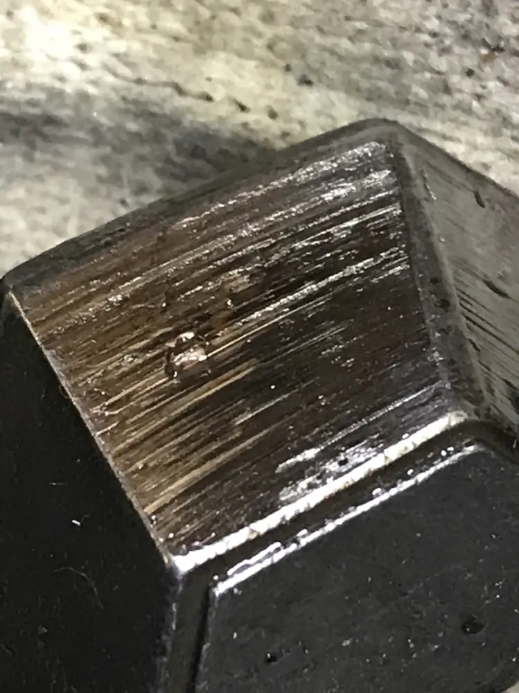

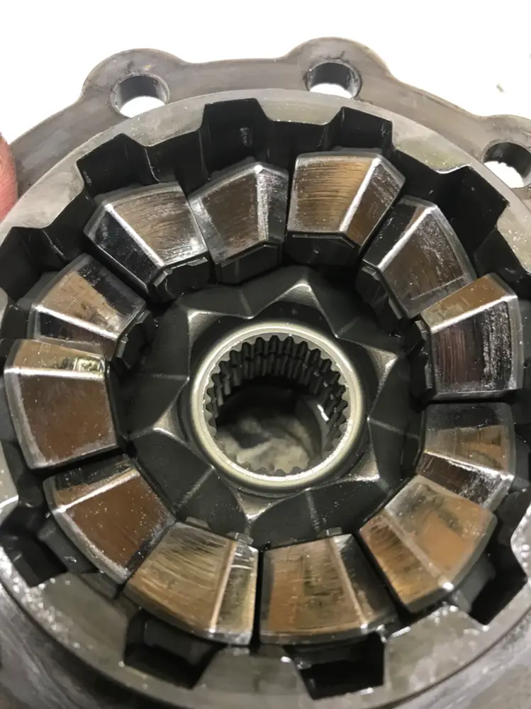

Here’s where the magic happens. I’ve never had one of these apart so this is a first for me and this type of limited slip. You can see one of the splined pieces, this is where one of the axles slip in. I’m not sure what you call the 12 bits that sit on the “spider gear” but they are what actually applies torque from one side to the other. They should have clean bearing surfaces too.
208dd1c2990839b92bf3c807a2b28ddd
A closer look at that one of those pieces...
4c3b959da71b4a565c8fe2e675992ba3
So what do y’all think? Did water contamination cause this?

I call them "teeth" (not the official name).
Watch some one drop thouse puppies on the floor and they scatter like teeth hitting the floor.
And they don't all fit right when you go to pit them back in - like teeth.
The wear pattern suggests you had contamination, mud grit or something.
Normal wear looks like a shiny or burnished area on 70% of the face (your pretty mechanical so I assume you know what I'm saying).
Also the thrust washer should show a burnished pattern, not gouges.
And if you do take them out there are 2 different shapes to the pucks, I cant remember if they alternate or if there is a pattern to putting them back in, the manual should say.
I can’t imagine how Joey got mud and grit in there!!? :rolleyes:
39,130
remember that there might be more to this story than what we see here. Did mud and water cause this? Or did the contamination that Lee was talking about come from somewhere else? There could be a possibility that I am withholding some information just to see what some you guys think initially.
