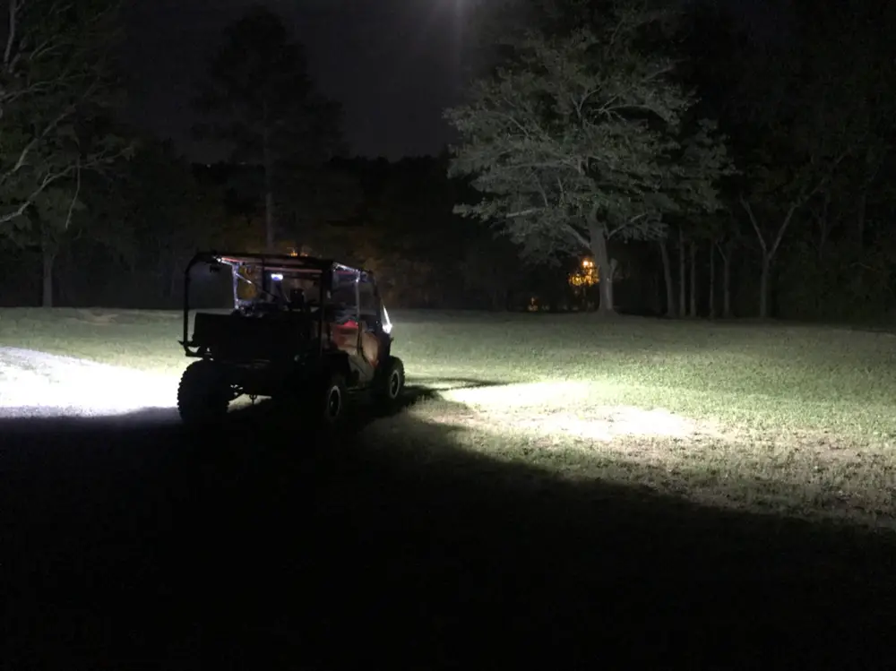

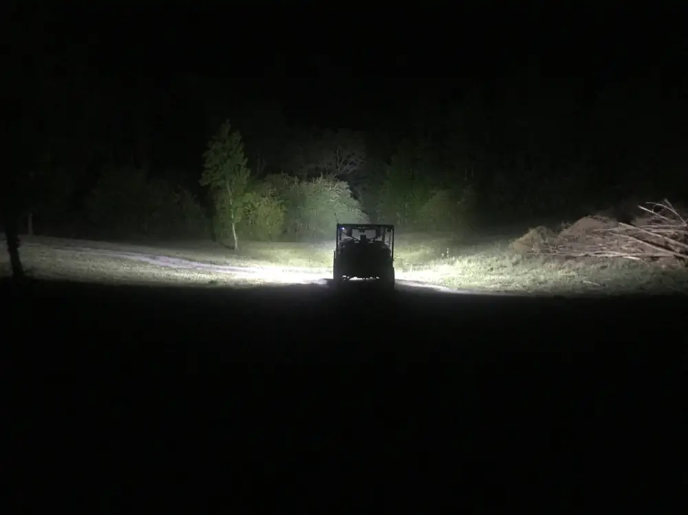

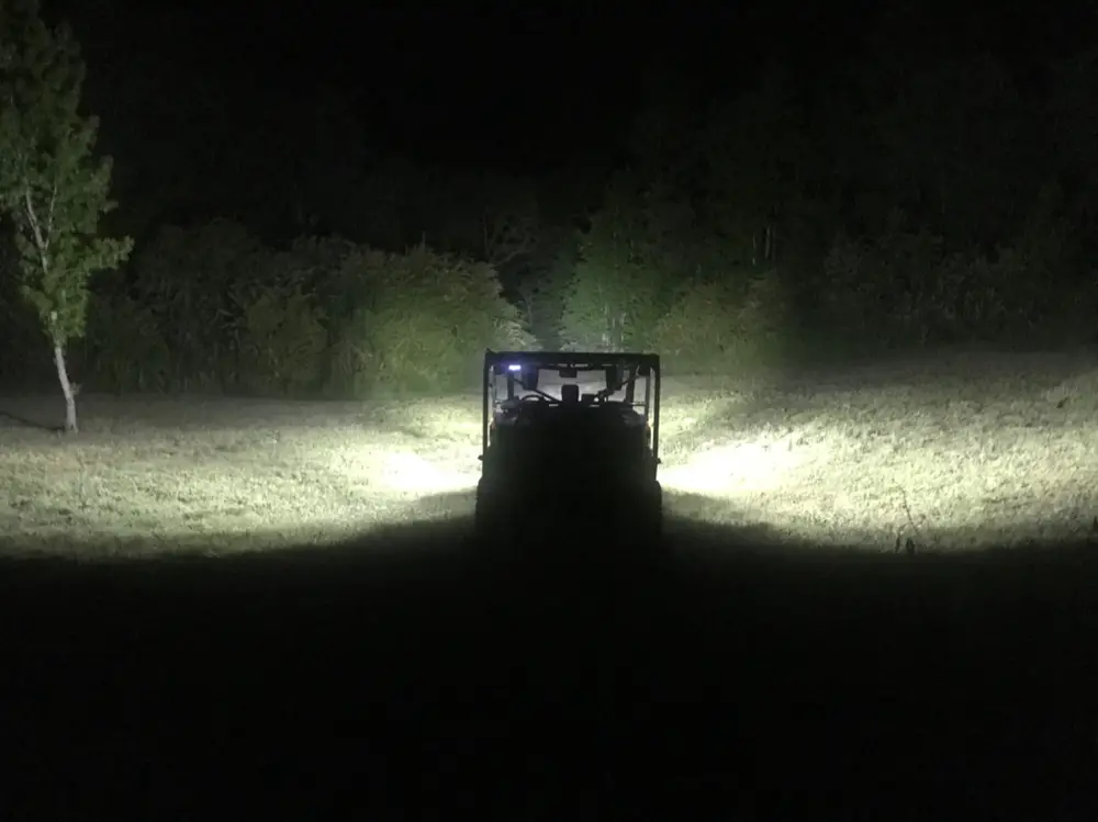

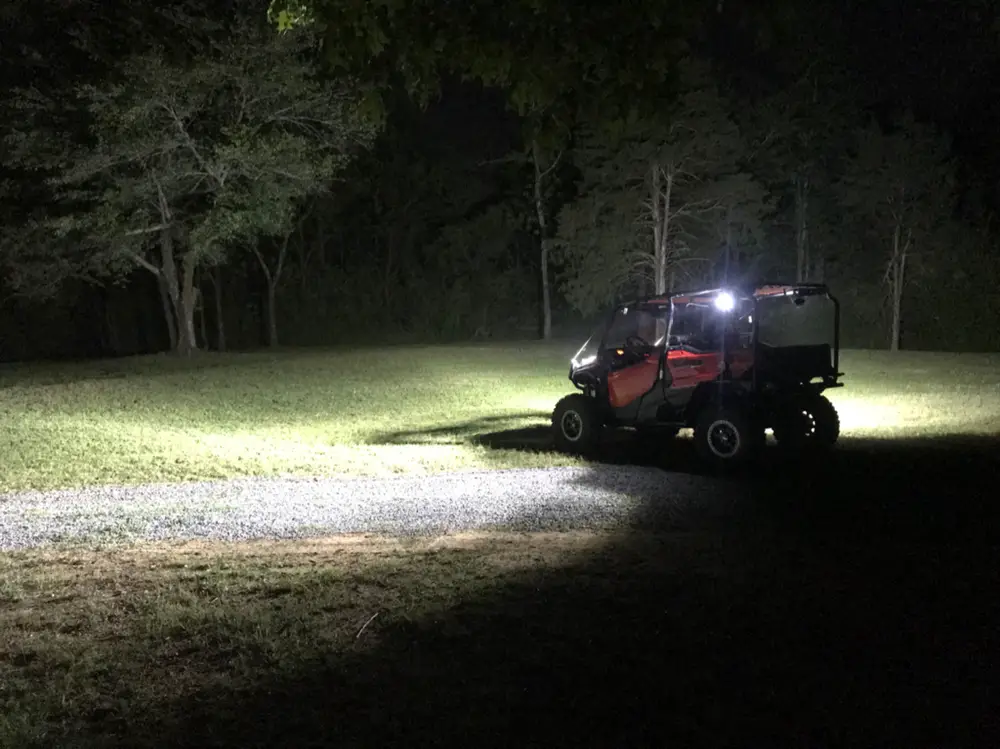

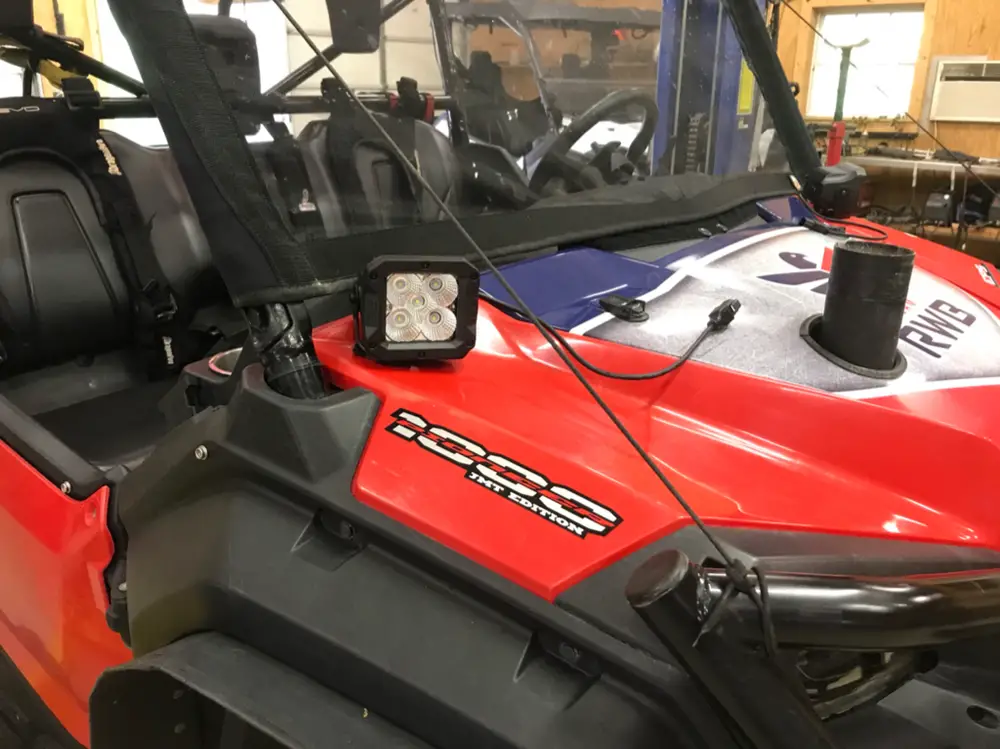

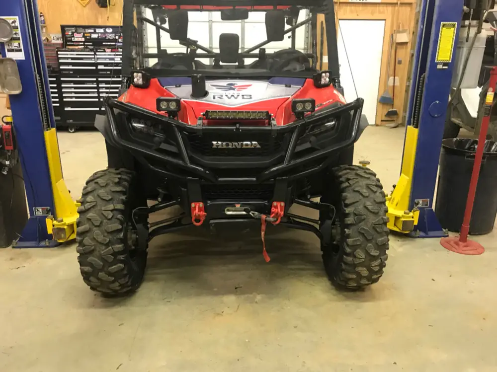

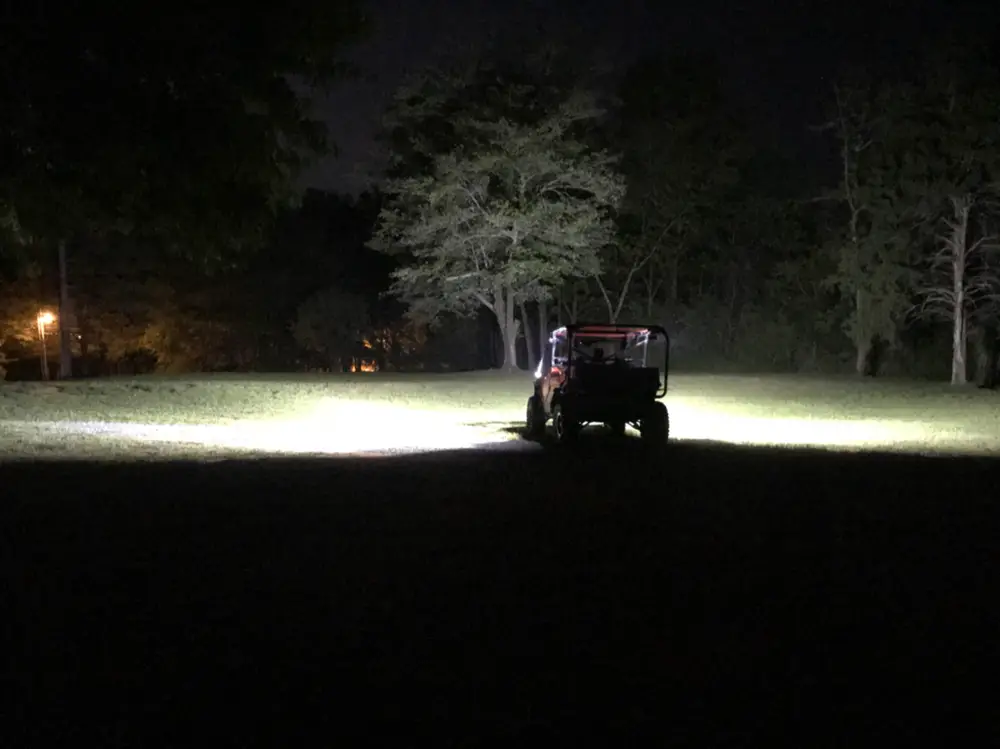

An update for the lighting. I’ve noticed that I’m low on power when night riding. The alternator can’t keep up with all lights and the stereo so I’ve decided to reduce the wattage to the lights and try to get more efficient with quality and aiming.
I ended up removing the 40” bar and added some smaller rough country lights. I reduced the total wattage 116 Watts. These I’m now using 5 smaller lights up front to aim where I want them vs the 240 watt bar. I moved the side lights to the back like others have done.
One important thing is the front lights are on two separate circuits so if there is a failure I will only lose half the lights instead of all of them.
Here they are. 3 floods and two spots

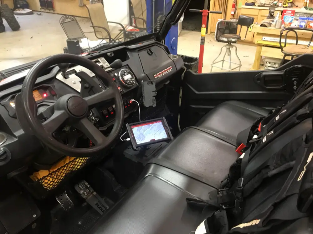

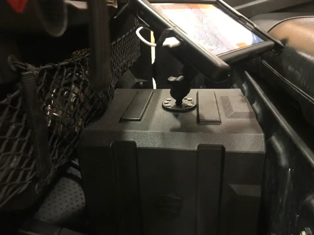

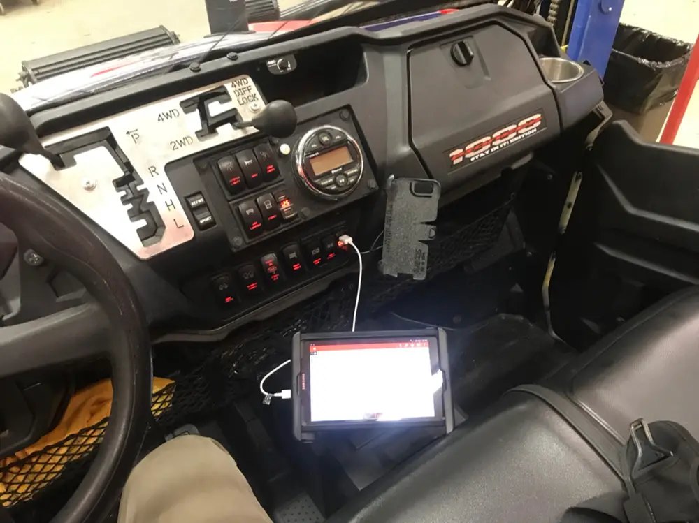

I also mounted the Lifetime trail maps tablet. I put it in a RAM mount and a water resistant case. I’ve got two locations, one on the sub and one up high next to the sound bar. It will stay low unless I need the middle seat. With the chopped top it puts it a little low in front of my face. To move it, it’s just a thumb screw and I’ve got a RAM ball mount in both locations.
I still don’t know how to use it very good but I’ll try it this weekend if we don’t get rained out.
Looks good ram mounts are the best we have one on GPS for tractor how well does usb charger keep up ?
Reactions: sharp and Ragnar406
39,130
The usb chargers are 5 amp rated. It easily charges my iPhone and the tablet. I’ve got two of them on the dash and one in the glove box!
39,130
Oh and the RAM mounts are great. I used the aluminum version instead of plastic just in case we flip again. I don’t want the tablet to go flying.
1st one I put in was a around one 2amp and 1amp couldn't keep up two phone's turd . Took it out put in accessory plug put in car charger it crapped out in 3 hours (car charger)

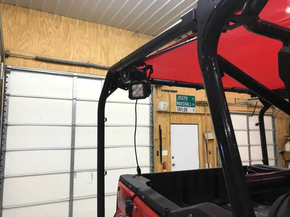

What are the other two lights you have on your number here on either side of your light bar? Did you take those off?
Also cool that the WS tech called you to try and find out
39,130
The little lights are MicTuning brand. I’ve been running those for a while and I’m satisfied with them. Here’s and old pic of them.
