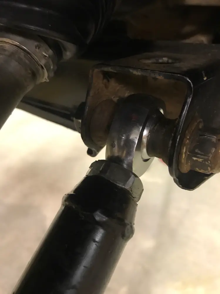

And lastly, I’m going to be adding some suspension limit straps on all four corners. I know that there will probably be a lot of people see no use in this and make fun of me but after talking with @snuffnwhisky about some issues I was having it looks like I need to limit the suspension travel. It will just look funny to some people that I have limit straps on a rig that’s not considered a sport model.
I have the inner CVs come apart sometimes because I have too much droop and it is breaking the snaprings. Sometimes it pulls off the boot. Also the suspension droop is limited by the axle which is probably why I have two warped axles. The CATVOS Front arms have too much droop. And the rear arms I made my own lift which gave them too much droop.
So I’ve got some hardware and straps on the way. I’ll Update soon with those parts come in.
