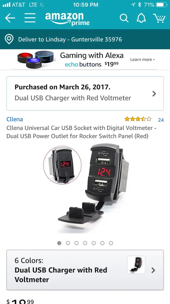

1st one I put in was a around one 2amp and 1amp couldn't keep up two phone's turd . Took it out put in accessory plug put in car charger it crapped out in 3 hours (car charger)
I would have thought these were junk but they’ve been good. 4.2 amp rating, not 5 like I said earlier.

Might need to upgrade
I’ve already lost the dust covers. They fall off. It been rained on and washed with a hose after every ride and they still survive. The $500 MARINE sound bar didn’t though!
It shows output to your phone in amps while charging. That kinda stinks if you want to monitor voltage. It will switch back to voltage when it’s low but I can’t remember at what point. I think I was 12.1.
No biggie have two other volt meters

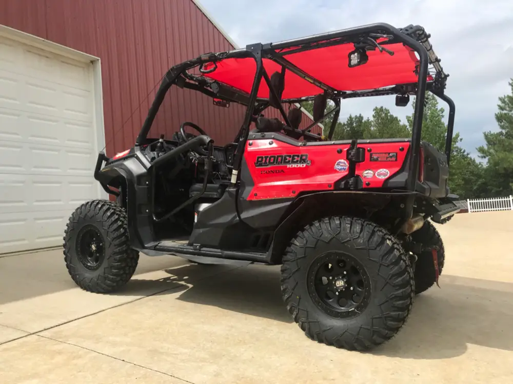

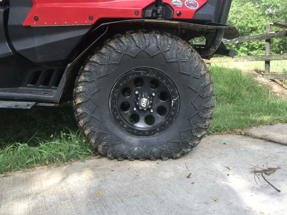

Tested out the clearance of the new tires. When tires are turned straight there is no rubbing.
Bed2412bd6e5a308cbe83d00b20e6955
5791bf0b94d3e03ed952177521eac2d2
F5a37189eb174717539c632661e7a52b
The tires measure exactly 30 inches tall under the weight of the vehicle with six PSI. All these pictures were taken with six PSI in the tires. Not sure how well that’s going to do on the trail but I will test six out this weekend and go up to eight if I feel like I am running the risk of a pinch flat

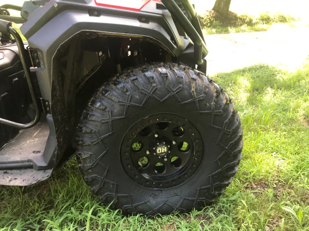

When turn to full lock the tires are very close to the skid plate and look like they will make contact under suspension compression. I’ll try it out this weekend and trim it if it bothers me.
I didn't try it on rocks, but mine didn't perform any better at 8psi than they do at 14. I run mine at 14 on and off the road. May drop them some to test on rocks Saturday.

I’m super pleased with the tires and here’s a quick summary comparing 32” Terrabites to 30” Roctanes.
At 6psi they ride AWESOME and don’t even look under inflated. With camping gear and heavy loaded in the back I should have adjusted to 8psi in the rear. I knew we would be going slower. If I were going to be on some faster trails I would inflate them more.
Seem to grip rock better than the Roctanes.
The sidewalls are thinner by a little bit.
They tread contact is one inch more narrow.
They are the same weight or maybe a pound less than the 30” roctanes.
The vehicle is a little looser feeling with more sidewall and less pressure.
They rub just a little bit when compressed and turned. (I have 2” forward arms). I don’t feel like adding any more lift because I want stability. Therefore, I will deal with a little bit of rubbing.
I gave them a thorough inspection and they took the abuse of Coalmont very good.
Mud performance isn’t great so more throttle is needed.
I did not notice any power loss coming from the 30” Roctanes.
