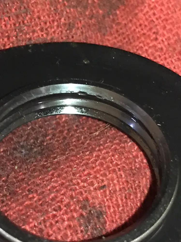

I noticed an oil leak in the rear diff so I changed the seal. This was also the passenger side....strange.
7bbe4b3d9bd28c30b56351745acdd43a
Around the top of the oil seal in the picture you can see the deterioration where some of it had chunked out.

On funny thing I noticed, I pulled the seal out of the rear diff and there was no sealant on it. I didn’t have a new seal so I pulled on from the old diff that was broken. That seal was glued in with sealant.
I did both seals when i rebuilt axles. Neither of mine had sealant.
