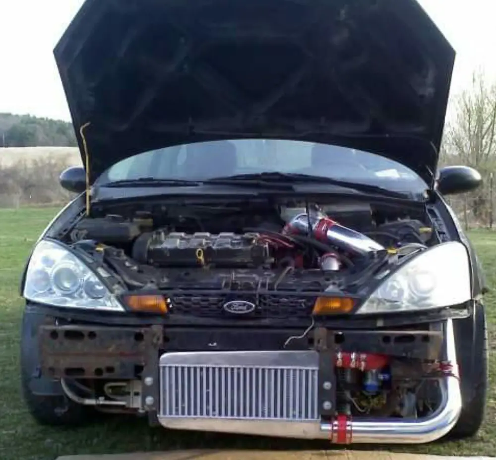

i know all about piping with no room lol thank god for boxes full of pre bends lol
