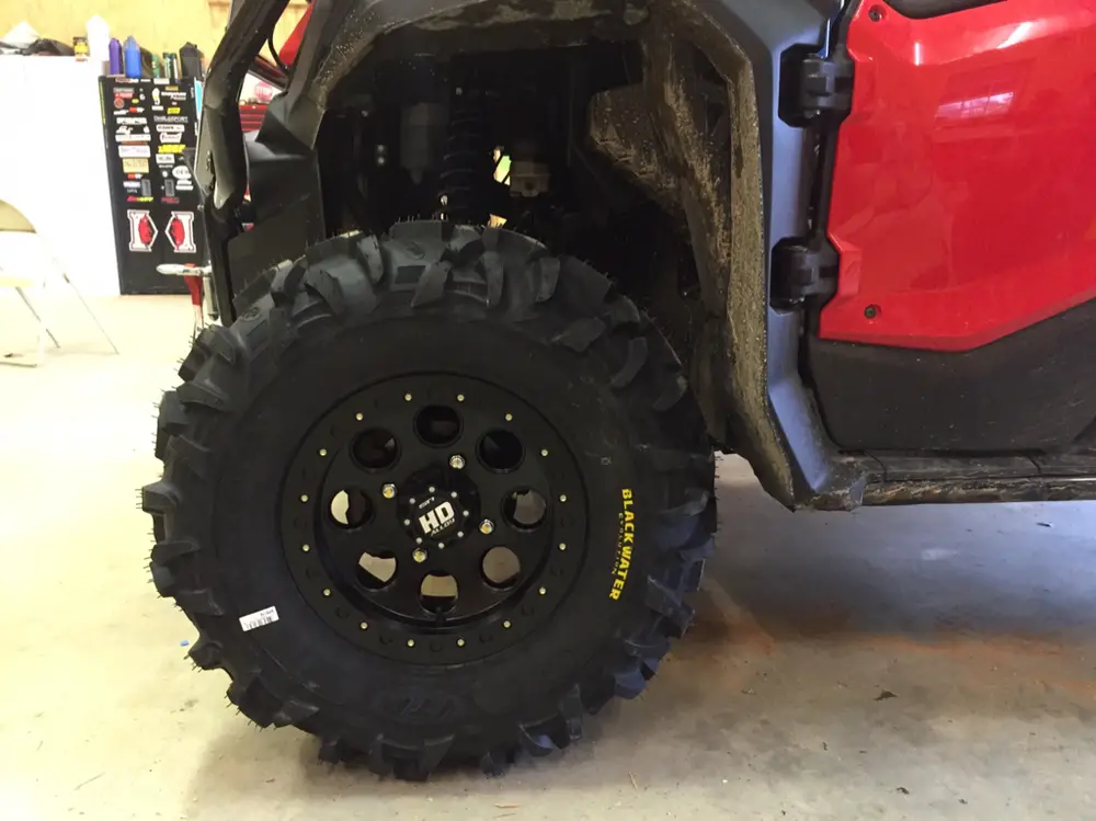

Here's a pic of 30" EVOs which are just under 29". This pic was taken with stock a-arms. Also 5-2 wheels.

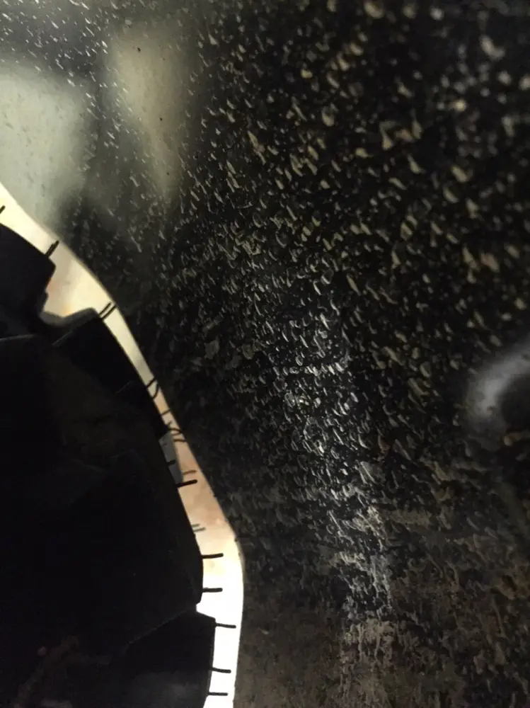

View on the inside with tire turned.

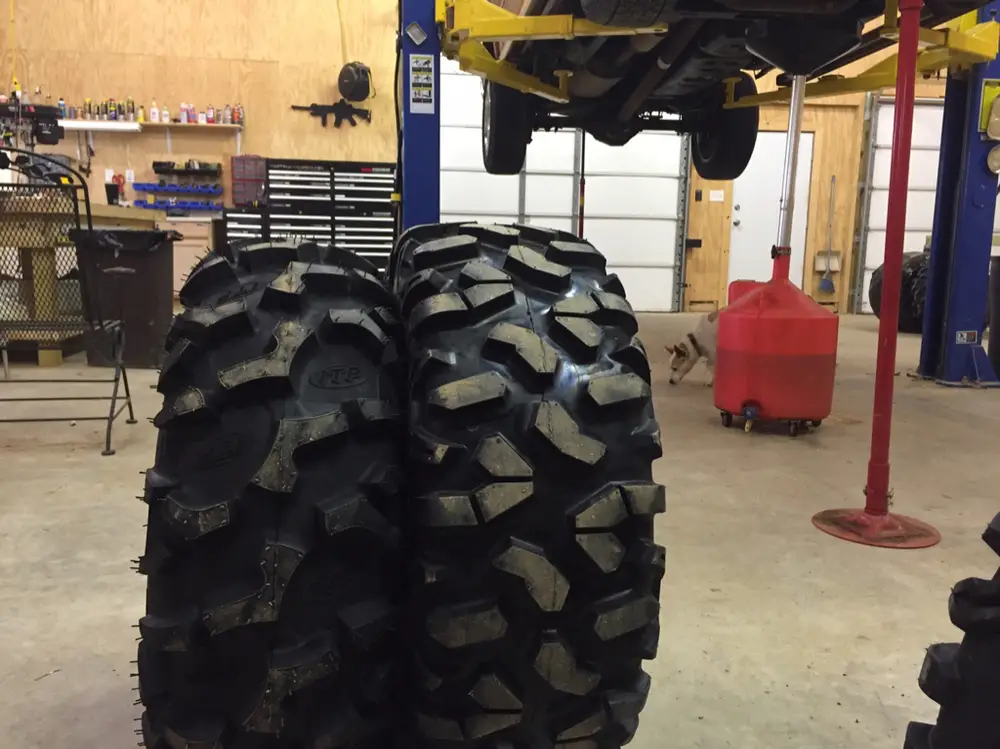

Now earlier I said 30" Roctanes wouldn't fit. Here's why... 30" Roctanes next to 30" EVOs
26bbdf955bcbc9bfa54c15849dd8c507
39,129
I see... kinda.
But in short... even with a lift a 30- actual 29" tire will most likely rub under compression
Yep, that's what I'm afraid of. Skid plates can make it worse too.

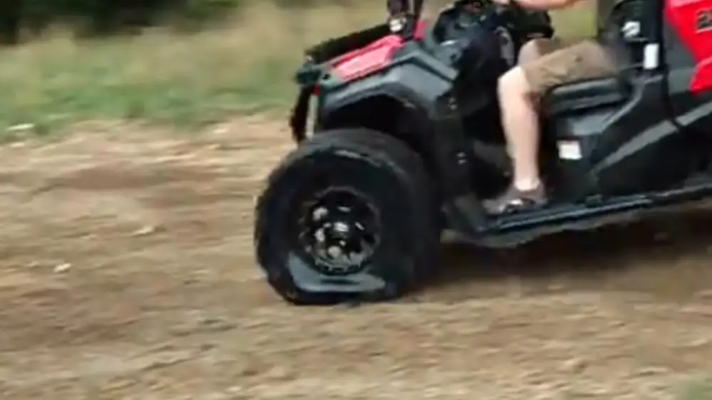

Hard landing with 30" Roctanes. Oem springs, 2" forward CATVOS arms with advertised 3" lift. It wasn't a true 3" lift. Maybe 2" at best.
737d904cc3fc11be74b94120b418120c
Not sure if all this will help anyone. But what the hell

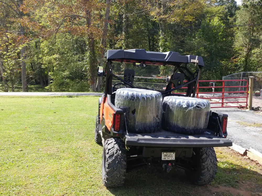

Just got back from the shop, and had a great 5 mile trip home on the 40 mph hwy. Nice! Feels more like a small car than a UTV on the hwy. The steering is nice and tight, no fishtailing, and these tires can take a turn. I also went up our steep gravel driveway, and didn't notice any tire spin. The gravel is packed right now due to rain, but it still felt better going up. Liking them so far.
