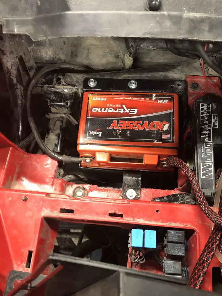

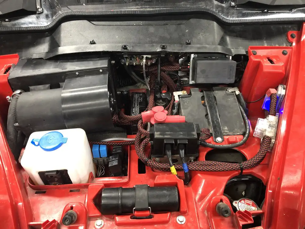

This Fall I finally decided to enclose the cab of my 2016. Found this thread while researching heaters, figured why not give it a shot. Price and keeping the heater dry was my main concerns. Here is what I ended up with.
Summit Racing heater mounted under the hood. Thanks OleRed for that Idea. Had to cut some plastic to get it where I wanted. IMG 0393
All the typical mods are still mounted under the hood: Busman PDM, True Am isolater, Stinger relay, Oddysey battery. Cut the out the plastic where the 2nd battery was installed and made a steel tray to lower the battery so the heater would fit on top of it.

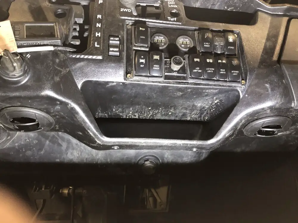

Mounted 2 vents on the lower part of the dash. They will turn 360, so you can aim the flow at any part of your body.
IMG 0389

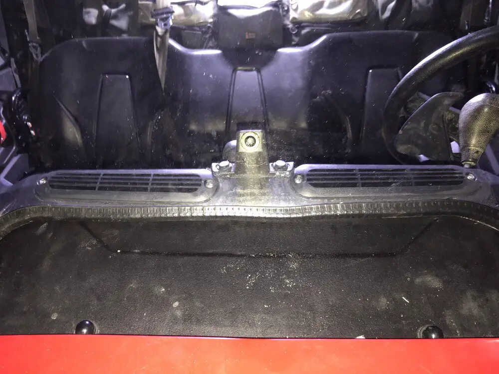

The hardest part was trying to get real defrosters. Ended up taking the dash out and boxing in the space Above the upper dash pocket and drive modes selector. Air is feed from the passenger side of the chamber. While I had the dash apart, I added some thin rubber sheeting and foam to completely seal up the dash. Sorry, the plastic welder was frustrating and I didn't take and pictures while I had the dash apart.

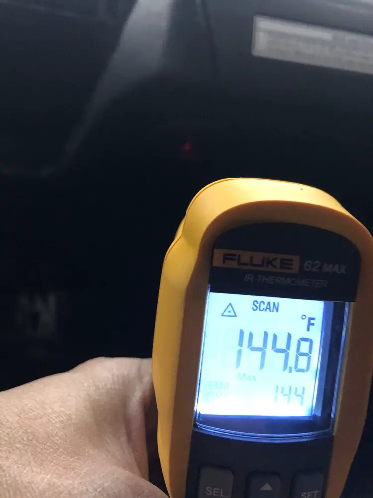

All the duct work is short and contained within the sealed dash. I lose a bit of heat between the oil cooler and heater core, but still get 145 degree air at the vents when the engine is idling at around 200 degrees.

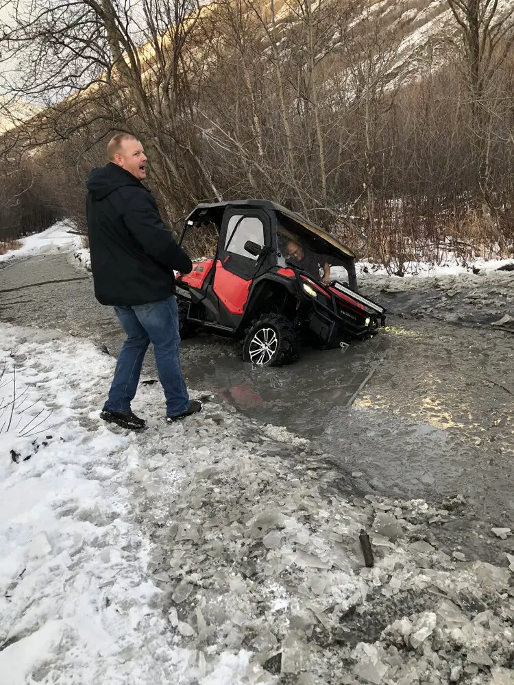

Here is why I wanted a heater mounted up high. This part of the trail was a bout 2" deep until the end.
IMG 0446
Same area, different weekend.

What'd you use for the defroster vent?
I like it and am interested in trying to do it myself.

AK,
I bought the defroster kit from Summit, but only used the grill part of the vent. I cut holes in the top of the dash and mounted the grills with a couple screws and sealed it up with some black RTV. I created a chamber in the dash with an inlet for the heater hose. There isn’t enough room there to run hoses directly to the defrost vents.
