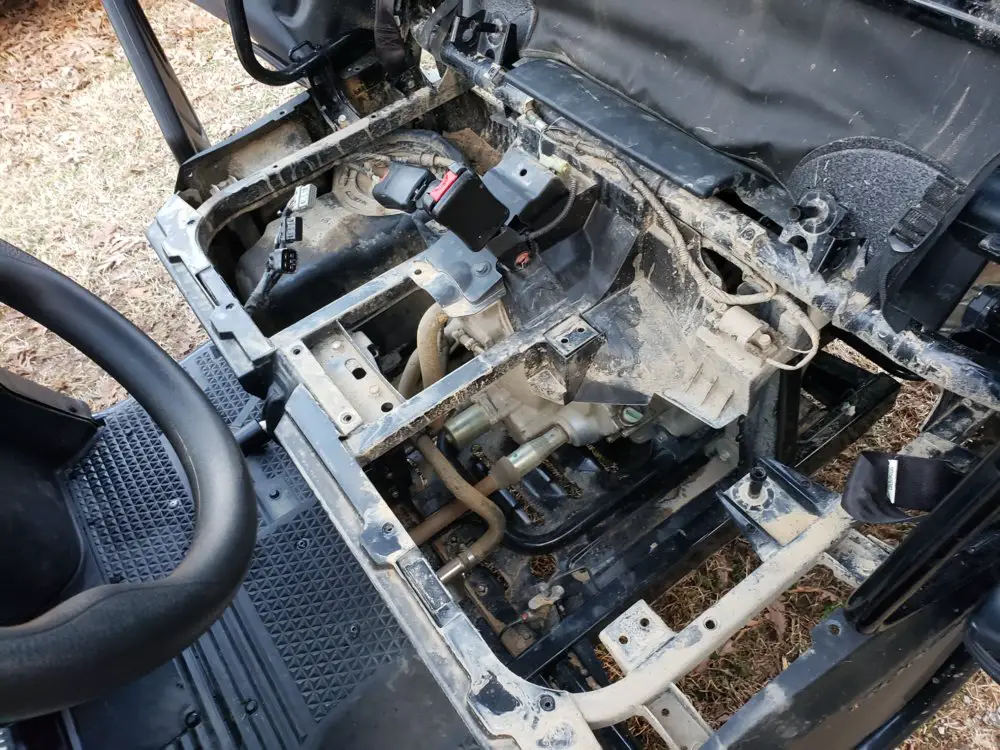

Machine was just serviced at the dealer but I'm like you I will replace every fluid that way I know that it has been done. I have almost 30 years in aviation. It has made me over inspect and over maintain all my toys. Already cleaned and inspected the front. Getting started on the middle section.View attachment 98195 View attachment 98196 View attachment 98195 View attachment 98196

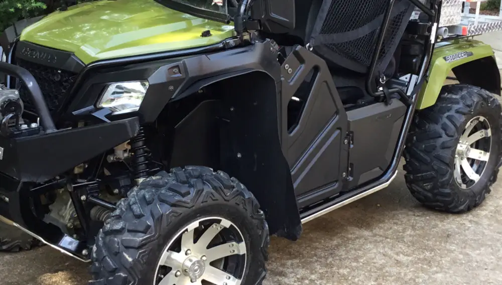

@TJoffroad , FYI, about the dents on the frame under the door, here’s a pic of the rock sliders and skid plate. Don’t know if that will cover your battle scars along with better protection.

View attachment 98237 @TJoffroad , FYI, about the dents on the frame under the door, here’s a pic of the rock sliders and front skid plate. Don’t know if that will cover your battle scars along with better protection.
I do like those and the UHMW ones also. I'll be purchasing one of the them. Your picture has a better angle than the website pic. Looks nice and tight. That's one clean machine there. I like the UHMW one piece for the purpose of a one continuous slide if you get on a rock. I like yours for being modular and they appear to shingle so you can't snag an edge on a rock. And you would only need to remove the one piece needed for maintenance and not the entire piece. I'll do some more investigating. I'll look around at my work also. We use alot of UHMW and delrin. Maybe I could find some scrap pieces to make my own. Thanks

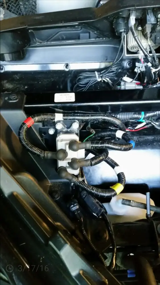

Speaking of mods/add-ons, do you know if it is possible to fit your glove box, winch relay,power steering and a heater under the hood?
Reactions: Chooglin
C
Chooglin
I don't know about the heater but everything else will fit under the hood.
You will need to move your winch contactor , if it is located in the factory position. It's not that hard to do , this is where I mounted mine.

Can't view the attachment. I get an error code sorry. Buy yes my contractor is mounted where the glove box mounts.
Reactions: Chooglin
Went back out and came back in. Now the photo loaded thanks. I'll relocate to the same place

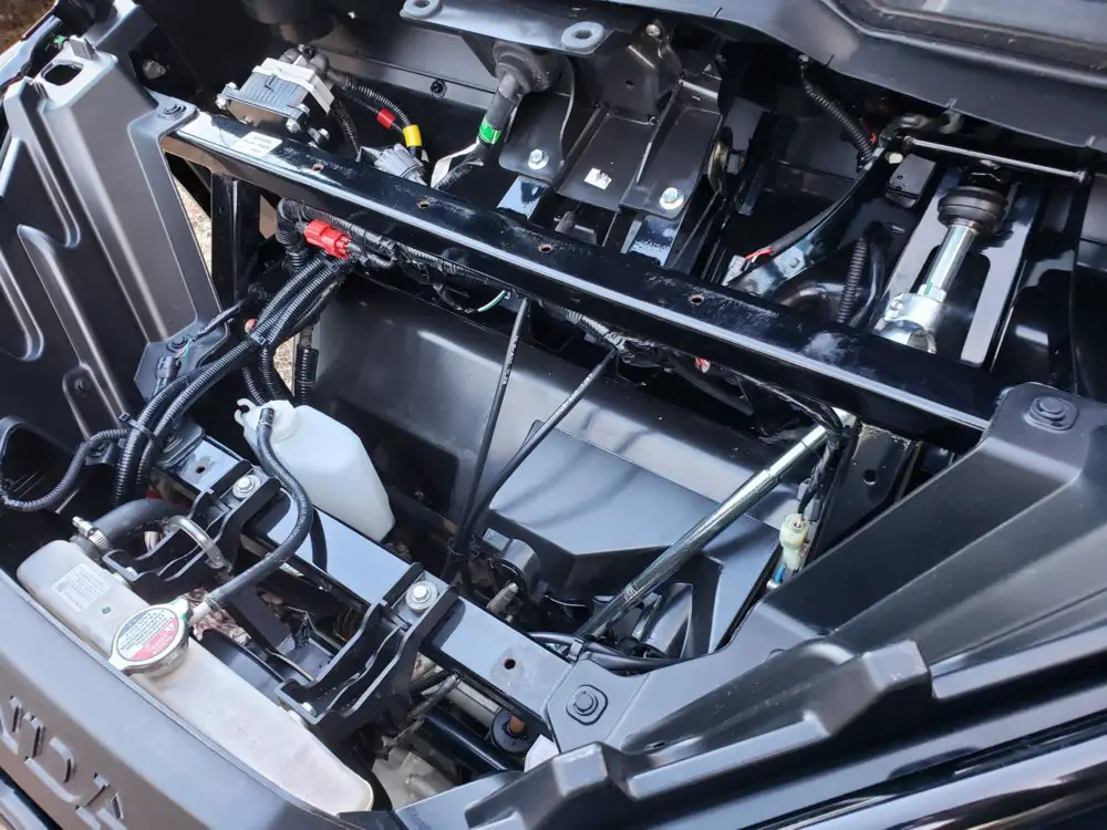

Can get filled up quickly. You can judge available space on left from looking at the silver top of the power steering unit at the bottom of pic.
