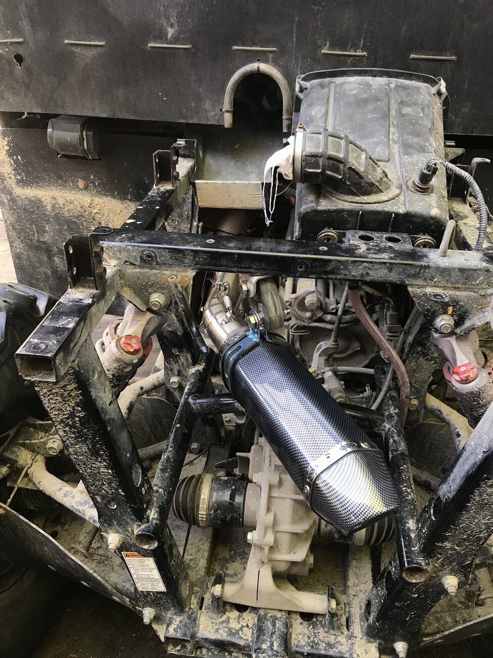

Little clean up yet, trim off the stock hangers with zip cut and reassemble. This muffler was retrofitted from a 2015 Honda foreman, comes with a short slip on pipe I didn’t use. Previous to this I had removed the cat, ran a short extension of 2” OD stainless to an aftermarket short LOUD muffler. Finally got round to this one which is a slip on that slides onto the 2” OD pipe. Only idled so far seems quieter and deeper toned.
Big Gun Exhaust 07-1272 ECO Utility Silver Slip On Exhaust for Honda
Removed muffler View attachment 308060
0136FD3E 636E 42AF B3F4 AA34AE0675EB
Ready for the wild… was kinda fretting how far it would stick out, fits good. Sound wise much deeper then other one for sure. I’ve really only idled it though, currently storing at a buddy’s property and he is using to plough snow. We nearly had to leg wrestle for who would plough his place…. Hahahaa left him at it.
