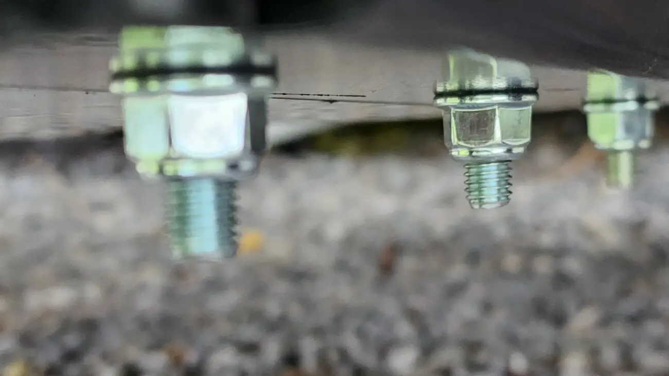

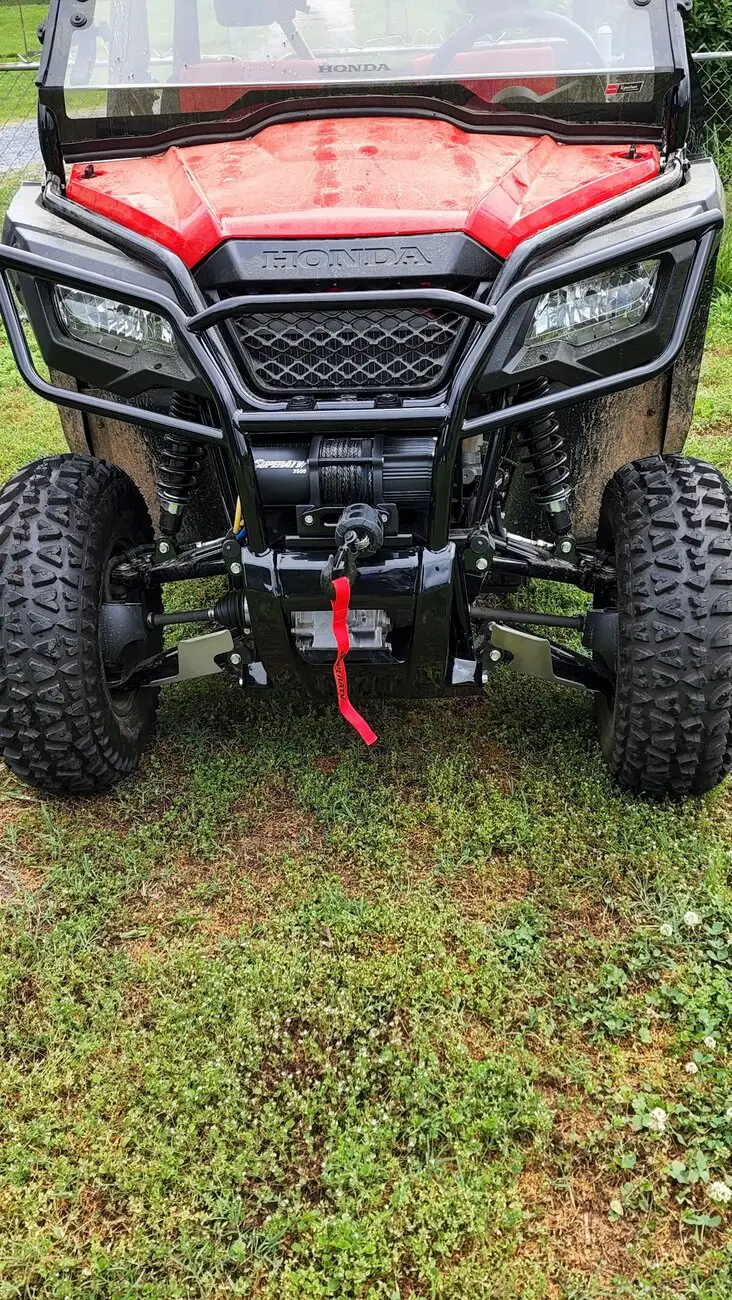

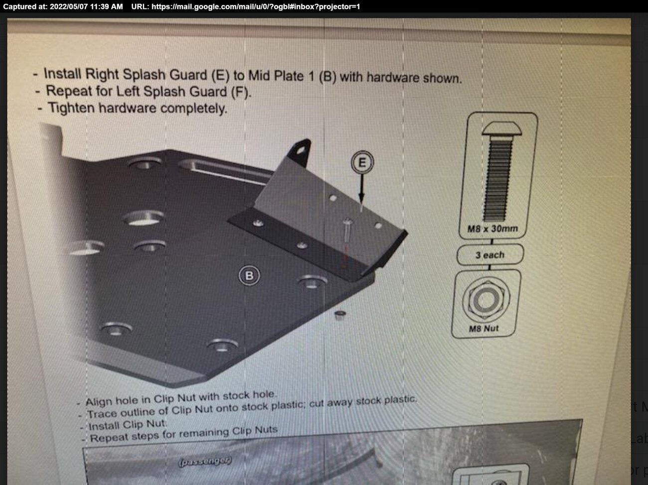

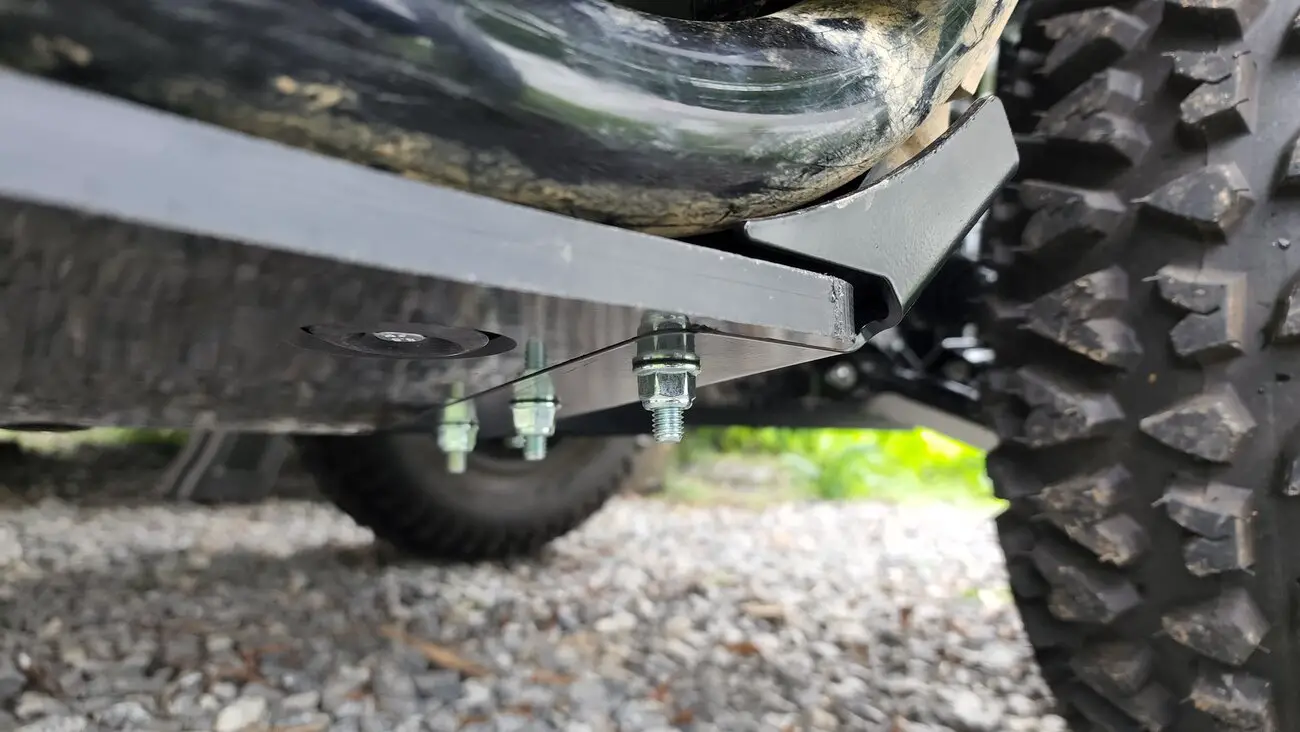

Got her back from services. Happy with both front and rear bumpers and arm guards, happy with superatv 3500 winch install and very handy quick release bed rails. NOT happy with superatv full skid plate installed as per instructions 6 bolts stick below skid plate 3/4+ in. directly behind front wheel, obviously a big problem...20220507 101232 resized20220507 101212 resizedInbox 4 521 waynester58 gmail com Gmail20220507 103005 resized20220507 103023 resized20220507 103126 resized

Got her back from services. Happy with both front and rear bumpers and arm guards, happy with superatv 3500 winch install and very handy quick release bed rails. NOT happy with superatv full skid plate installed as per instructions 6 bolts stick below skid plate 3/4+ in. directly behind front wheel, obviously a big problem...View attachment 333121View attachment 333122View attachment 333123View attachment 333124View attachment 333126View attachment 333127
Can the attachment hardware be installed reversed? Can the button heads be installed on the bottom side?
My StrongMade stick stoppers have the same condition, U bolts that come from the top. I cut the remaining threads off with an angle grinder.
X2. Can you get a socket wrench above the skid plate? That’s a recipe for problems as-is. I’d rather not have the nuts projecting with a shorter bolt. Send a picture to manufacturer and ask whiskey tango foxtrot.
