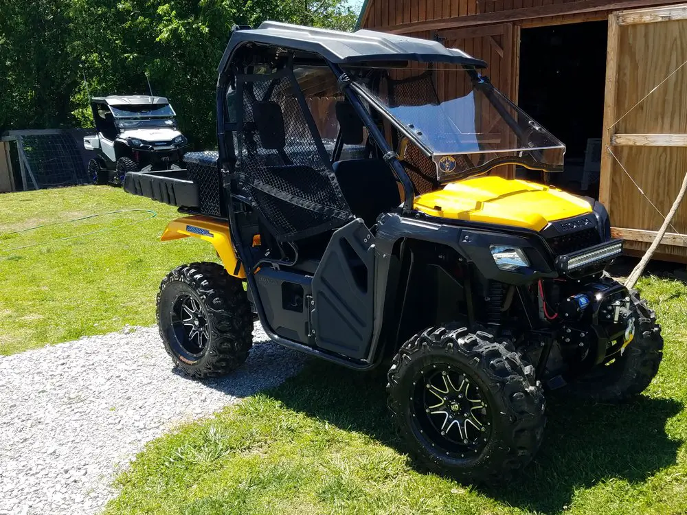

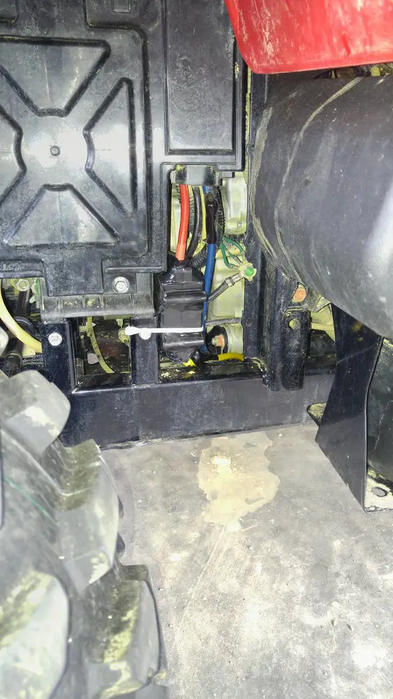

Got my Terra 35 wired up and working. Was an easy install. Hardest part was routing the cables under the machine. I loosened the passenger side skid plates or I would have never got them thru.
I'm a little worried about the circuit breaker. Its in kinda a vulnerable spot next to the battery box. Also not sure how dunking it in water will work? I wrapped it in electrical tape and zip tied it. Need to find a longer cable so I can move it up to a safer place.

View attachment 42820 Got my Terra 35 wired up and working. Was an easy install. Hardest part was routing the cables under the machine. I loosened the passenger side skid plates or I would have never got them thru.
Is that a circuit breaker or the solenoid? I mounted my solenoid under the hood, you'll want access to a circuit breaker if it trips.
It's the circuit breaker. I put the solenoid under the hood in the factory location.

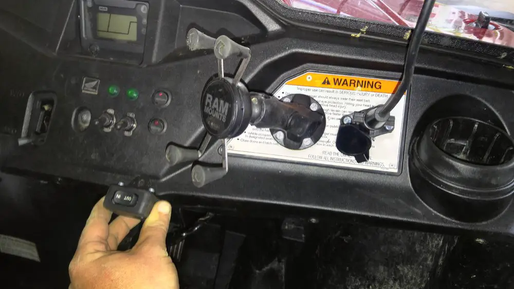

Well, I couldn't stand it no longer. Has to go out and swap the breaker to under the hood. It's up and safe now. Now all I like is mounting the rocker. Thinking about in the middle to the right of the reverse lever.
0506171512
26,730
196,373
Well, I couldn't stand it no longer. Has to go out and swap the breaker to under the hood. It's up and safe now. Now all I like is mounting the rocker. Thinking about in the middle to the right of the reverse lever.View attachment 42834
That's where I put mine.
I put mine under the driver side cup holder so you can operate it standing outside and see what you're doing.

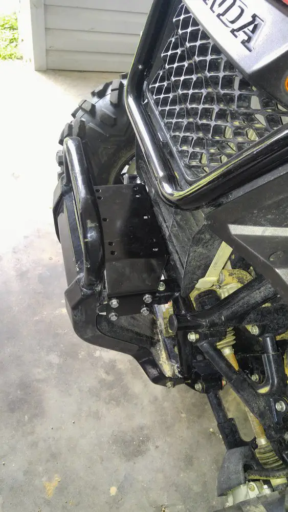

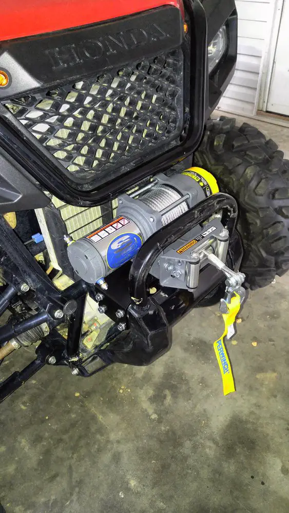

Mount and winch arrived today. Got them mounted up. Hope to wire it this weekend.View attachment 42687 View attachment 42689
Has anyone had any issues with overheating after adding there winch here in front of the radiator? The KFI mount seems pretty popular, so I'm guessing it will be ok?
Haven't heard of any...over heating because...
of that placement. I know those in muddy/wet areas
choose that as a placement. COG..the winch works better..
lower to ground...but if it's in the mud/water...hard to get to....
.....6's either way...I guess
IMO
