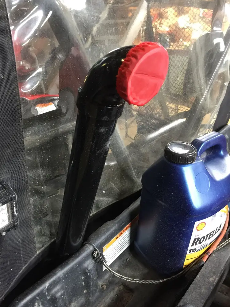

Finished my snorkel finally. Here is my material list:
1 - 2" PVC 90
1 - 2" PVC Street 90
1 - 2" x 1-1/2" Fernco coupling
1 - 2" x 24" piece of PVC Pipe
PVC glue and primer
Primer and paint
Outerwears part number 20-1311
Pipe strap (to hold the pipe to the front rail of the rack for support)
If shorten the bell of the 90 degree fitting by about 1/4", the outerwear bootie will fit the opening perfectly.
1 - 2" PVC 90
PVC glue and primer
Primer and paint
Where are you getting that outerwear bootie from?
