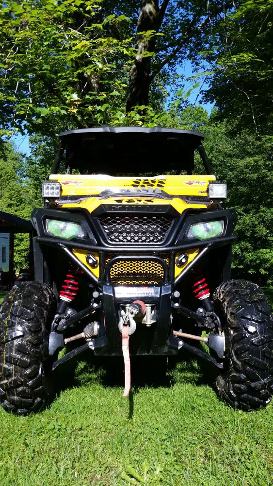

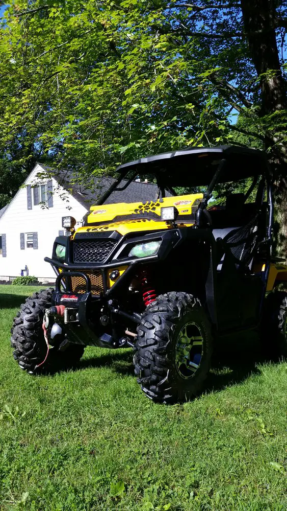

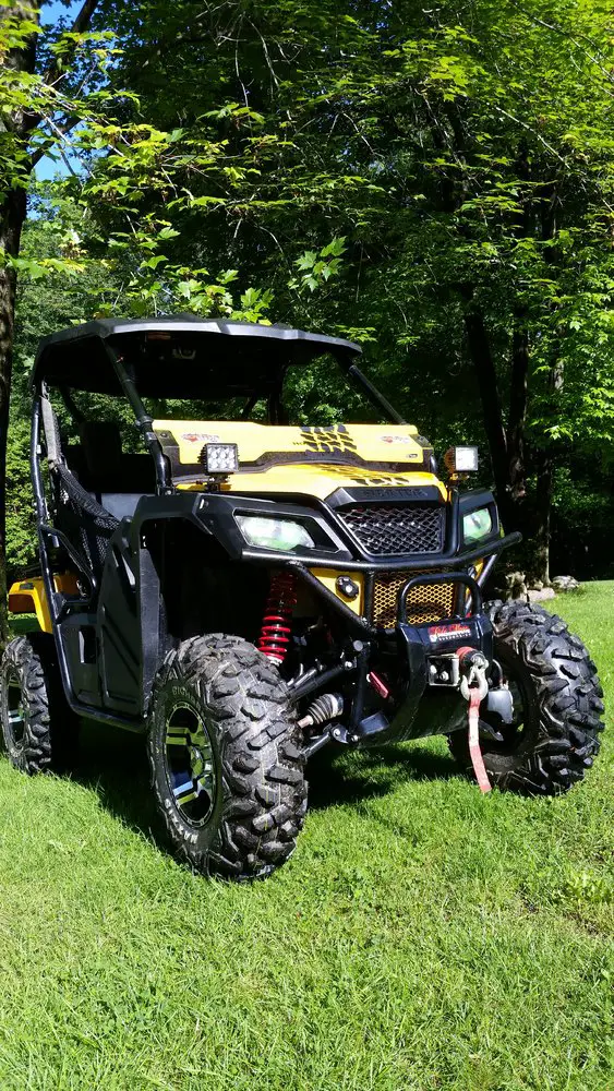

Painted the middle section of the bumper yellow. I have been thinking about doing this for awhile now and finally went ahead and did it!

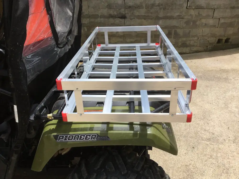

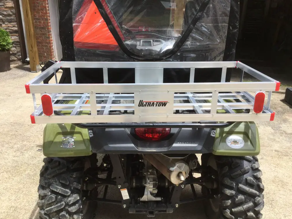

Just installed Cargo carrier, 1/2 off price at Northern Tool $79. Left off receiver hitch piece, good fit, 49x22 1/2. Should be easier to wash out the mud. Next job is to cut a tailgate option on the first wooden box. It never ends....
View attachment 45584 View attachment 45585
I like that! I have that carrier sitting in corner of my barn and hadn't used in several years. Now I have a use. How did you attach to bottom frame?

@32lakes , for permanent mount used two hex head bolts midpoint and into the flat rack frames, but very tight fit to get a wrench underneath, but this looks the best. I should have tapped some threads to eliminate the nut underneath. Likely to remove those and just use squared u bolts on outside edge, with nuts on bottom so I can more easily change it out with my other wooden box when needed. Already had sticky weatherstripping strips on frame for rattle and paint protection.

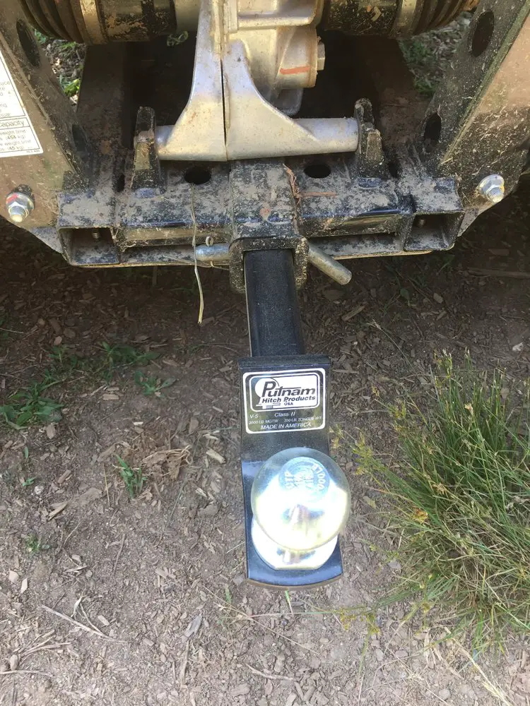

I got her a new trailer hitch in the event I need to tow something or use it as a clevis or D-ring as a rear attachment point for recovery purposes. What size TOW balls do you use on your hitches?
If you are towing a goosenenck trailer you will need a 2 5/16" otherwise you need a ball that is the size your tounge hitch requires. I had to put a 5th wheel plate on my P5 for my towing needs.

If you are towing a goosenenck trailer you will need s 2 5/16" otherwise you need a ball that is the size your tounge hitch requires. I had to put a 5th wheel plate on my P5 for my towing needs.
I've never seen a gooseneck trailer for a Pioneer.
