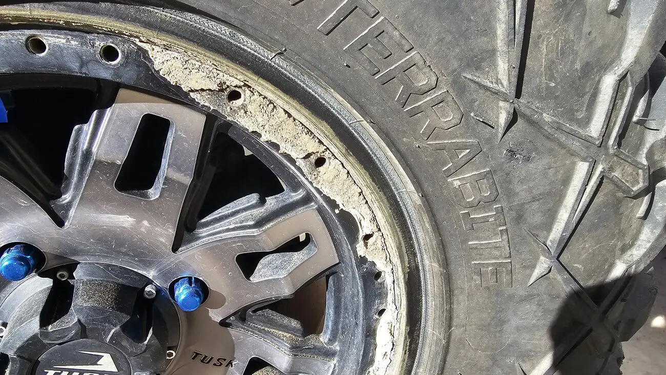

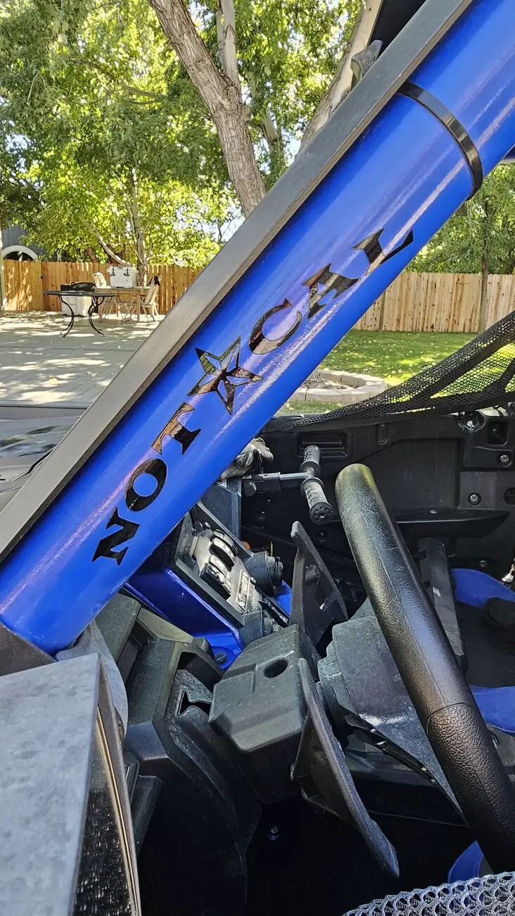

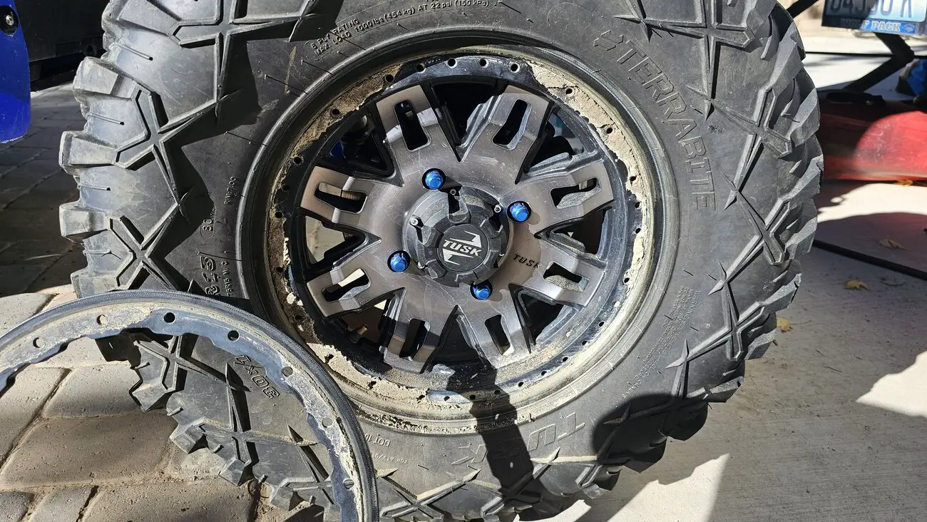

I was losing air slowly in 3 of 4 tires so today was pull the rings, clean out the dirt, and retorque. What a pain! The one in the photo wasnt even the worst one. The machine came with beadlocks; I don't know if I'd get them again. And a new sticker.View attachment 405789View attachment 405790View attachment 405791
Terrabites are a great, long wearing tire but, due to inconsistencies in bead thickness on individual tires, don't play well with beadlocks. It looks like you got 3 out of 4 with that problem. That's the only reason I'm not running them.
The clean sections on the circumference show where the bead was probably thinner, the BL ring bottomed on the rim before getting the needed pinch on the thin bead. That's my guess.

I bought a set of terrabites mounted on sti wheels from rmatv. Checked beadlock torque before putting them on the machine, some of the bolts were barely finger tight. Hopefully you fixed your problem, mine never would seal. Sold them cheap and moved on.

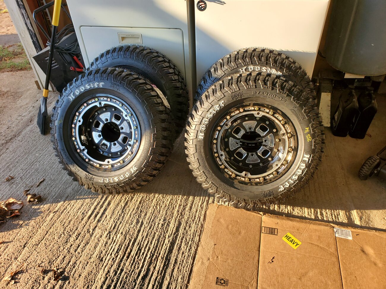

Getting the car ready for the Mid America race at the end of the month.....
New 27" Hoosier Bites

Those look to have more tread than you usually run, care to tell us what's up?
I'm going to race at Mid America Outdoors in Oklahoma next weekend for the first time ever. Their dirt is nothing like the clay we have in Texas and the dirt track tires I normally run don't work there. These Hoosier Bites are what all the fast guys run so I figured I'd get me a set to try out.
