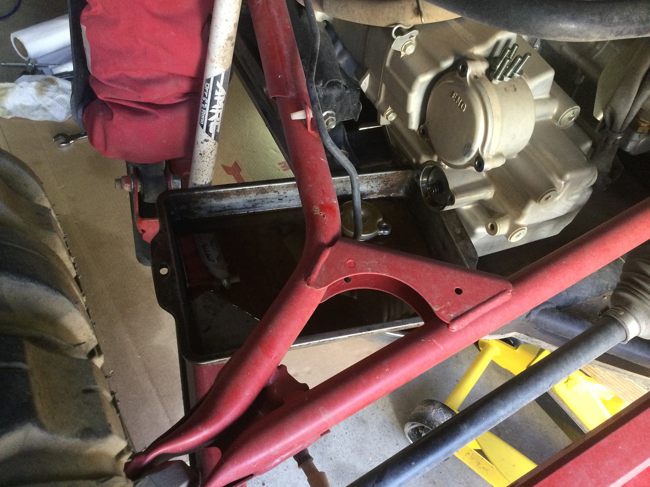

That's pretty cool but it does raise a question - I get 2 or 3 cups of oil draining out when I pull the oil filter cover off, how do you get that trapped oil out of the engine now that it can't flow downhill? Still pull that new cover?
My setup to catch the oil when I pull the cover.

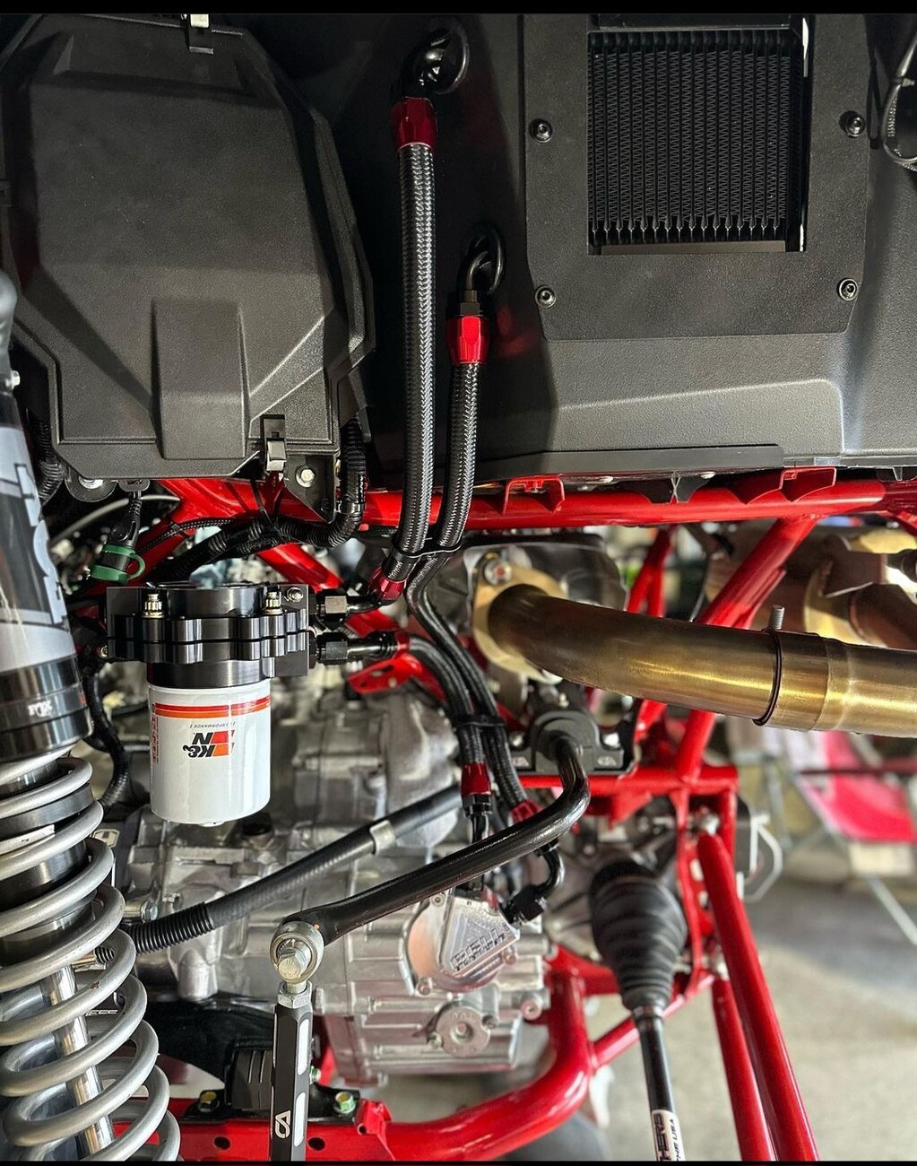

I would say, yes, still pull the cover @ oil change.
I see this as something that helps you avoid fighting with the OEM filter and O-ring and, more importantly, provides the means to run an external oil cooler and/or oil filter, the latter you could change in a few seconds without changing the oil if you so choose.
You can replace the stock oil cooler with an adapter from an R1 and run a big cooler from there. That's how mine is plumbed. With the Bell adapter in place you have no choice but to run an external oil filter because the adapter takes the place of the stock element.

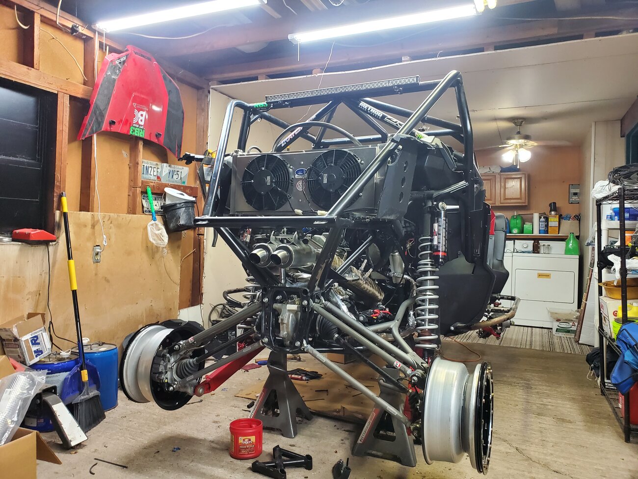

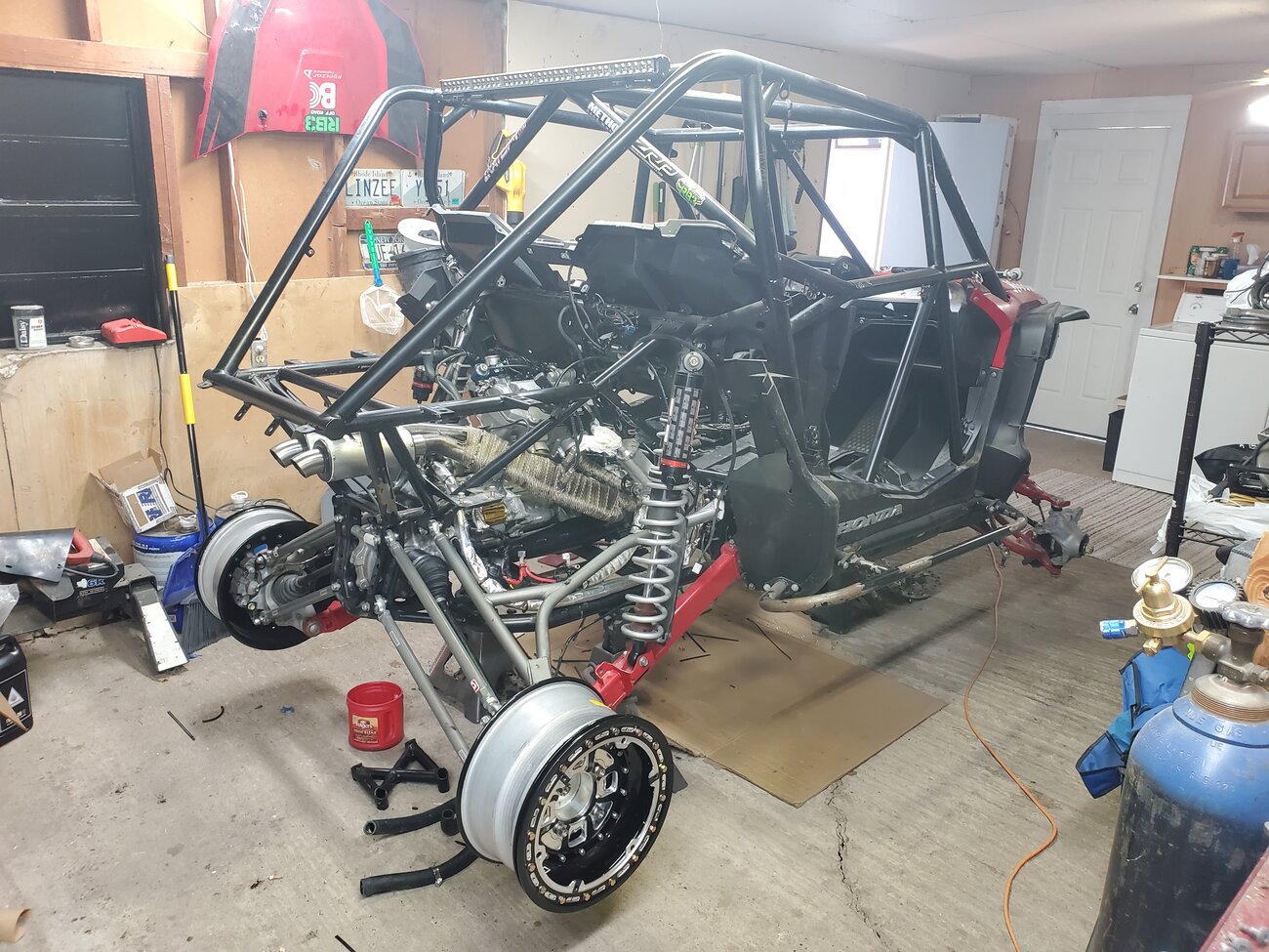

Put the engine in, got the driveline installed and then put the rear suspension together so it actually looks like something again....
20230827 162141
20230827 221634
20230827 205148
20230827 224350
Couple days worth of work and a break in tune from PPEI and this thing should be running again!
