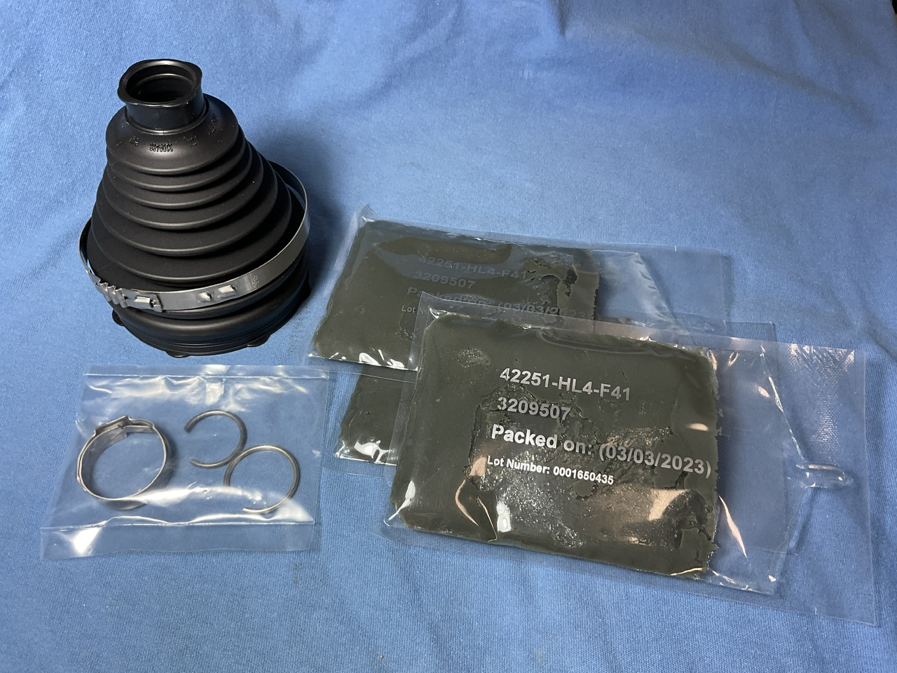

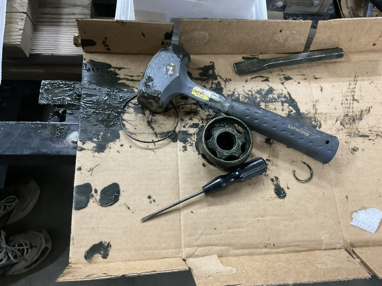

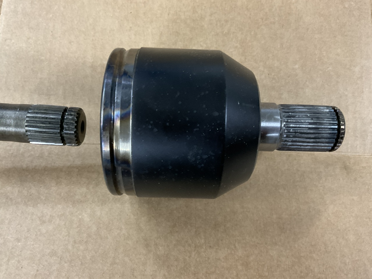

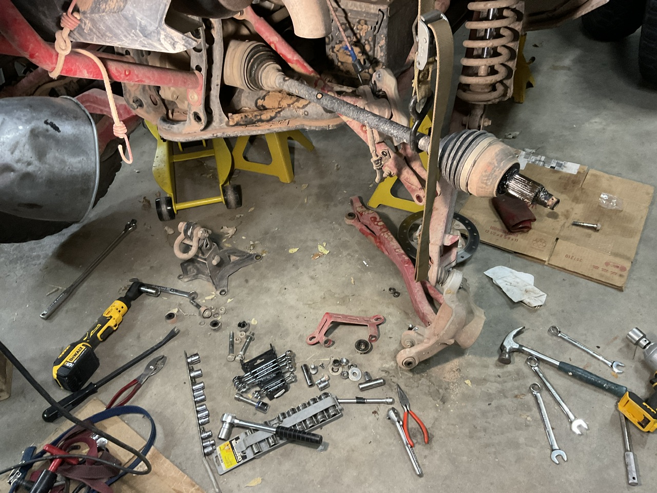

Got bound up under throttle and popped another CV, my second; this one at 12,923 miles. :( That didn't incapacitate me but the boot was also spitting grease previously, so it had to be replaced anyway, replacing the CV itself was a no brainer.
IMG 0861
Icky job -
IMG 0863
There are two circlips that have to be dealt with -
IMG 0866
I don't have the necessary 'pliers' to cinch the boot clamps so I pay my dealer to do that. The 'proper' pliers are ~$300. :oops:

search stretchcvboot if ya are interested in band clamp tools and bands for cv joints, etc. - its the concept I found quickly - motion pro makes the clamp kits and pliers as well - not sure why the honda clamp needs Hercules to set the clampl .... - I have used the band clamp tools, 1/4", belt and buckle type - best yet if ya can swing by the shop, walk in the back, set then bands
I will say it takes practice, actually reading the instructions and practice, did I say practice... replaced many cv boots on friends machines/my machines - el cheap o here -

I have used worm gear clamps from ace hardware on the inners

I've seen several CV boots held on with safety wire instead of clamps.

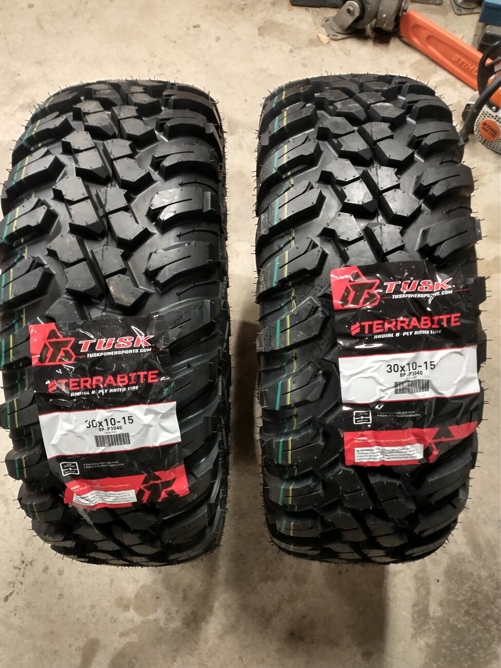

I'm happy with my Tusk Terrabites. 4500 miles and they are about 1/2 worn. We run into paved roads frequently when riding on ATV routes between trail systems in Wisconsin
Did you go with the 8 ply or 10 ply terrabites?

I went with 10 ply Aramid Terrabites. I wanted as much sidewall protection as I could buy as the only two tire failures I have experienced on my previous Honda Pioneer were both sidewall punctures
