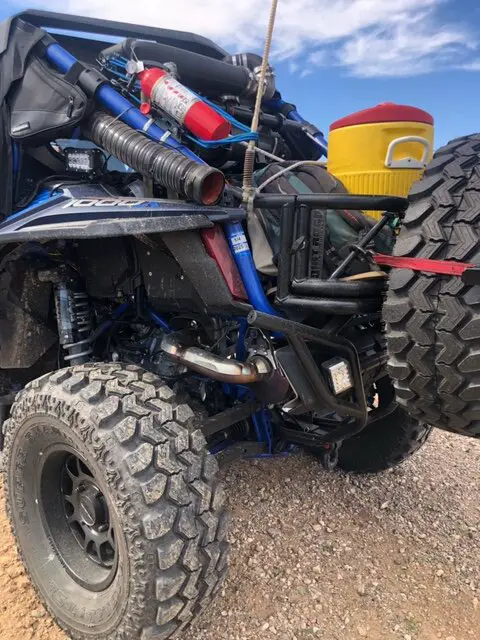

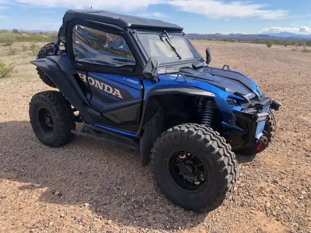

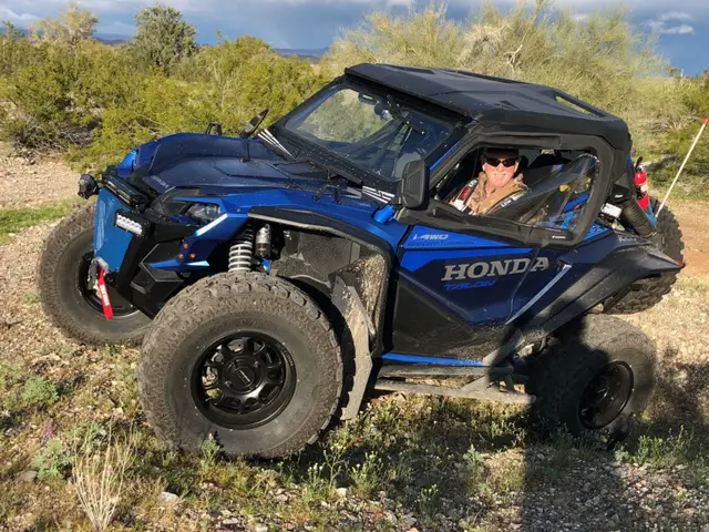

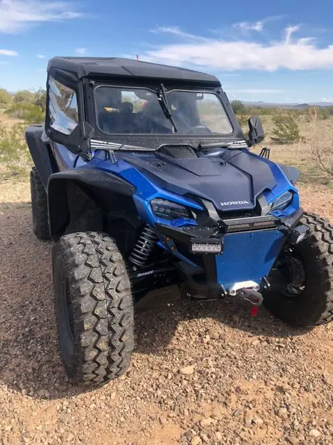

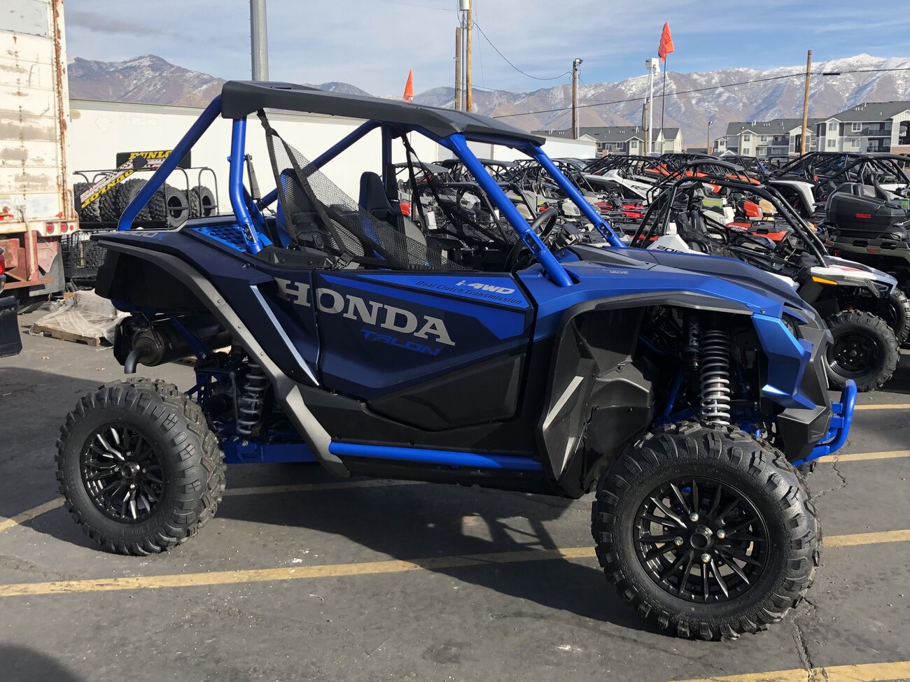

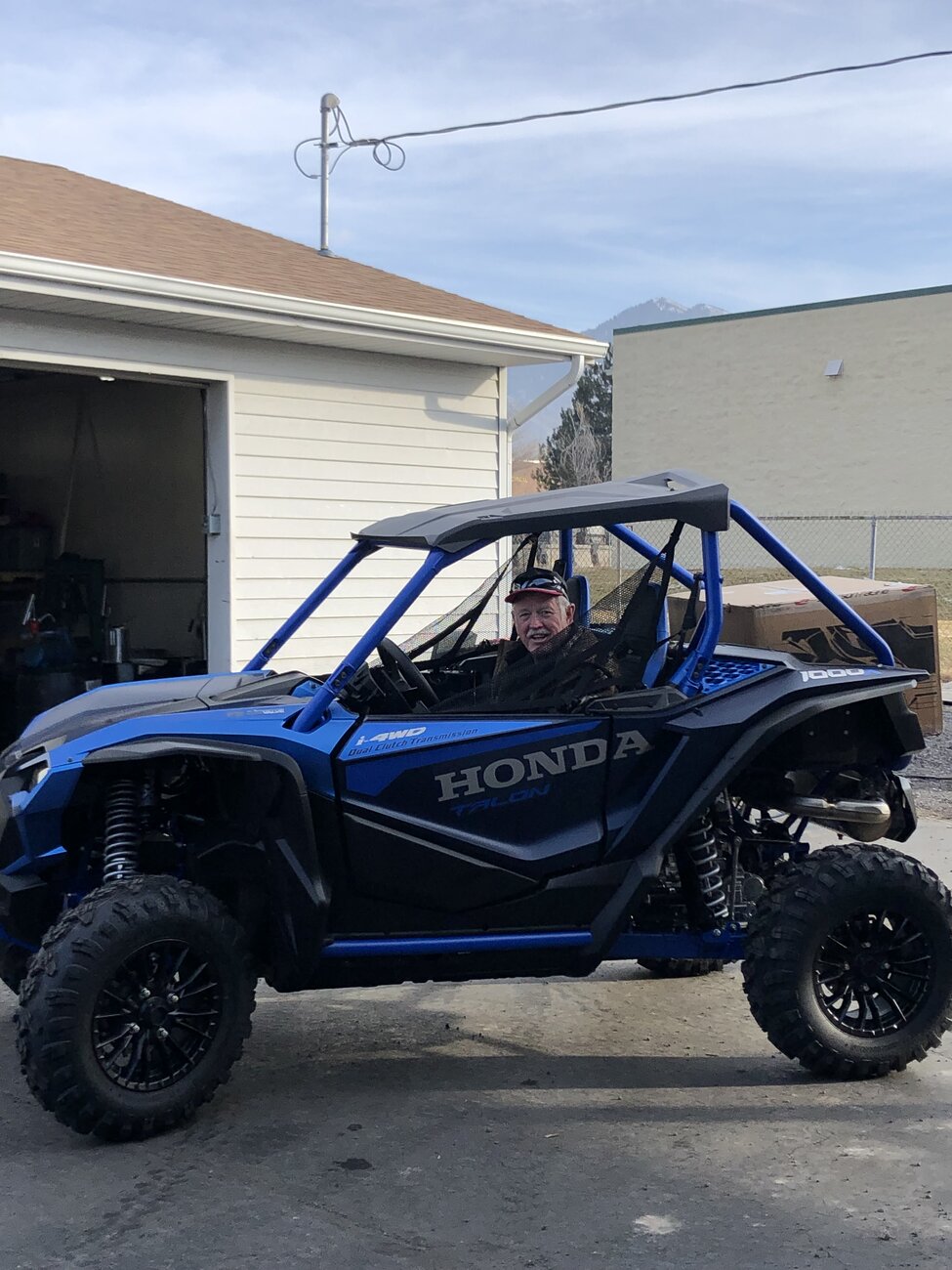

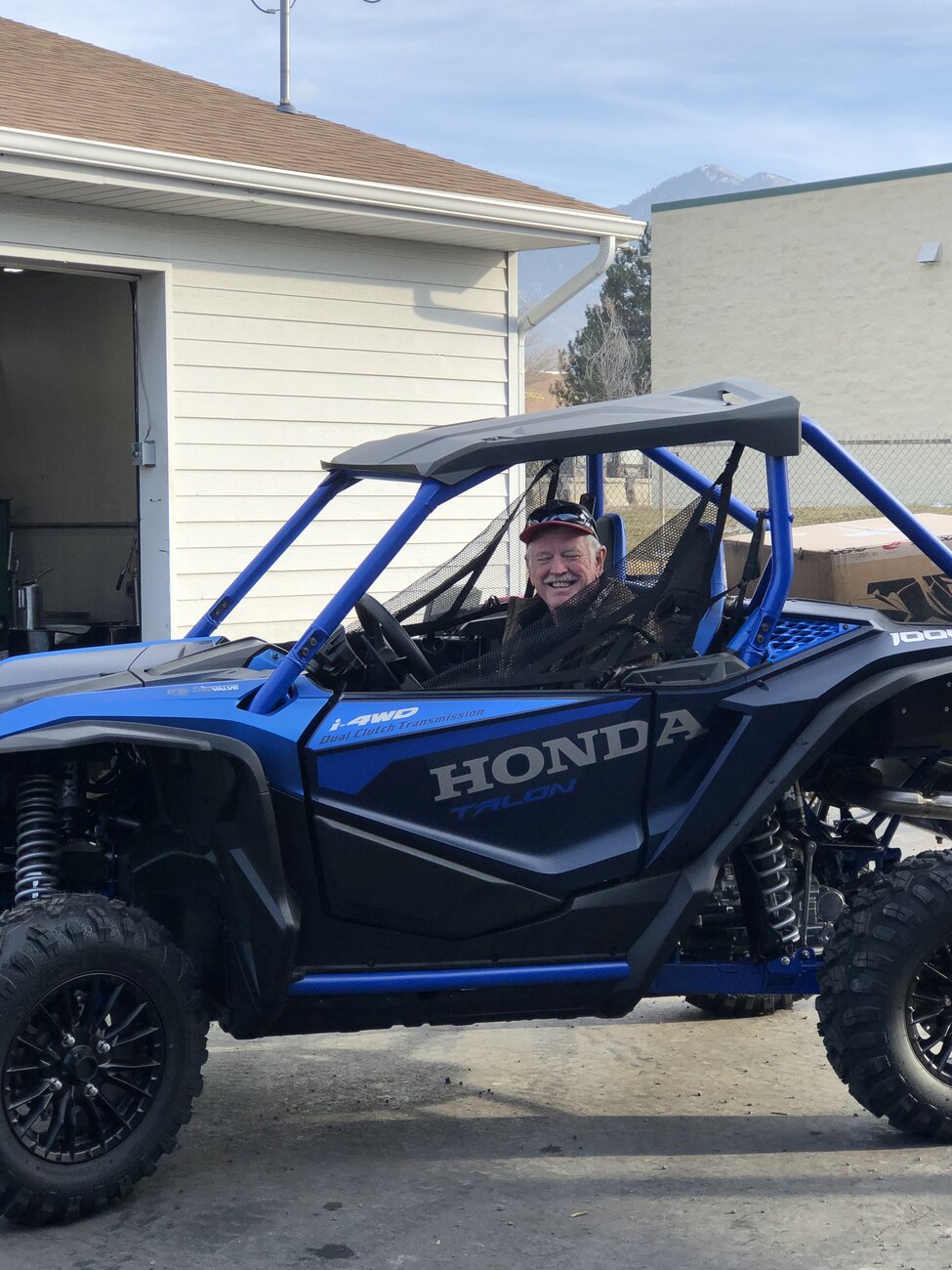

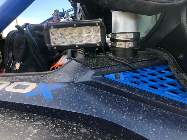

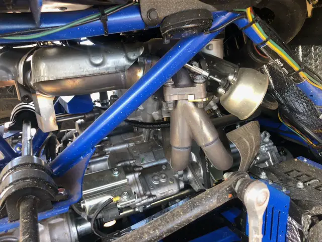

Dec 19, 2023 We finally got a Talon after 27 months waiting for mother Honda to send one to our dealer. I guess X2 FLV's aren't as popular? Anyway, he had to drive 3 hours away and trade another dealer out of it who had just landed the crate the day before.
Over the next 8 weeks my wife and I built it from A-Z. We already had accumulated all the parts and accessories that we wanted for our forever machine. At 72 I doubt I will want to build another, LOL. Sherry did the whole street legal kit from start to finish with minimal coaching, plus installed a bunch of other things, and the insulation/sound stuff. So proud of my sweetie! Below I made a list of what all we did in order we did it, more or less. Here's a group of pics - not enough I'm sure, but by now you've all seen a Talon torn apart and put back together.

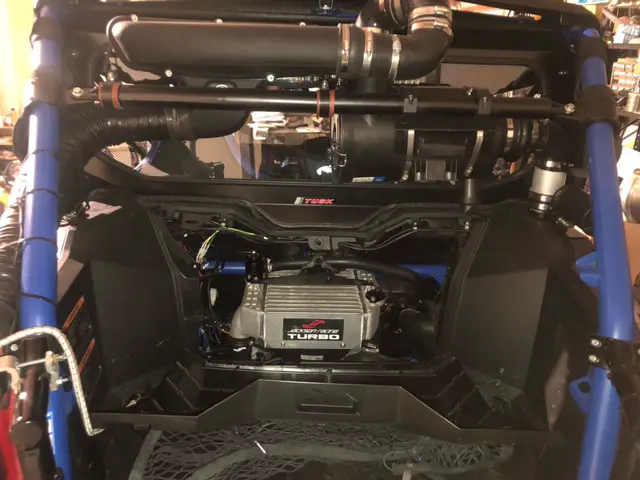

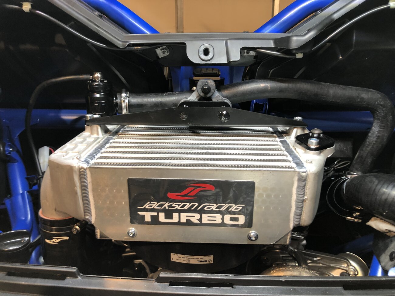

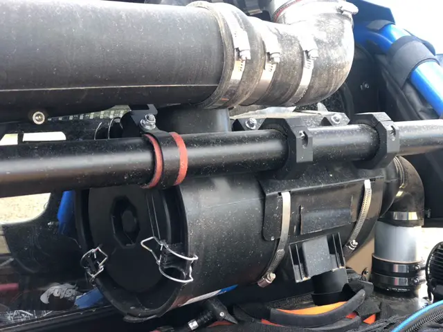

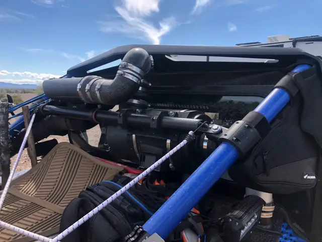

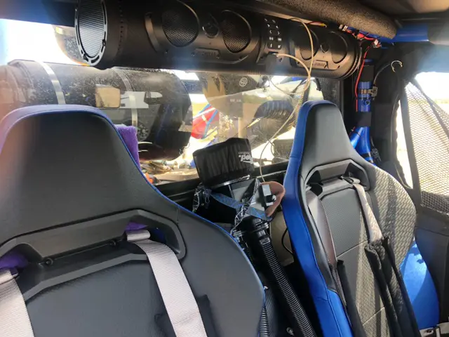

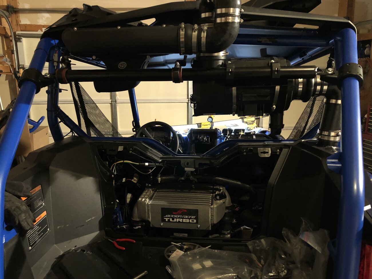

We did something unique for the air intake system. Deleted everything and did our own. Starts with a S & B Particle separator, then a Donaldson 4" in/out double element excavator filter on a tube mount just below top in the bed, a bunch of turbo hose elbows and aluminum 3" pipe, a 10-8- Dirt Sports pipe and plate and the turbo inlet hose.
WB’s 2023 X2 FLV Talon Farcles list
Torque Locker
1 1/2” Forward arched A Arms-SATV
SATV front frame gusset plate
I 4WD DELETE-Honda SxS
SATV Boxed arched Rear Radius Rods
Double Shear brackets for rear Spindles
RaceCo Trailing Arm Pivot Frame braces
Dual OEM Batteries/True AM Isolator/Metal Battery Box
Jackson Racing Turbo Kit - (Makes Blue Faster Than Red)
S & B Particle Separator
Donaldson Dual element Air Filter-4” In & Out
Delete Jackson Air Filter setup
10-80 Dirt Sports Intake Pipe
SATV Speaker bar for separator & Filter mount behind cab

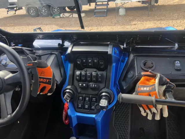

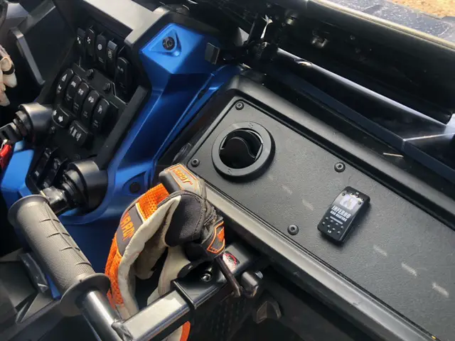

10-80 Switch plate (all full of switches)
Key on Ignition Master Switch n Relay-
controls all accessories and their Relays

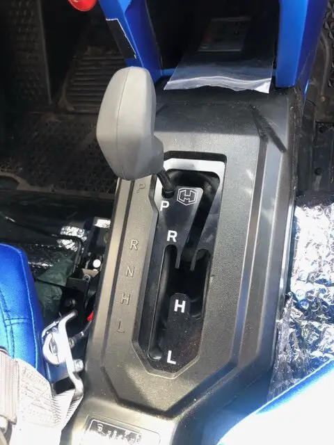

Jeep Shifter boot on Gear Selector
Aftermarket Shift Gate-Hess
Inferno Cab Heater
10-80 DirtSports - both seat risers and back 40 mm on drivers seat
Eco Gear Sound n Light Bar
Rugged forced air pumper for helmets
Bosman Front Bumper with expanded metal brush guard(Homemade)
5500 LB Badlands Winch-wide spool n synthetic rope
Dash control for winch and remote cable also
Highway Legal for Utah:
Three Mirrors, Turn n Hazard signals, Windshield Wiper n Washer,
Park Brake, DOT LT Tires( TSL Swampers 11.5 x 32-15 on all 4
corners), RB3 1” spacers on rear to almost square it up,
DOT Glass front & Rear Windshields, Honda Mud Guard Flares to cover those big tires,
Tag Bracket with Light, Horn
Method Bead Grip 15” 6+1 wheels (5 tires n wheels)
Firewall Dust Cover n Wheel well covers too (Kinnemoto)
Insulation - under seats, back wall, under tunnel cover
Dirt Road Fab bed extender w/ spare

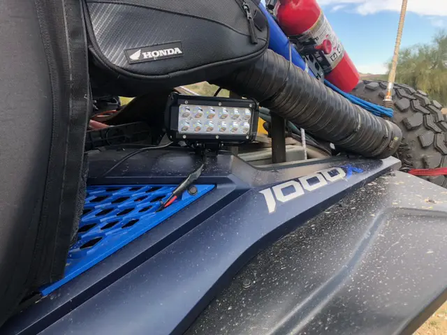

Lights: Front above winch, Ditch (Angle on Ft Bumper), Side, Back-up
Honda Moly oil (10-40) in Sub Trans after 40 easy street miles
7 various Honda Gear Bags
SATV 1/2” HMWP Skid Plate
SATV A ARM HWMP skids
Honda Trailing Arm Guards
Honda Side wrap HWMP
Skid Plates
SATV Rock Sliders
Ram Mount for Phone

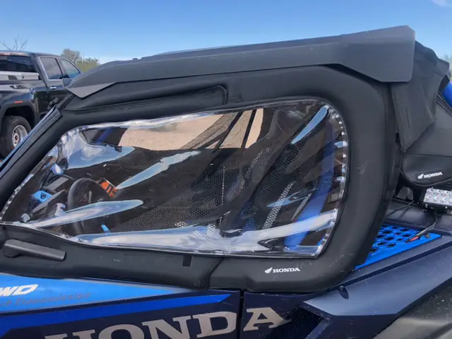

Honda Soft Upper Doors
Tool Roll Backpack in bed w/ spare parts
Welded all U-Jopint Caps

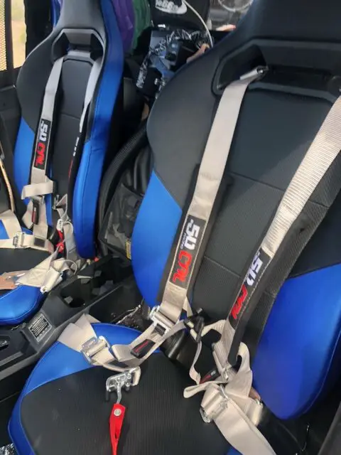

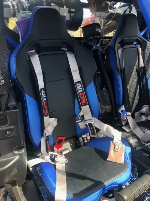

50 Caliber 2” x 5 point Harnesses
UHF Radio
Hand Grips hanging from front of Cage
First Aid Kit

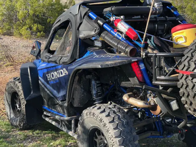

Quick Release Fire Extinguisher N Bracket(50 Cal Racing) X 2
View attachment 421844View attachment 421845View attachment 421847View attachment 421848View attachment 421849View attachment 421850View attachment 421851View attachment 421852View attachment 421853View attachment 421854View attachment 421855View attachment 421856View attachment 421857View attachment 421858View attachment 421859View attachment 421860View attachment 421861View attachment 421862View attachment 421863View attachment 421864View attachment 421865View attachment 421866View attachment 421867View attachment 421868View attachment 421869View attachment 421870View attachment 421871View attachment 421872View attachment 421873View attachment 421874View attachment 421875View attachment 421876View attachment 421877

Awesome job! Now get some suspension seats in that machine. One of the best upgrades I did.

What brand/model did you go with? Thanx.
WB
I went with Simpson pro sport seat. It's a nice comfortable seat, but the bottom pad is not waterproof. It's removable, but the foam will hold water. I ended up taking out the foam and wrapping it in plastic. I also added Heater pads at the same time. If I did it again, I'd probably go prp. I'll let others chime in on preferences. It is night and day difference compared to stock.

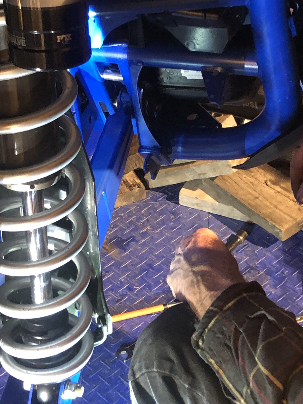

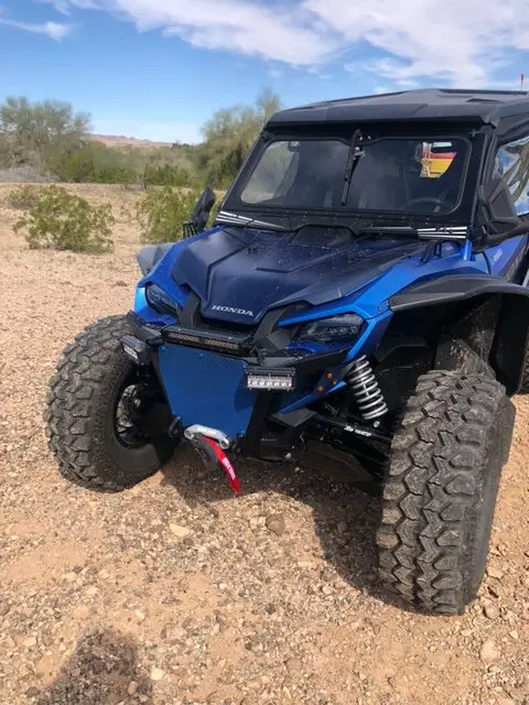

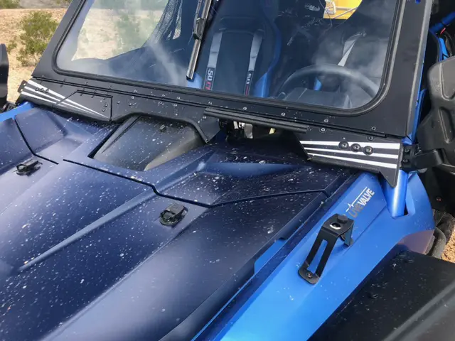

Not technically today, but I put new shoes on the Talon…Tensor Regulator 2 32” and have the Baja Designs Pro light kit to install as soon as I have the time.

I rode in a Talon for 3 days at the Sand Hollow rally, it had PRP seats. By the end of those 3 days I'd had just about enough of climbing over that outside bolster - it has a stiff/hard structural support. If I could order them without that on the out side, I would.
