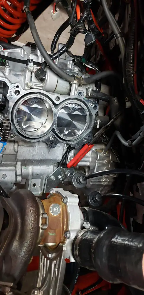

If you have any questions or need any part numbers don't hesitate to ask!View attachment 272194
I can’t imagine breaking pistons in less than 100 miles. Do you drive it like you stole it? I wonder if they set up the bore with the correct clearance? I turbo’d mine about 500 miles ago and haven’t had any noticeable issues. Of course I can’t see inside the engine to be sure. Do you always let it warn up to at least 2 bars before riding? They say that’s crucial with a turbo’d car. What brand and compression ratio of forged pistons are available? I’m curious what pistons will be the best when someone makes a tune to get more out of the Jackson kit as well? I know you prolly don’t have Any wear on the rod bearings, but do they have replaceable upper and lower rod bearings?
JE, CP and MCB Performance all make and sell forged pistons for the Talon in a bunch of different compression ratios to meet everyone's needs turbo'd or N/A.
Rods have a floating wrist pin on the piston end and non roller style bearings on the crank end just like automotive style rods. Crank doesn't have to be pressed apart to change the rods or bearings.
Cast pistons were never meant for turbo applications and that is probably one of the deciding factors with the amount of boost Jackson was able to build into their kit. Just enough more power to make the price seem worth it to the consumer, but not enough to break anything in the motor so it could be a dealer installed option that didn't void the warranty.
Your pistons may not be cracked right now but I can assure you that at some point in the not so distant future one or both will. Replace them yourself with forged pistons from any of the above companies and your motor will be much happier for a long time.
I want to answer your questions with clarity. We ride the dunes 32"paddle tires take some power but drive it like I stole it isn't what I do at all. Im very picky about my talon everyone that knows me tells me I'm beyond anal. It doesn't move unless its at operating temp. The dunes we ride takes about 15 minutes to get to from camp and the speed limit is 25 mph they watch everyones speed very close so it never gets ran hard cold. As for the piston to wall clearance It was within specks. I went with CP 10.5 pistons. Yes the rods have 2 bearing halves. Also want you to know my motor made NO odd piston noise. If I was you I would at least pull the pan and look. I found the broken skirt inside the oil pump pick up tube this could have starved the motor of oil. Take the bolts out of the pan tap on the side of the pan with a plastic mallet to break it loose from the gasket. Mine didn't tear maybe yours won't either. I will guarantee your piston is at least cracked.

Mulino
Saying that your sure mine are cracked is a guess at best. That’s odd that no one else has reported this problem. I know forged pistons are the way to go, and if Honda knew that Jackson was making a turbo kit, they would have upgraded to forged pistons. Casting have problems all the time when cooling. I wonder if you just got a bad casted piston?
Look at the page 5 Nauti 1826 he had a piston failure also. Just saying it wouldn't hurt for you to look it might save you a lot of work later.

Go with the 10.5 compression Pistons! Cp won't recommend it because its not there turbo ring location I understand that the 9.5 piston has the ring package moved down. My thoughts are this a forged piston is way stronger then a .060 thick cast piston skirt all day ling! The CP pistons I bought was thicker by .020 in the skirt area! If your patient you can order the pistons with coated skirts which I recommend and you can get a ceramic coating done on the top of the piston I recommend that as well. I'm going to try the off the shelf pistons I will let you know How it goes.
The coatings are all just bling except for the skirt
