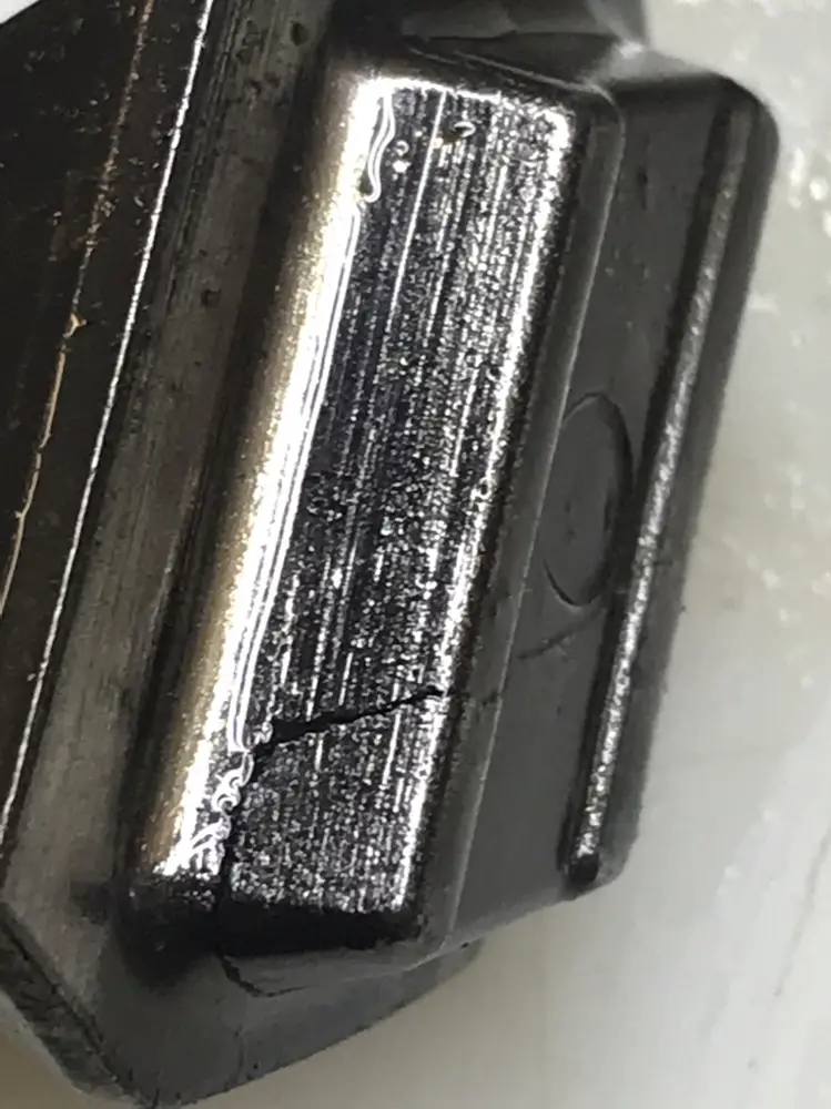

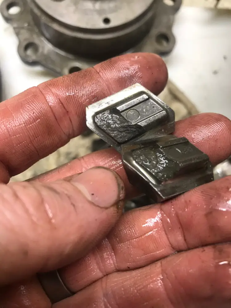

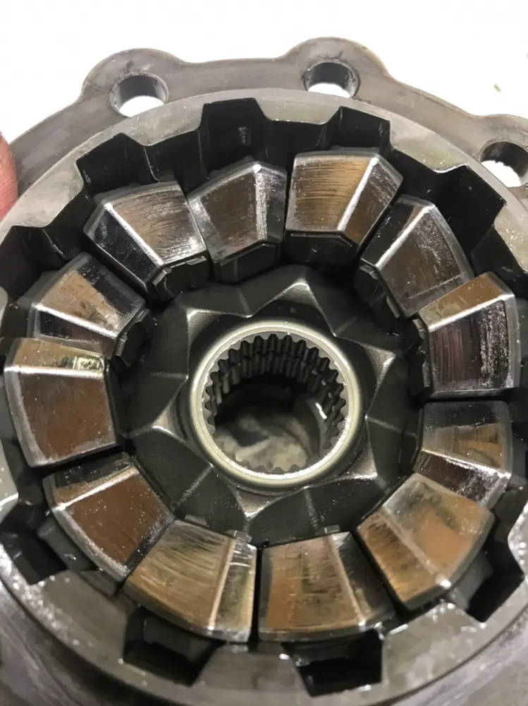

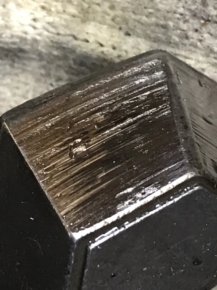

I’m not sure if that’s what they are using on the Talon or i4wd but I can tell you that that type of differential is in the pioneer 1000 deluxe.
Not real sure about its durability yet. I have already wasted one of them. It’s possible that I had a defective unit but if I break a second one then I have probably found the limit of its capability.
I’ll try to find a picture of it
39,129
Aae950cd17ab32bf2e1ec05f68fc7d22
B35991365aefbf648abc94c95e91b323
1825508aa8043aa3dcb5b62a575222bb
There is a lot of friction between these parts. It seems like a heavy duty oil would maybe help extend the life. The picture below is a close-up shot of the scratches that came from the two friction surfaces.
